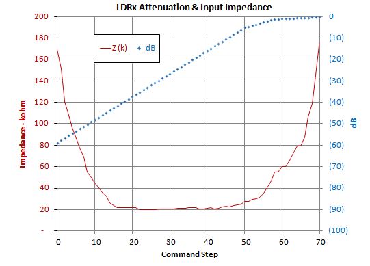

This is what the new impedance curve looks like superimposed with the attenuation curve which hasn't changed. The bathtub shaped impedance is caused by the Z rise as volume approaches zero or max. These rises are need to to achieve the full attenuation range. Most listening is done at the bottom of the bathtub so to speak where the impedance hovers around 20k. This is where the raised impedance floor will have the most positive impact.

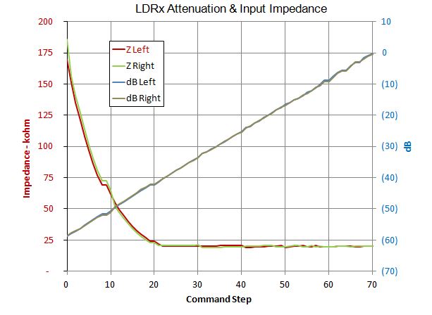

Here's an updated example of the the new HiZ attenuation and input impedance curves after further refinement of the test data processing logic/software. Managed to get rid of the impedance rise near max volume so no more bathtub shape. By the time the unit is in normal listening levels the impedance is leveled out around 20k.
The squiggles in the lines are caused by quantization effects. The design employs an 8 bit voltage divider so the full range of each LDR is captured via testing using 256 samples and we end up not using the bottom first 10. The quantization of the audio taper curve is small enough that you can't hear it. A few tenths of a dB at most. One consequence of this is I had to give up on bending the attenutation curve towards full volume - just ran out of resolution. Could fix that by going with a higher resolution 10 or 12 bit voltage divider on the next hardware iteration but I think that would be overkill.
After doing some extensive listening to this "HiZ" upgrade the overall improvement in fullness, dynamics and overall musicality and involvement is undeniable. And the LDR openess, clarity and resolution are still there in spades just as before - only better! I think this is going to raise the bar on passive preamps and give actives a real run for their money.
