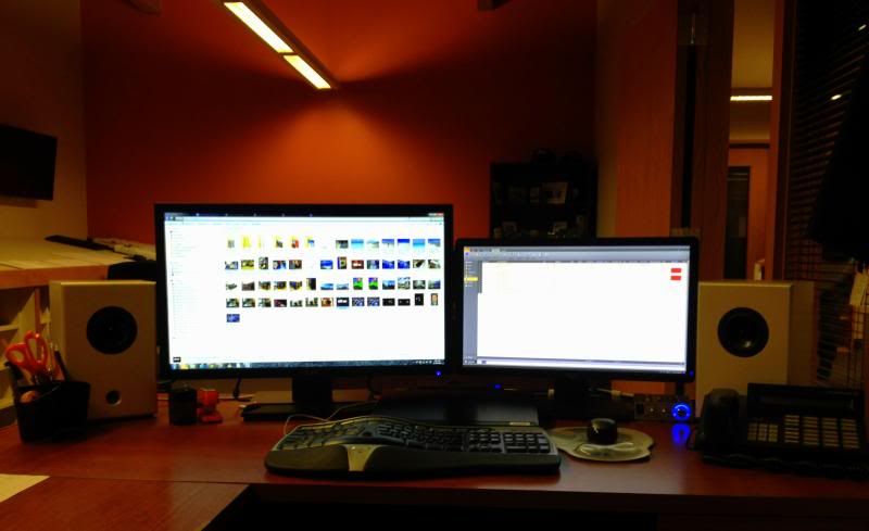

Danny these look awesome! I've got some Dayton RS100's in small ported boxes running full range on a little Lepai T-Amp from PE on my desk now:
A set of yours with a woofer on the side to fill in the low end would be a great upgrade. Consider me interested :D
