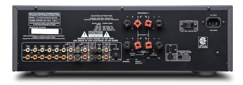

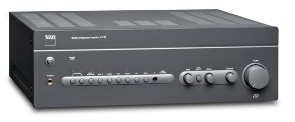

Not very little but this is what I'm currently using to drive my desktop speakers (N1X) and subwoofer. I will probably continue to use it seeing as it is a two channel amp and the office is the only two channel setup I have. All my other systems are multichannel HT (5.1 & 7.1).
NAD C372
OK, at 150wpc it would be just a tad overkill  :o but it's way too good an amp not to use
