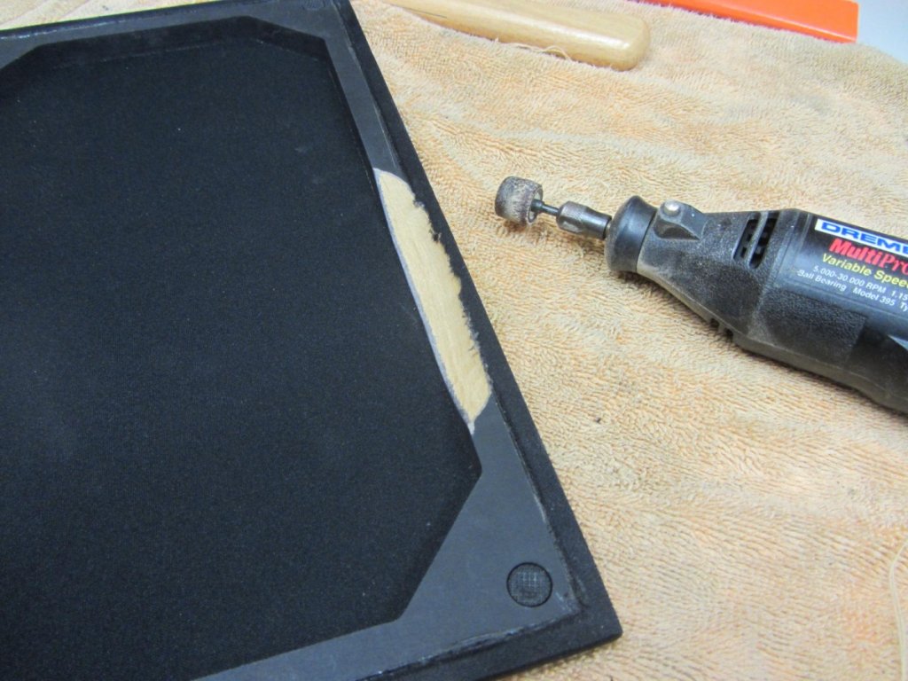

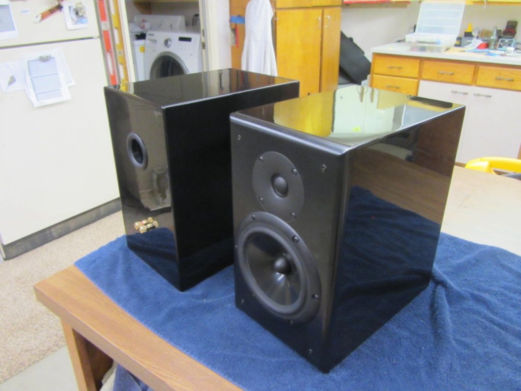

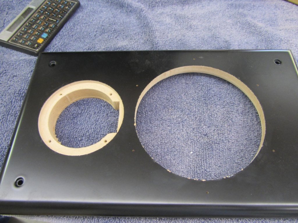

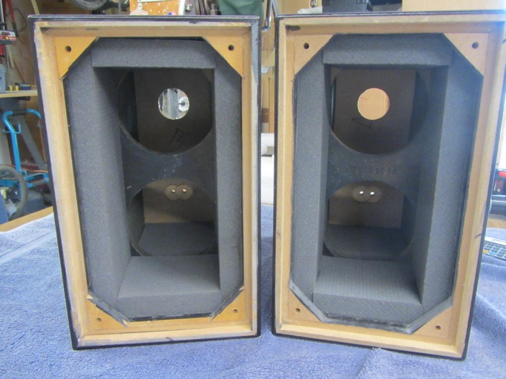

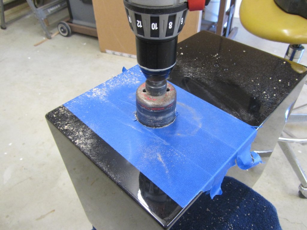

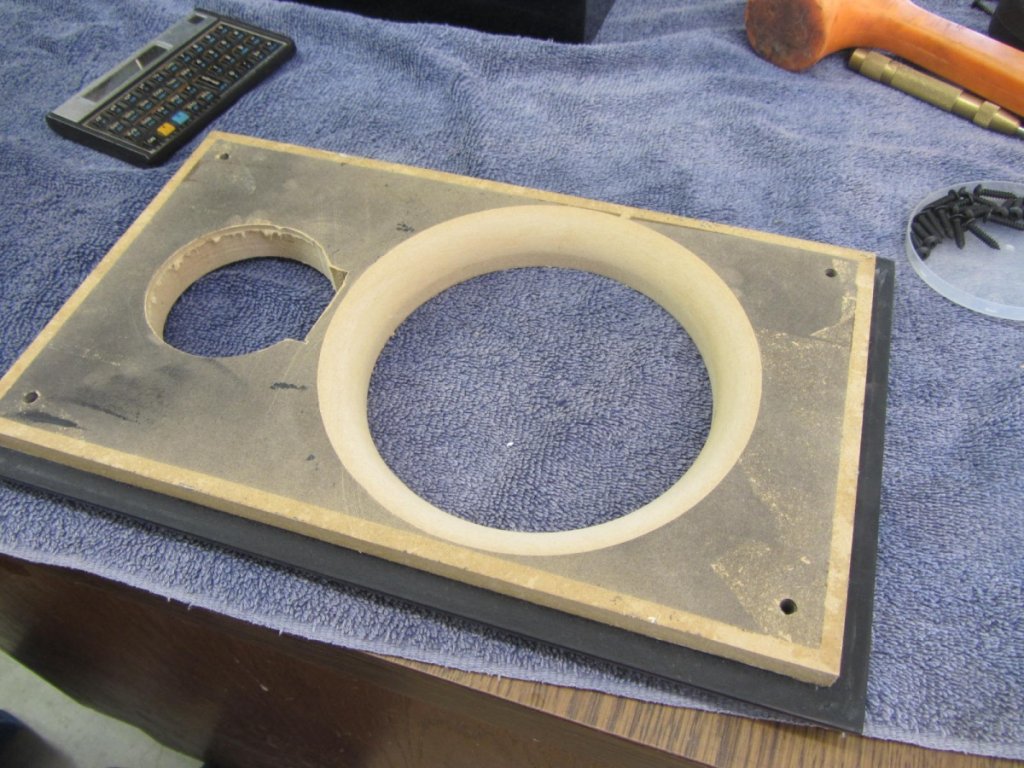

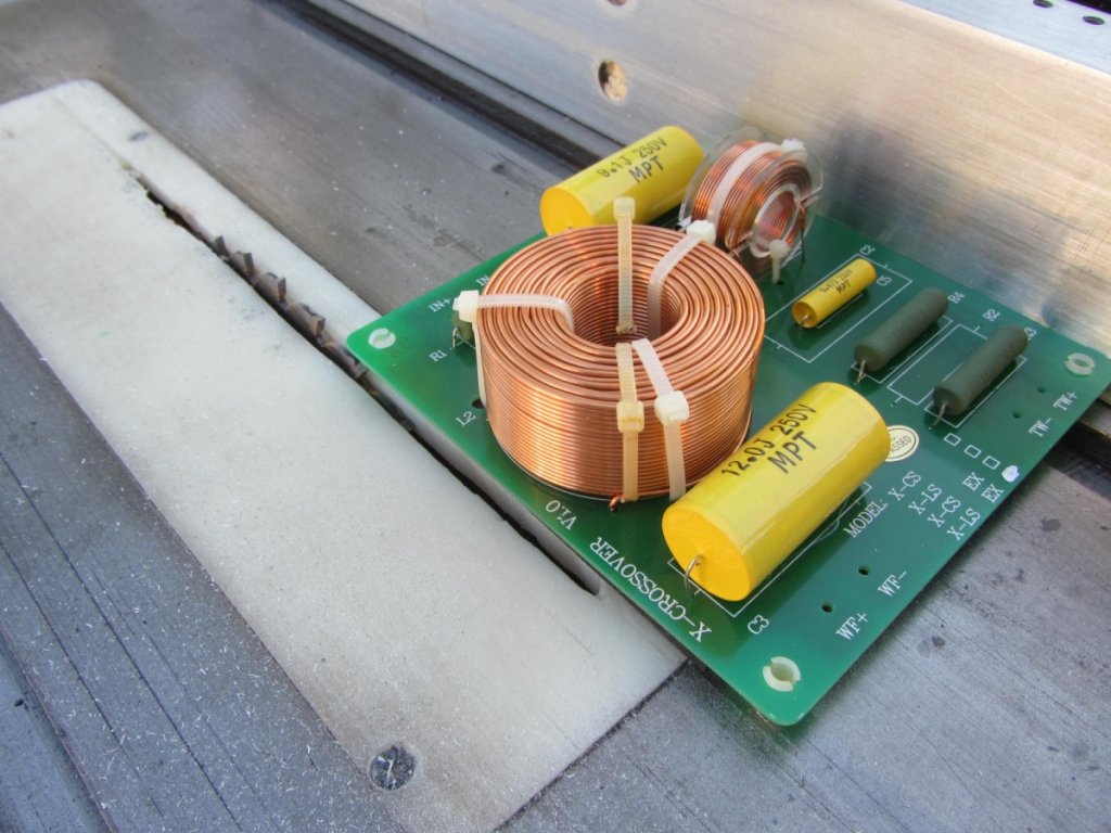

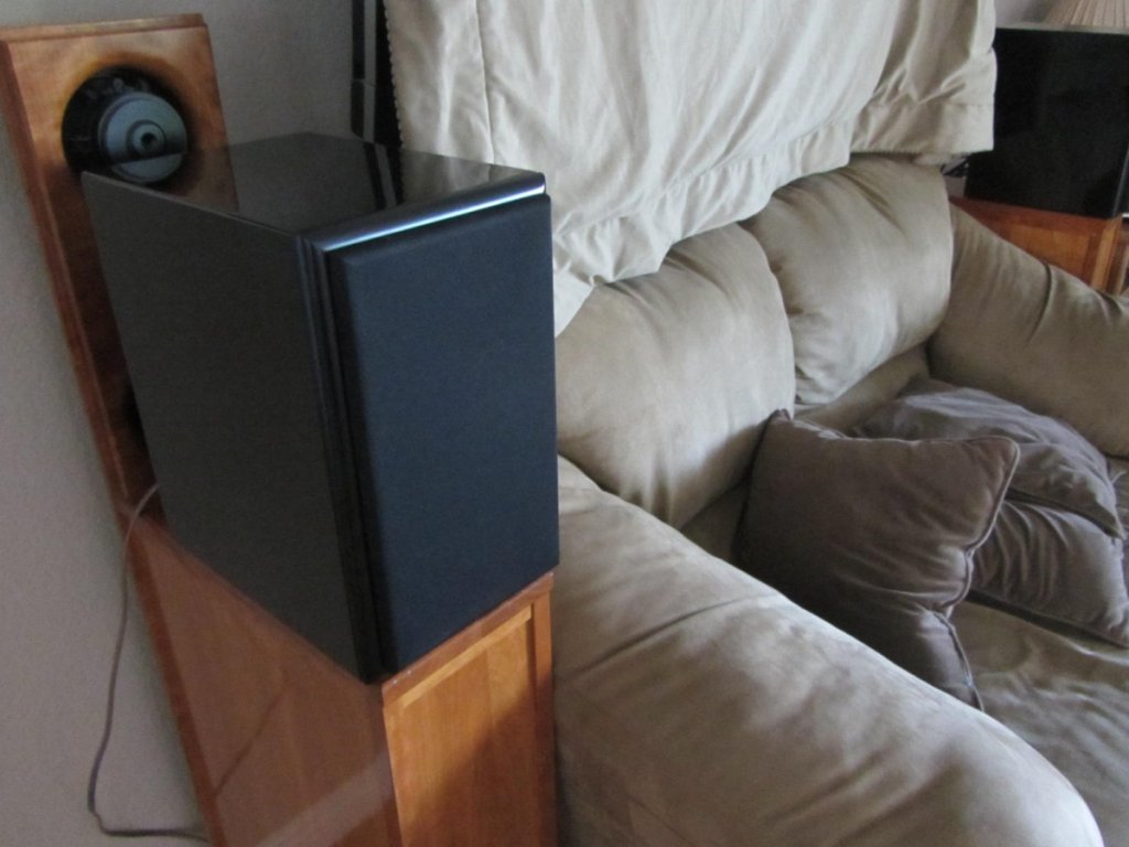

Could not pass up the amazing deal on this kit, and decided on the X-LS Encore for my brother.
Cheated on the cabinet build, PE does a great job for $200.00.

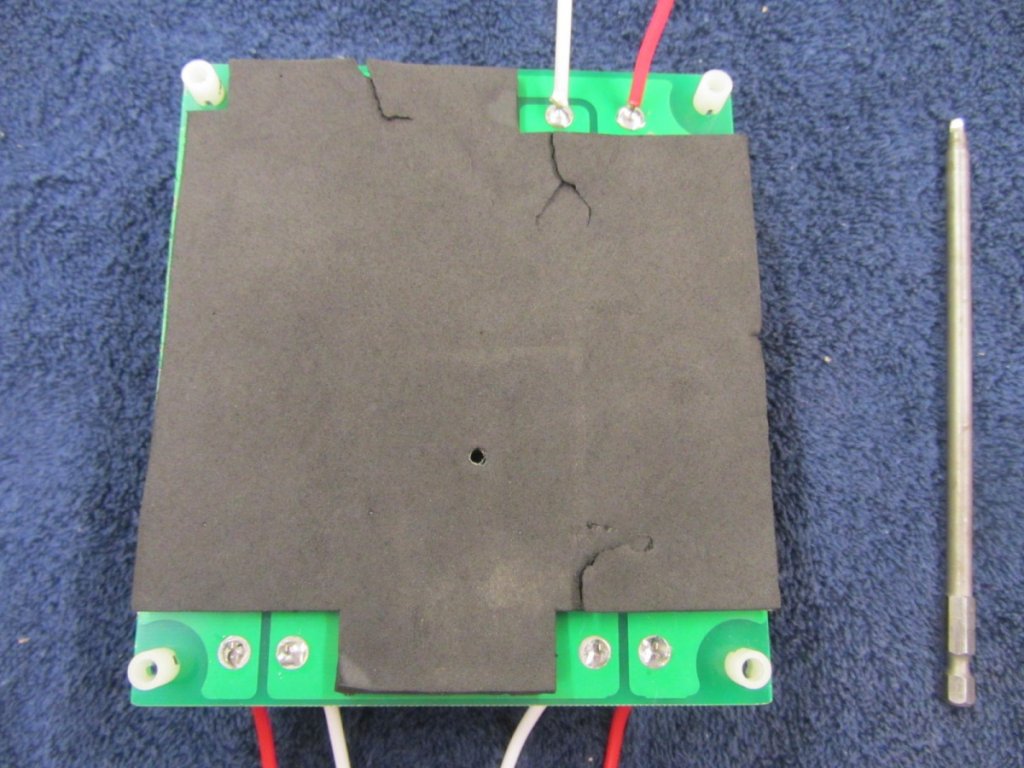

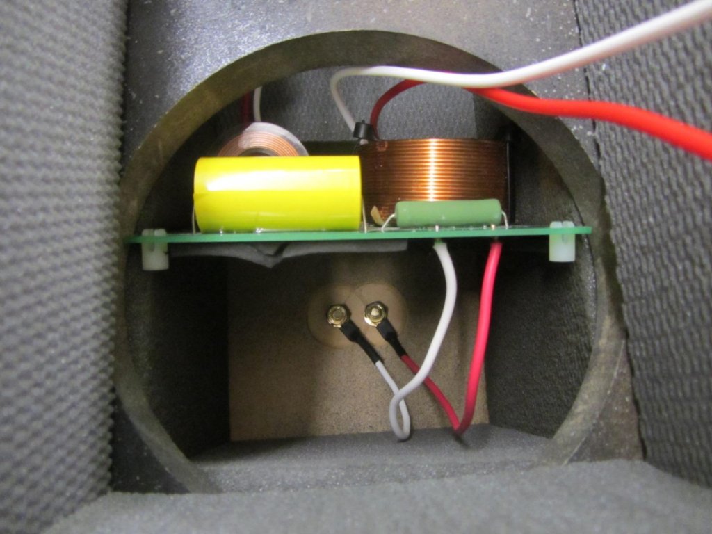

Best place for X-over is behind woofers, had to carve out a recess for binding post hardware

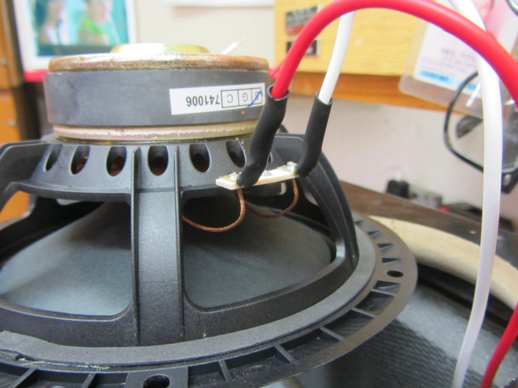

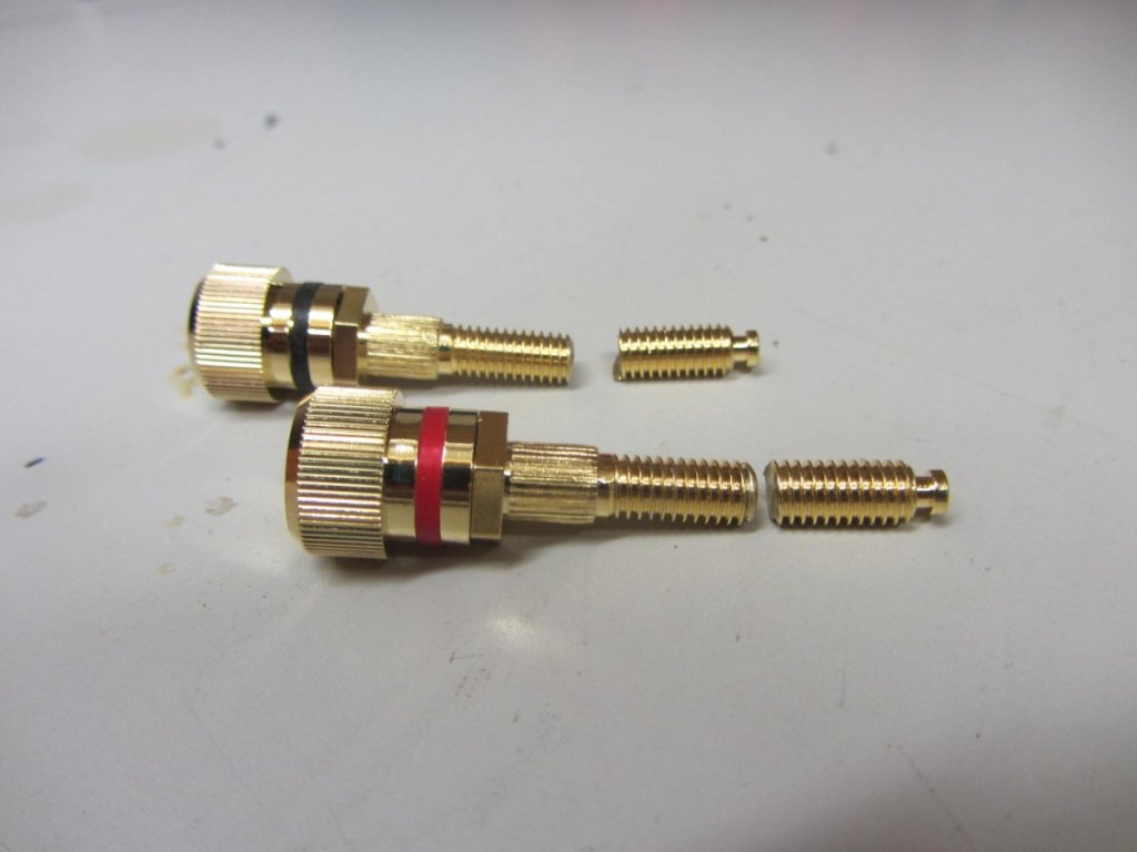

Had to cut down binding post.

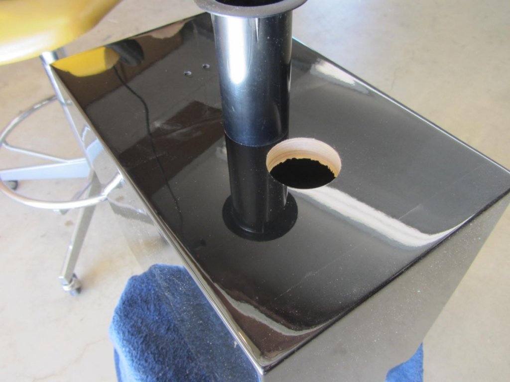

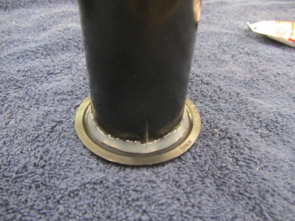

A little silicone to hold port in place

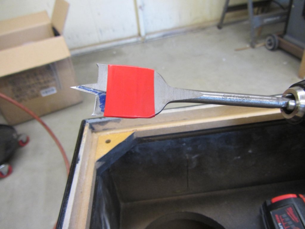

3/4 inch round over.
No-Rezzed

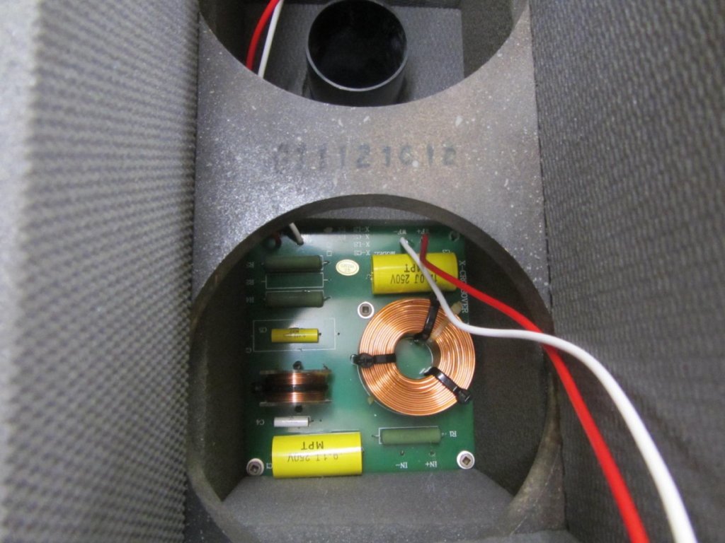

Trimmed a little off X-over boards to make the fit

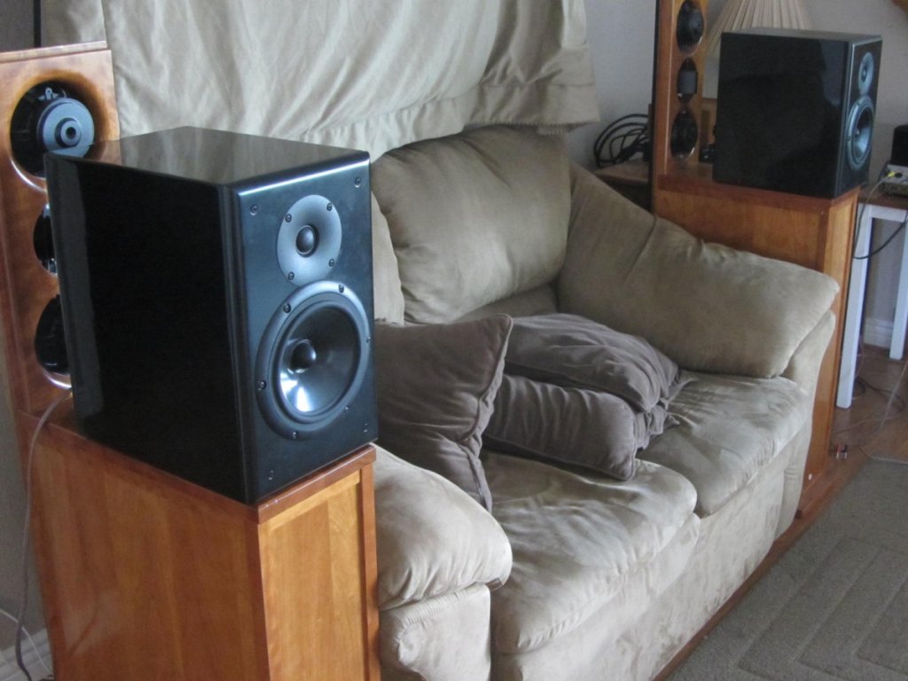

OB7's make great speaker stands
Had to remove some material, to fit grills over woofers
I will post impressions later.
Neil

« Reply #12 on: 4 Nov 2013, 01:35 am »
Neil
Looking great.  :thumb:
Noticed the trusty HP calculator.
NeilT
Re: Help me decide what speaker to build / X-LS Encore build
« Reply #13 on: 4 Nov 2013, 01:44 am »
Neil
I wondering if anybody would notice that, HP15C.
I have been using it for about 30 years.
« Reply #14 on: 4 Nov 2013, 02:35 am »
Nice job Neil  :thumb:
Those PE cabinets  make for a nice alternative for  folks not wanting to build from scratch
-jay

« Reply #15 on: 4 Nov 2013, 04:08 am »
Neil,
Looks nice. Rather expensive speaker stands though ...  :)
Mike

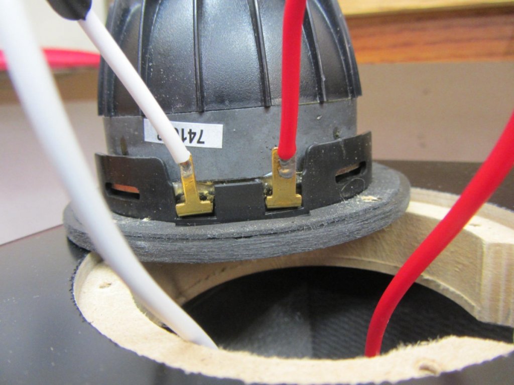

Danny Richie
« Reply #16 on: 4 Nov 2013, 03:54 pm »
I can't argue with any of that feedback posted so far. All is pretty spot on.

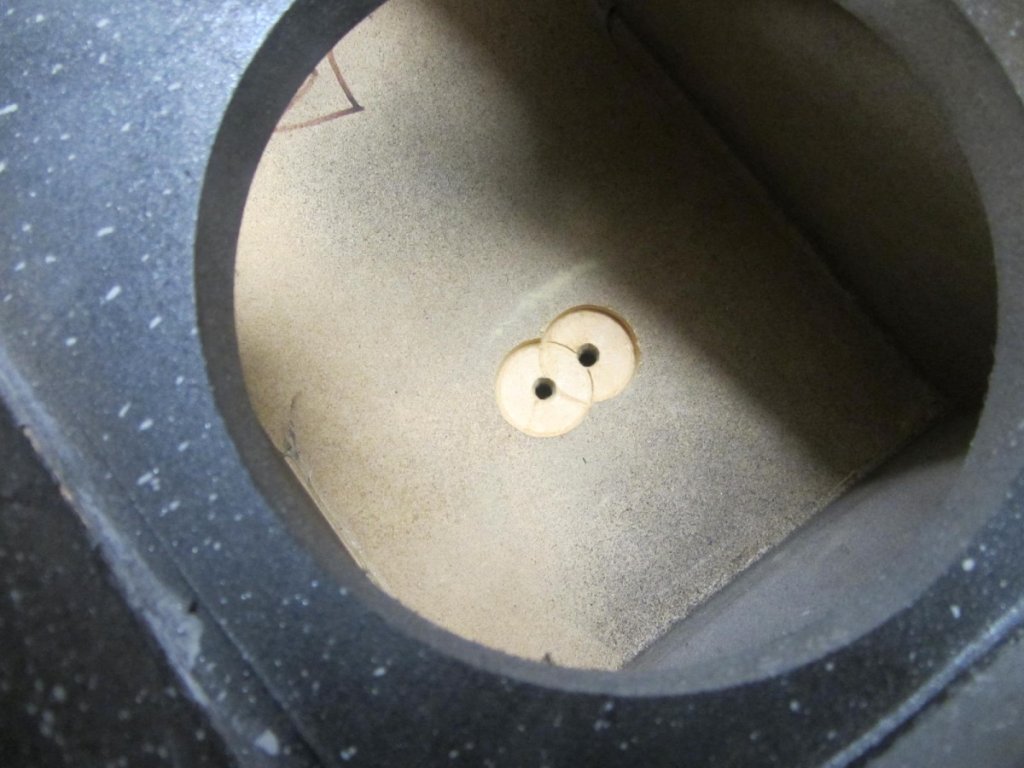

A few hints though for you guys using the PE boxes. See this thread: http://www.audiocircle.com/index.php?topic=54352.msg485002#msg485002
If you failed to remove the center brace then you might want to rap some insulation around it to minimize the reflective area.
Also note that the holes in the driver terminals are not for poking the wiring through. This makes a minimum contact area with the wire and makes un-soldering (if needed) a nightmare.
Tin the wire with solder. Tin the terminal. Solder the two together making as much surface area contact as possible. Then heat shrink.

« Reply #17 on: 4 Nov 2013, 11:15 pm »
"Then heat shrink."
What is the proper method to 'shrink' the black plastic insulator onto the bare wire connections?
Regarding the Parts-Express enclosures: "The brace down the middle of the box puts
quite a bit of reflective surface area right behind the woofer. This really must be removed.
This applies to a ported X-ls build only, right? ...not the sealed verion?
Danny Richie
« Reply #18 on: 4 Nov 2013, 11:27 pm »
"Then heat shrink."
I use a heat gun.
Sealed or not it still puts a reflective surface behind the woofer. The shorter wavelengths the woofer plays (in the upper harmonics) can propagate in the cabinet and reflect off of the internals.
