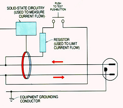

Re: What to do: isolate or regenerate
« Reply #87 on: 22 Jan 2014, 06:19 pm »
If the secondary is floating above ground there is no reference to ground. A GFCI would be worthless.
A GFCI does not require a Safety Ground (EGC) reference! The GFCI only examines the current in the Send and Return wires, if these are not equal (5ma) then the unit trips.
As a matter of fact, GFCI's are often used in older homes that only have two wire circuits (no Safety Ground wire).  In this case there is some fine print.

« Reply #88 on: 22 Jan 2014, 08:14 pm »
Hi Speedskater,
True an equipment ground is not needed for a  GFCI to operate. True NEC allows an old two wire receptacle to be replaced with a GFI receptacle.
 How does the GFI trip open in the event of around a 5 ma current  flow of current to an earth grounded object? Answer because the AC power system is a grounded system. One conductor of the 2 wire branch circuit is connected the GFI receptacle is the Hot Ungrounded Conductor and the other conductor connected to the neutral side of the GFI receptacle is the neutral, the Grounded Conductor. Though an equipment grounding conductor is not involved, the grounded system neutral is. The grounded neutral is the reference needed for the GFI receptacle to sense the imbalance.
 In the case of a 120V floating AC power system  there is not any reference to ground what so ever.
Don't take my word for it. If you have an isolation transformer to experiment with just float the secondary and connect the two  ungrounded 120V leads up to a GFI receptacle. Simulate a human body, with a test lead from either contact  of the receptacle to ground. The GFI will not trip open.
If you read NEC 517 - VII.  Isolated Power Systems.
 517.160  (B) (1) you will find Code requires a "Line  Isolation Monitor" to be connected to the secondary winding of the ISO Xfmr. In the case where the Isolated Power System is used in a hospital, example a CATH Lab, the monitor sounds an audible alarm, lights a warning light, and a meter shows the amount of leakage current in mA warning the Doctor and staff a 5mA current leakage to ground has occurred.

« Reply #89 on: 23 Jan 2014, 01:15 am »
The GFCI does not need or use a external reference.  It is only aware of the current in the Send and Return wires. As long as these two currents are about equal the GFCI is happy.  In any case, current is not interested in going to the ground or into the dirt,  it is only interested in getting back ti it's source which is that big power company transformer outside.
Note  the scope of Article 517:
517.1 Scope. The provisions of this article shall apply to
electrical construction and installation criteria in health care
facilities that provide services to human beings.
Article 517 building follow a very different set of rules and wiring practices than do residential building.

« Reply #90 on: 23 Jan 2014, 02:59 am »
 In this case Earth has nothing to do with the operation of the GFCI. The grounded service neutral does on the other hand. You speak of an imbalance on the send and return wires. Explain how an imbalance can exist without a reference for fault current to flow to create the imbalance.
I actually did a bench test after my post responding to yours. I connected a GFI receptacle to the floating ungrounded leads of the secondary of a 120V isolation transformer.
First test.
 I pushed the test button. The GFI did not trip open.
Edit 1/23/14. The result of that test has me scratching my head.
***EDIT 2/3/14. I should of double check this part of the bench test before posting. Reran the test and the test button on the GFI receptacle does trip the device open as it should. My only defense I was in a hurry, leaving town, and should of double checked before posting. MY BAD!
Second test.
 I temporarily connected a  jumper wire  from one  contact of the GFI receptacle to the equipment ground of the grounded 120V receptacle I plugged the primary of ISO xfmr into. Again the GFI did not trip open.
EDIT 1/23/14. For this test I did not push the test button.
Third test.
I then moved the jumper to the other contact of the GFI receptacle to the equipment ground of the  grounded receptacle. Again the GFI did not trip open.
Why? Because there is not a reference , completed circuit, for a current flow. There is not a difference of potential from the floating secondary of the ISO to the equipment ground of the grounded wall receptacle that is tied to the main service neutral of the AC Grounded Power System. Again mother earth has nothing  to do with it.
Now if the GFI receptacle was on the outside of a house and it was connected to a grounded 2 wire branch circuit, (hot and neutral conductor), and say a faulty device was plugged into the GFI and a person was holding the faulty device standing in wet grass in his bare feet the imbalance you speak of would then exist.  First a difference of potential will exist from the faulty device and mother earth. Why? Because the service neutral conductor is connected to earth through the grounding electrode system.
We have a completed circuit for current to flow.  From the metal of the faulty device >  through the body of the person out through his feet >  through the earth to the service neutral conductor  of the power source. Hopefully the GFI receptacle will trip open if more than 5mA to 7mA of current flows through the body of the person.

Look at it this way, a typical home has a single phase 240V (120/120) service. If the GFCI circuit is connected to the 'A' leg/pole (aka phase) and it's Hot 120V wire leaks to the 'B' leg's Hot 120V. There will be leakage current (after all these two Hots are 240 Volts apart) so the GFCI will trip.
jea48
  • Posts: 307
« Reply #92 on: 23 Jan 2014, 05:04 pm »
You do know a GFCI does not protect human life from electrical shock if the person's body is placed between a Line to Line situation.  In other words, if a person grabs onto one line with one hand and the other line with the other hand of a GFCI protected circuit the person will receive a lethal electrical shock.
Please remember this thread got sidetracked when a member said a GFCI would provide protection on a floating AC 120V separately derived power system. My attempt has been to inform readers it just ain't so.
Floating the secondary of an ISO power transformer could prove to be dangerous in a non-qualified non-professional setting. Especially if a Line Isolation Monitor is not used. Again a GFI receptacle will not add any protection what so ever.  It will just be a duplex receptacle connected to the 2 hot legs of the 120V Isolated Power System.
Jim

However, a GFCI doesn't give you a license to be careless. Severe electric shock or death can occur if you touch the hot and neutral conductors in a GFCI-protected circuit at the same time because the current transformer within the protection device won't sense an imbalance between the departing and returning current and the switching contacts will remain closed.
http://ecmweb.com/content/how-gfcis-work
The GFCI will not protect you from line contact hazards (i.e. a person holding two "hot" wires, a hot and a neutral wire in each hand, or contacting an overhead power line).
https://www.osha.gov/SLTC/etools/construction/electrical_incidents/gfci.html

My original statement was:
Just how is that statement incorrect?
from your first link:
 Don't let the name confuse you — these devices will operate on a circuit that does not have an equipment-grounding conductor.

Thank you Occam for the drawing.
To Jea48
As for the service neutral conductor / earth /equipment enclosure/ equipment ground be bonded at only one location at the main electrical service of the building we do not know that it is not.
Please refer to the photo from the OP, it clearly shows the neutral conductor being bonded to discoloured copper cables, which eventually end up on the metal conduits. The neutral in then bonded to earth, not in a manner that's normal, surely.
Another point of using GFCI/RCD is that if the earth conductor is broken on say a toaster or an appliance outside, if someone touches the live portion of the appliance while say touching a tap/faucet, the GFCI will trip.
In your first test, if you wired the device correctly, the GFCI should have tripped. If it didn't, it's great you found a dud. The RCD is supposed to trip since it artificially creates an imbalance of current around the CT, rather than through it.
