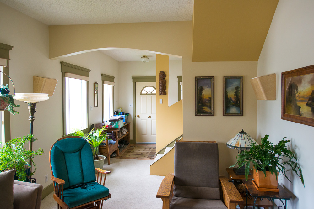

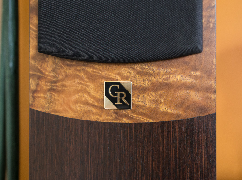

My speakers are finally done.
Here's some pics to show them off  :D
The main speakers are camphor burl and wenge veneers, and the surrounds are curly sycamore.
Unfortunately,  my sub has blown a fuse which I have had to mail order. The system sounds awesome anyways !
Hmmm...maybe I need to build a new sub now ?   :roll:

Those are really sharp. Love that burl against the dark wenge. Did you cut a separate baffle then glue it to the front of the cabinet?

Mike... I cut both veneers at the same time and taped them together.  The baffle is all one piece...like normal.

So...where did you get the cool GR logos?
