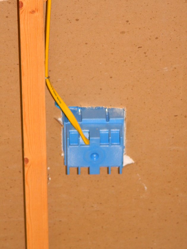

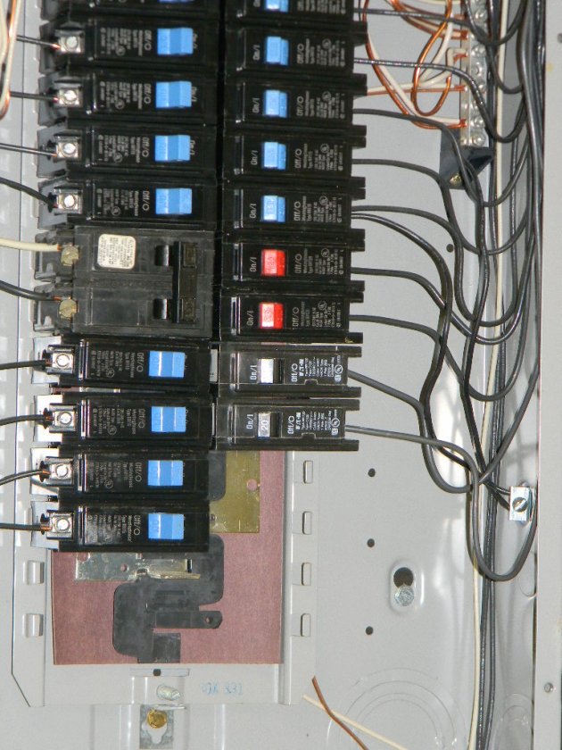

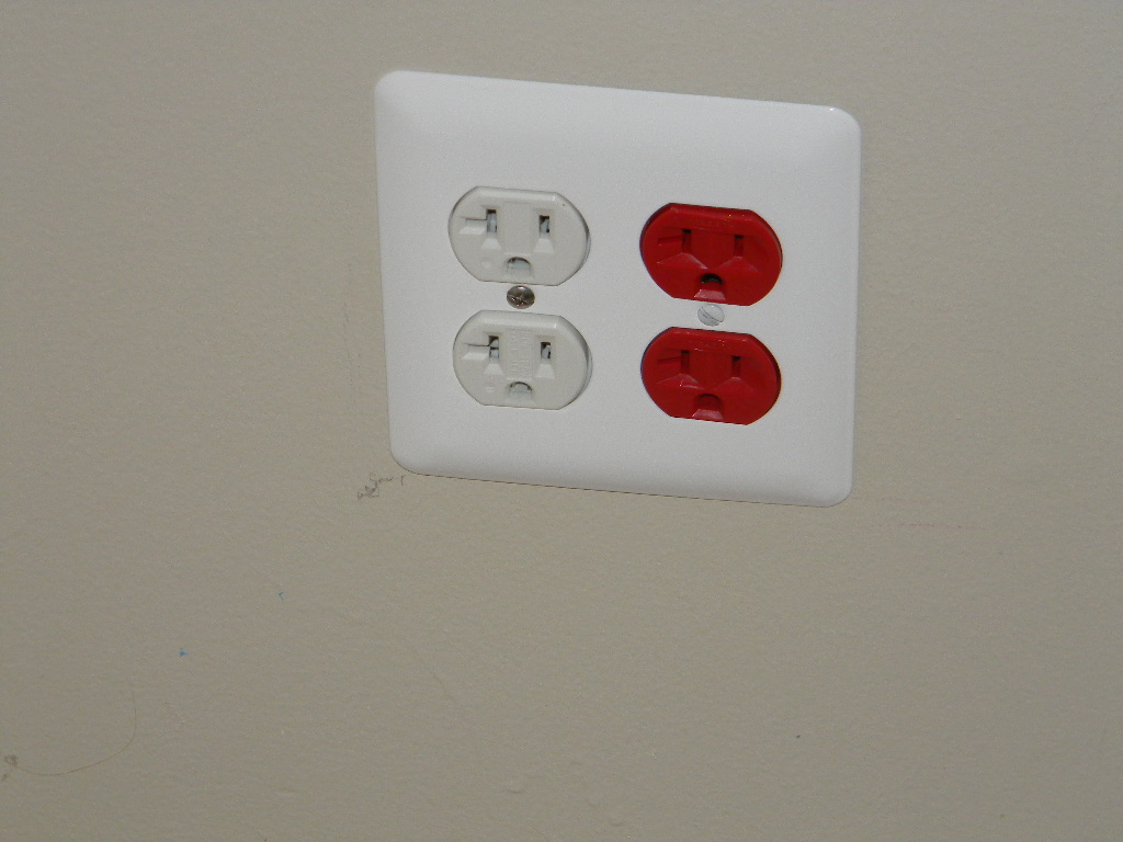

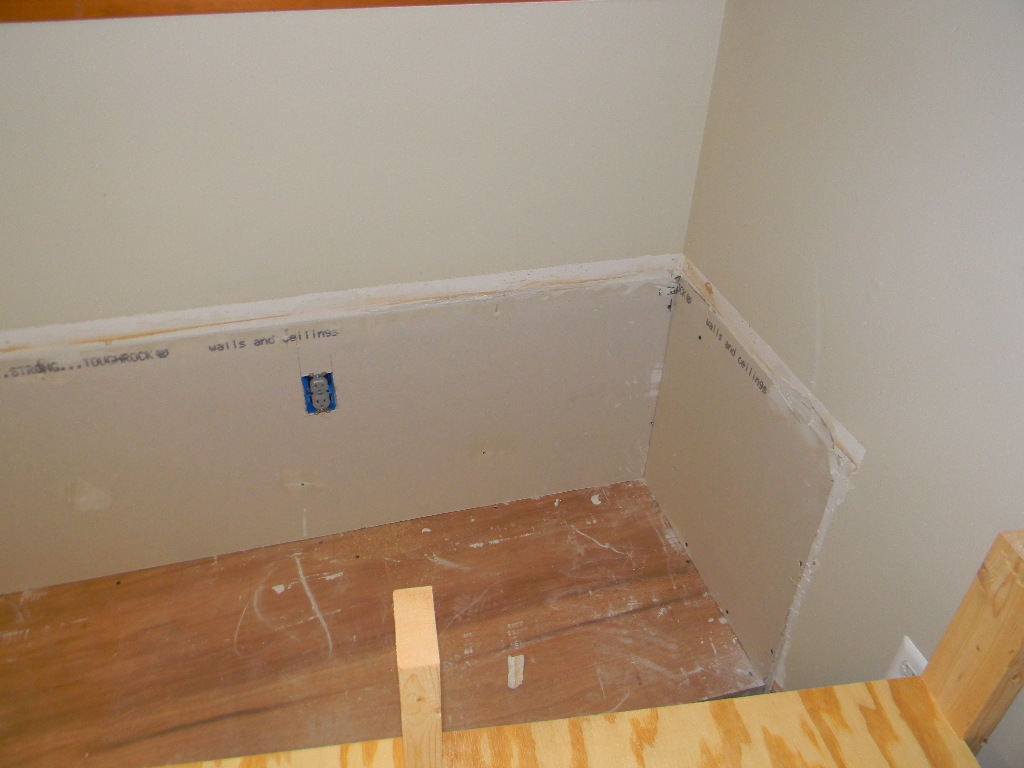

The first thing I did (totally disallowed BTW since this is a rental) was put in a dedicated 20 amp line and breaker.  I did this out into the garage for tools/compressor and another for the HT/Stereo gear.
I planned ahead for the space I was remodeling and put in a dual receptacle.  I procured a variety of duplexes while looking for new work and decided to try a stock Hubbel 5362 and an Oyaide R1.  I don't really like that Oyaide.  It grips very tightly but seems to be touchy and not really built for domestic abuse.  I will replace it soon.

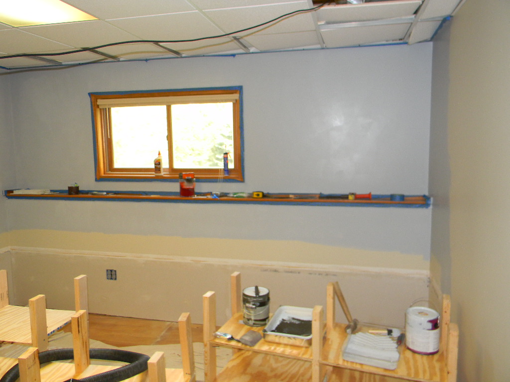

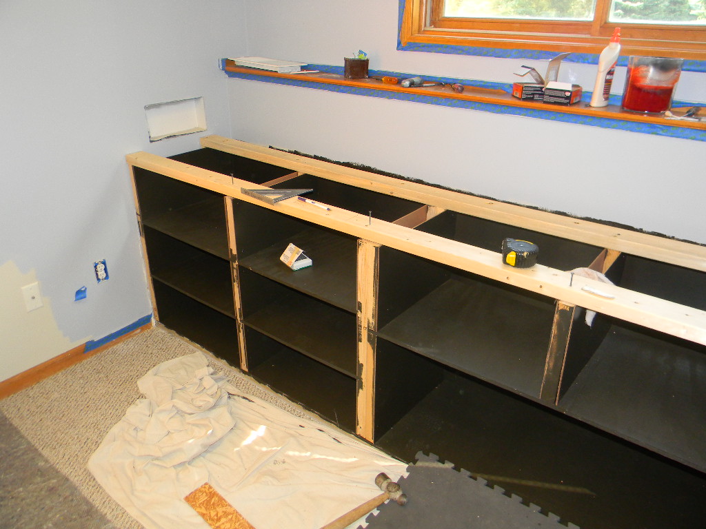

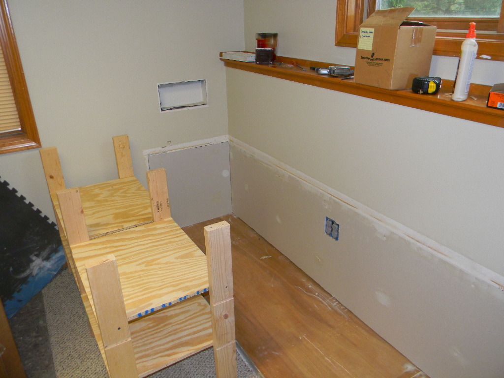

Unfortunately I do not have a before photo to show of the monstrosity that was torn out by my father-in-law.  It was a cedar lined cabinet about knee high with 3 doors on the top surface that opened upwards.  You couldn't sit there as the door handles crammed up your ....
So I decided that this was the best space in the house and in a nice walk-out basement set-up so if I was going to use this spot then it had to accommodate both 2 channel and home theater.  So out goes the use of my nice Adona racks and 3 inch maple shelves.  Out goes the ability to use cable lifts and other tweaks.
Since this is the only space to have electronics in this "small to me" house I decided to put the HT gear on the left side and the 2 channel on the right side.  They would each be using the dedicated 20 amp circuit.

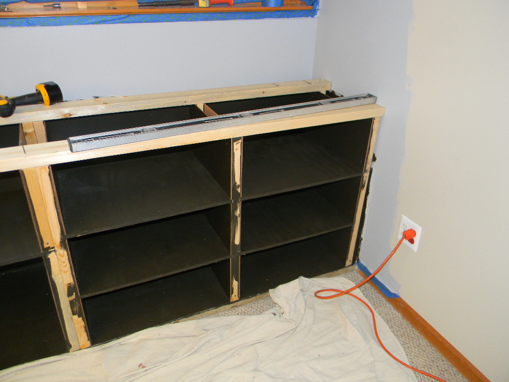

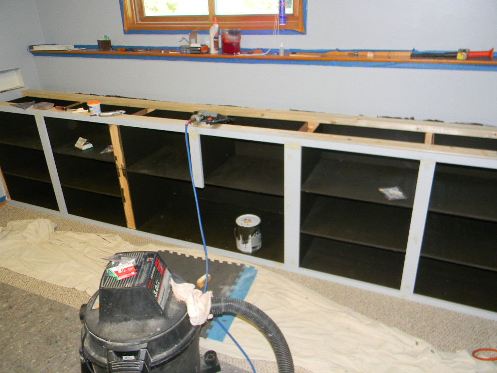

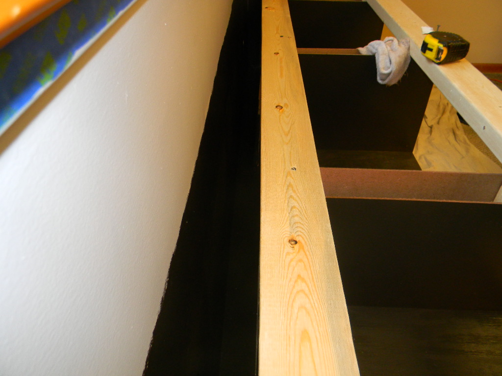

As I progressed I was constrained with the existing depth which was 24 inches but I worked the unit up higher to handle all the essentials.  Thing is that the heavy amps make sense on the bottom shelf but then I could not reach in behind them to turn them on so opted for the top shelf and made the top surface 3 removable pieces.  Each piece sits on felt pads so they won't vibrate.  I made the shelves 19 inches deep and left myself 5 inches of open space behind to run the cables side to side.  This made life much easier to string the cables.  I just painted the back of the space black and you hardly notice any wires inside.
Big Red Machine
Re: Aural Enlightenment 2
« Reply #11 on: 5 Oct 2013, 11:44 pm »

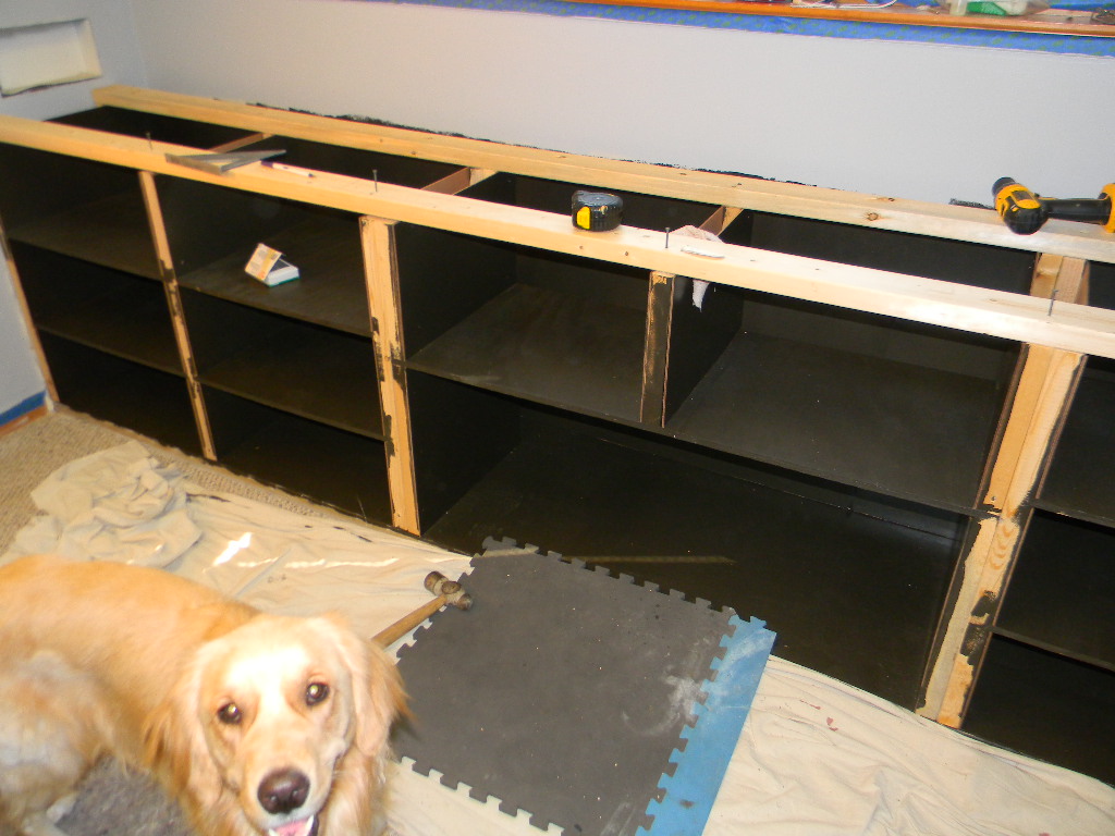

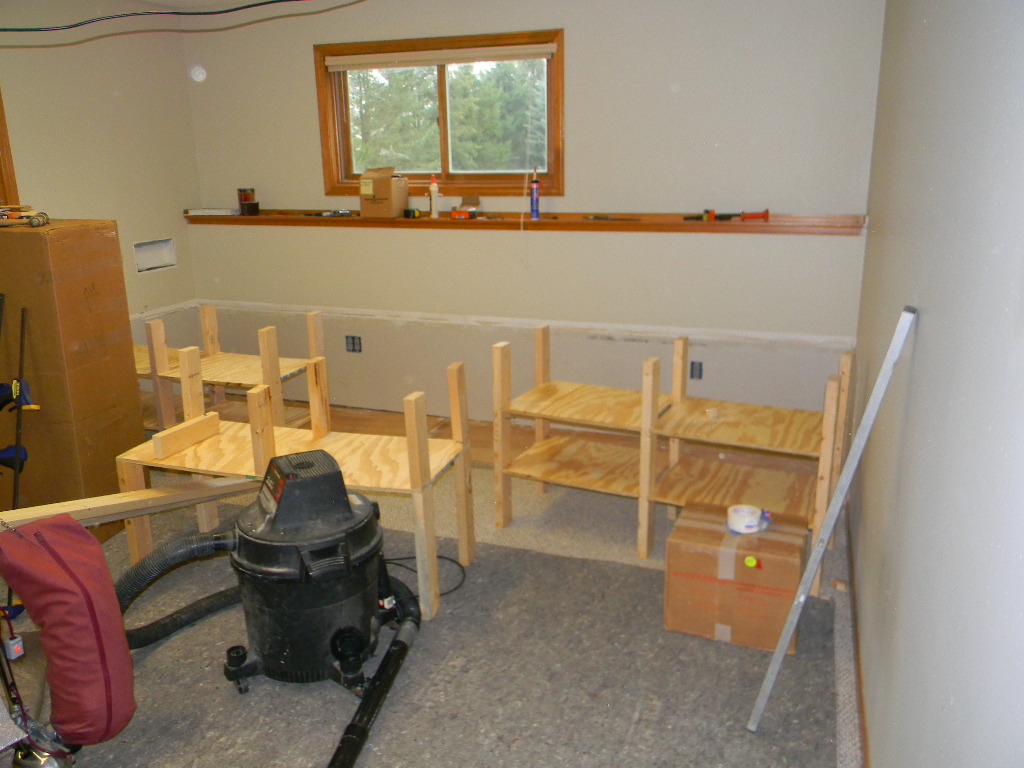

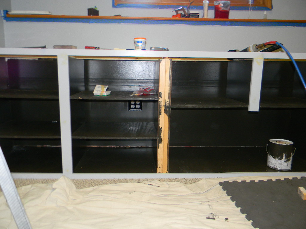

I didn't get fancy with this.  I basically dado'd some 2x4's and used 1/2 plywood.  I made 3 sections and filled the spot.  I covered the insides of each shelf space with a black painted piece of 1/8 fiberboard.  Trimmed the front with some nice primed pine stock.  When I nail the trim to the front of each shelf with the nailer I make sure the trim takes out any shelf bow when I glue and nail it up.
Crude and cheap.
Helper...
Space behind for wiring:
The floor is really unlevel here.  Took a lot of shimming and I still missed one area I'll hold secret.

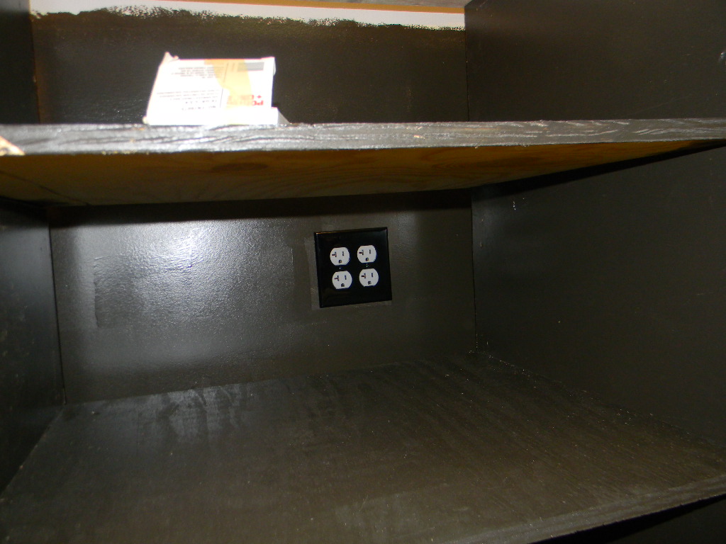

Additional 20 amp line box for the HT gear.  Overkill with two duplexes as I use a power manager device and only need one plug.  Just a Home Depot 20 amp receptacle at $7.
I left the large opening in the bottom center in case someday I can swing an SS8 center.  I opted not to use a perforated screen due to moire and other issues so a floor mounted is fine as that is what I used for years anyways.

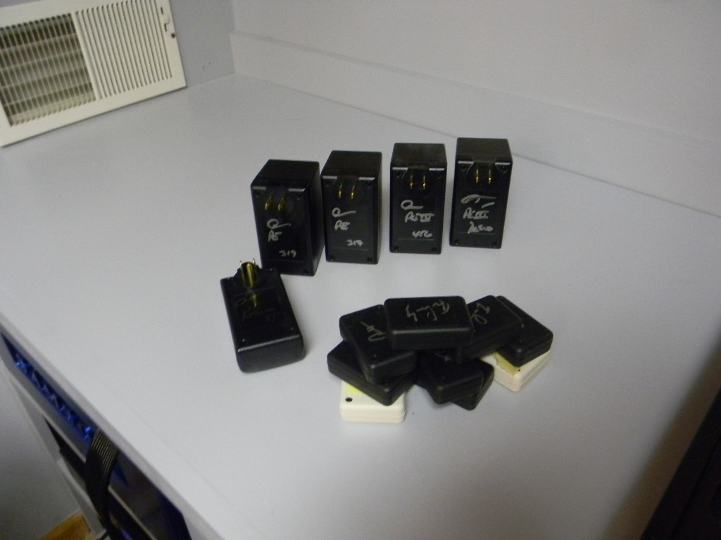

Let's skip over acoustics for now and talk power conditioning.  Wanna see something sick?

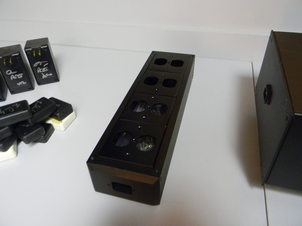

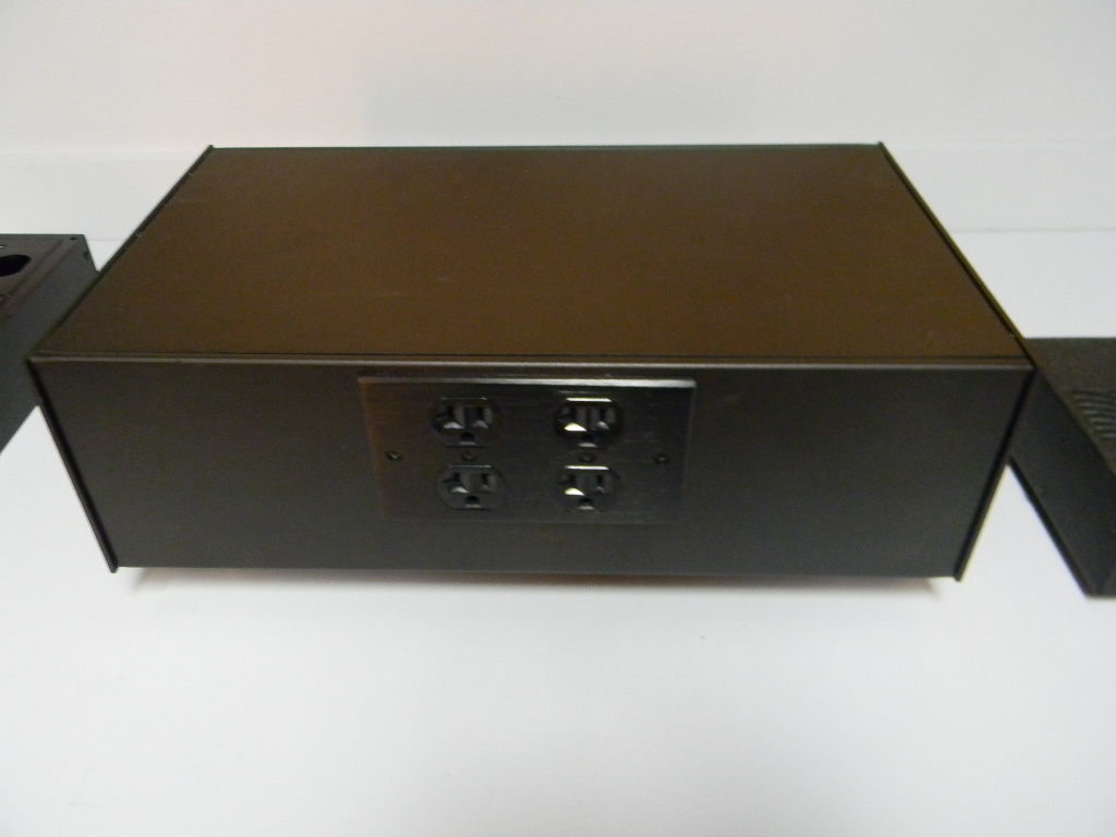

Alan Mayer products - PE's and the little small jobbies, forgot their names.  Just a few.
I had plans for this box.  It was going to have solid copper bus and TeslaPlex and other top end outlets in it.  Empty now but TBD.

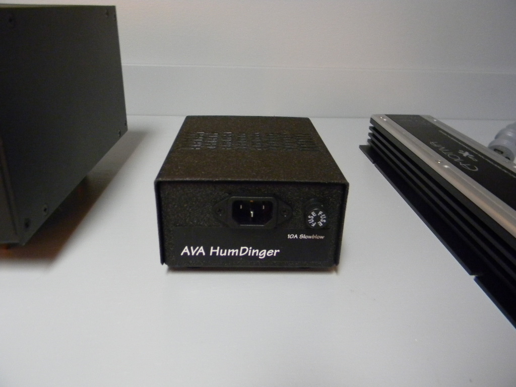

A passive junction box I used in my old digs.  Has 2 Maestros, 10 lbs of lead in the bottom and about 3 gauge copper wiring.
An AVA Humdinger - nicely built unit.
