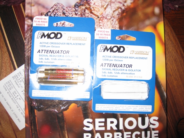

FMODS are here. Poorly labeled (hard to tell the two values apart, so I put painters tape on 1 set) and zero info on the package or their website http://www.hlabs.com/products/attenuators/ about the values, so no way to tell via the formula of what the actual frequency will be in my system.

Are you sure you received the correct item?  The link you posted is for attenuators not FMOD high pass filters.

Now you got me double guessing - I'm not thoroughly confident I received what I ordered
Packaging is labeled as a hi pass (50 or 70 Hz) and an attenuator - is there such a thing?
This is what I ordered:
QTY     PartNumber     Product
1    266-270    FMOD Crossover Pair 50 Hz High Pass
1    266-272    FMOD Crossover Pair 70 Hz High Pass

HAL

« Reply #55 on: 28 Sep 2013, 10:02 pm »
The Parts-Express model numbers match what is in the package.  Looks like it is a generic package.
Whew!  8)
I went back and checked the shipping/packing slip and it looks right (catalog part number and the number on the package match), but the "Attenuator" part didn't even register.
I put the 50 Hz pair on and gave a quick listen and it sounded very poor. "Something is out of phase" I said to myself - and it's what I said last night when I dragged Anne upstairs to listen.
The new cat had previously knocked a wire loose behind one speaker. I had managed to hook it up backwards  :duh:  Should be right now. Will give it another shot after Georgia/LSU (I'm a bit behind on the game at the moment).
