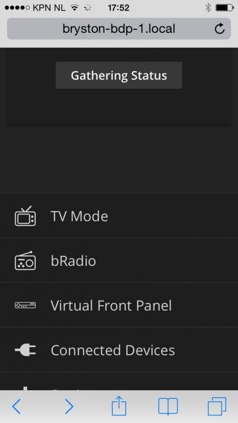

Here's an interesting fault. I'm on the 0410 build. Loading the album view results in an endless scroll of what looks like the main status page.
Yah i'm not sure what that is, i have noticed it on older builds as well just this week
Chris

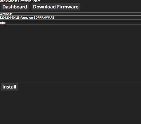

HI Chris,

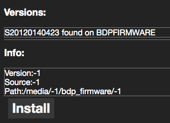

i was on 0410 and trying to upgrade, but the install-page is behaving very awkwardly . I cant seem to select any download, and the window keeps resizing somehow. Both on Mobile and desktop..Clicking install seems to start the process, but never finishes successfully. Showing the -1 files again.
Download it self seems to have been successful , so if you could show us hope to upgrade that through a terminal command, it would be most helpful.

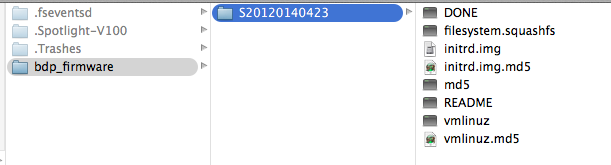

Marius, mine did the same thing. I removed all previously downloaded firmware leaving only the 0422 build. Rather than trying to select a version first, I simply clicked the install button and was able to install the new build. While this doesn't fix the bug, it does at least work around it so you can get the new build installed.
-Gary

HI Gary,
thanks! but thats exactly what ive already done, have a look at the screenshot, only 0423 is available.
I still reacts with the -1 install.. :scratch: :scratch:
Hope Chris knows a way to fix this.

What Marius is experiencing here is a case of the browser not sending the variables to the server, the server has returned "-1" for the source and version not the selected firmware version and source.  As mentioned before you should try rebooting the BDP, refresh the page and try again.
Cheers
Chris

Chris,
Ive done all that, and several times... nothing helped.

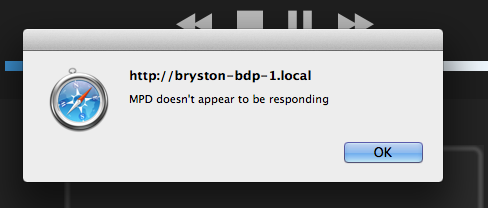

I finally managed to update to 0424 by quickly trying to click install after loading the install page, in a game like way, because the window kept resizing and repositioning the button...
After updating, MPD was disabled, never had that before.
ive still to manage to play any track, because of unresponsiveness of MM, and it loading the defaults again
cheers,
M

That message is new, I must have forgotten to mention it in the readme file and is meant to provide feedback if MPD ever crashes or doesn't start.
you may want to check the version of mpd that has been set in /mnt/img/mpd.set
Code: [Select]
cat /mnt/img/mpd.set
Chris

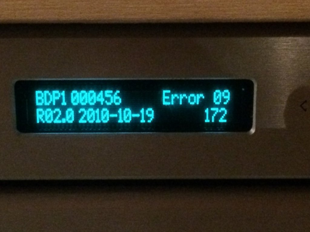

Updating to 0425 is not succesful:
Chris, what to do?
Please chime in...

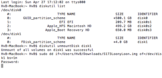

HI People,
Anyone to help please? Im executing the mac procedure right now on a CF card, imaging the LoonyLoon 173 firmware because of the faulty upgrade mentioned in an above post..
It is taking a really long time to do this though. Or rephrased: how to check if this terminal command is finished?
the cf card is invisible on my Finder-window.
Marius

HI People,
Marius
It'll take you back to a command prompt when it's finnished.  I'm not familiar enough with the dd command for unix, it seems to be different then the Linux version.  If you can specify byte size of around 1MB it should only take about ten to twenty minutes.  Doing bit by bit is going to take a few hours.
Cheers
Chris

« Reply #458 on: 27 Apr 2014, 07:03 pm »
went back to a windows machine and did the windows routine..... worked fine.
its loading 173 right now, and taking a while i guess.
don't you have an image of a MM version that was alright before. 2 steps back from 0425 was doing alright, now we have to rebuild it all ...
Please help me remember again: how to upgrade from LL to MM beta?
Marius
Cheers
Chris
