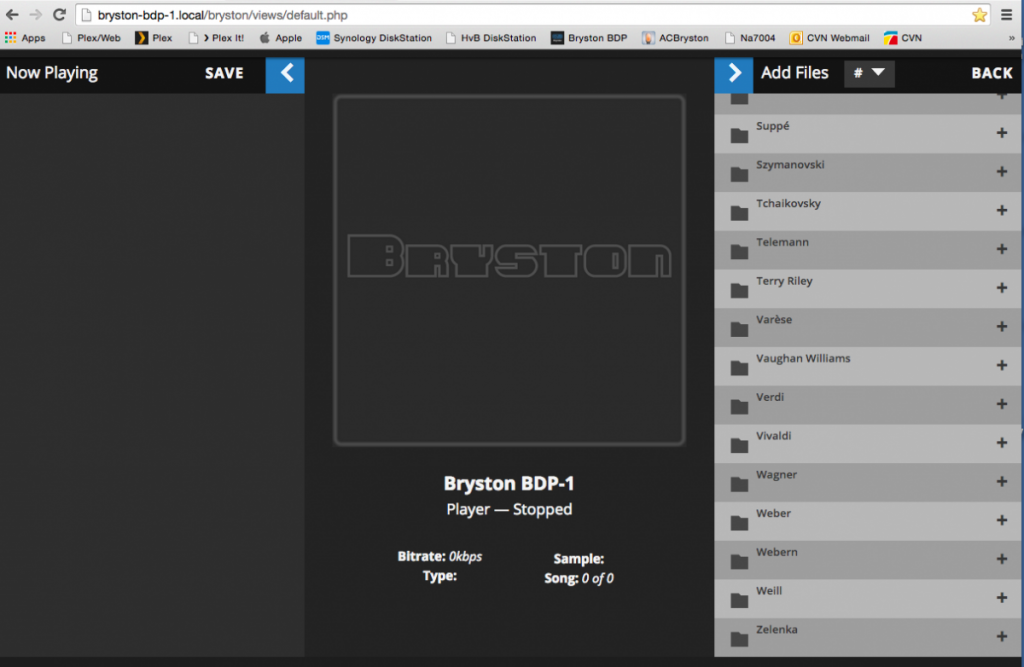

Hi Chris,
I can't get a screenshot to show the issue, since it keeps scrolling back automatically.
AC won't allow posts of screenmovies though.
The issue is that scrolling down to the bottom of a long folder list, the menu/command area scrolls out of the top of the main window, and since MM wants to keep that in place, pushes it down again, but also pushes the bottom folders down. In my case 4 folders.
Hope this is clear enough, if not let me know please. Ive also resent my mail of september 3d, please find it in your mailbox.

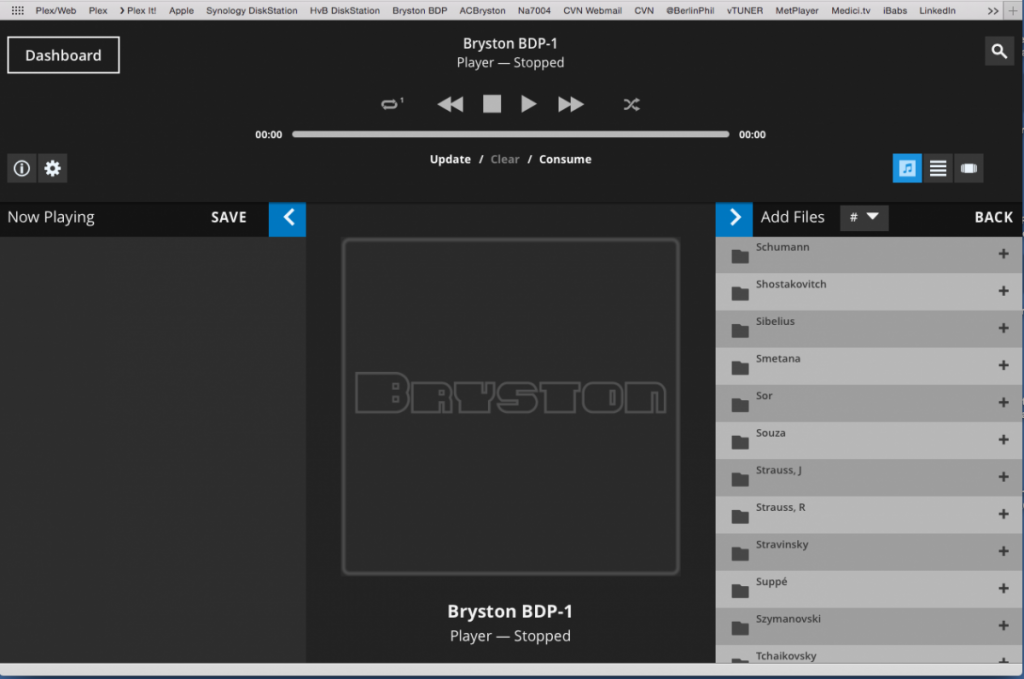

Hi Chris,
Been experimenting a bit on this.
Google Chrome Canary doesnt have this problem, though it allows for scrolling the command -bar out of sight. Don't think this is designed behaviour, nonetheless, it is much better than the scrolling issue on Safari (of which i posted the videos)
Chrome, showing the bottom folders, without command-bar
Safari, showing command-bar, without bottom folders
Cheers Marius

Hi Chris,
Cheers Marius
Hi Marius,
Originally we wanted the header showing, but during beta testing it was confusing people so we used a line of JavaScript to revert it back.  My guess is safari is is boring the line or it's having a different impact then intended.
Cheers
Chris

Hi Chris,
I suppose thats correct indeed, been like that for a while now, and the latest (07-10) update didn't change it.
Safari: Heavy flickering, auto scrolling the bottom folders out of view.
Although Google Chrome Canary is much easier on the eye, that too isn't acting the way it should: it scrolls the command bar out of view when scrolling down to the bottom folders.
I guess i was hoping you'd provide for a solution, you're  not forgetting us Safari users? It is really no option using Safari in this stage of MM development.
Maybe some settings have to be adjusted in the javascript options, or what have you?
Marius
Hi Marius,
Cheers
Chris

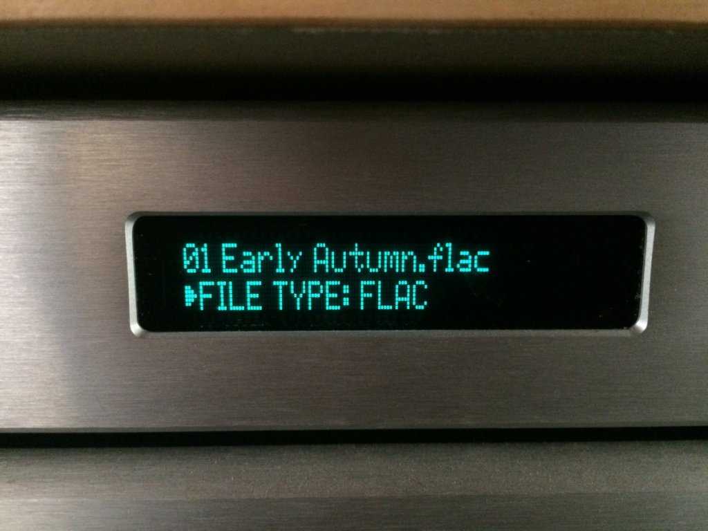

Hi Chris,
It is not often I check the front display but just now I noticed it shows file name and type . While it would of be much more use showing artist or album for example . There is so little space , let's not waste it.
Or is there a setting I need to change ?
Thanks!
Thanks!
Marius
It should display the artist and album, the playback menu does contain some settings that may help; it's been awhile since I have used them and I'm not near one of my BDP's to check right now.
Cheers
Chris

I'm facing a strange problem: I installed the MM 2.06 and from then on I see only a part of the stored folders: in other words, the folders list in the MM music player (located on the left hand side of the MM player web page) contains just a partial list (until the "N" initial letter); all the rest is hidden.
If I browse the folders with the front display commands, everything works fine, I see them all.
Is there any folders number limit? If so how can I increase it?
Best regards
R
A described in the manual, N means he BDP hasn't started all the needed software packages to play music and yes the max playlist length is set to 300 and changeable.
Cheers
Chris
