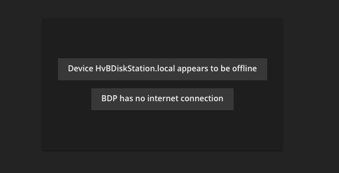

HI Chris,
as of lately, mpd-watch doesn't prevent the BDP from loosing connection after a longer while of non-usage. Apparently writing files to the attached usb drives doesn't count as usage, since just did that through Finder/Mac, and still MPD won't respond.
Rebooting it is the only solution to bring it back alive again. Strangely rebooting is possible from within MM, while most other commands won't work.
in MM interface you state MPD-watch being useful when playing music non-stop for more than 18 hours. It seems we need the same functionality for not playing at all for the same period?
Also, after rebooting, often MPD is not working, and i have to explicitly re-enable the service. on several other occasions, MM states the BDP is not connected to the internet, and the network drive is offline, which of course it isn't.
im on build 08-18
Hope you could  fix the page scrolling-flickering issue soon? it is not only terrible on the eye, but it prevents us to show the bottom of the page, exactly the spot you've programmed the non-indexed music-files to be listed...
updating the database renders the BDP to be unresponsive and out of service altogether right now, not even showing it is updating....:
Marius
I've been experiencing a similar issue with my personal BDP-1 at home, problem is it doesn't appear to ever to lock up while top is running from terminal.  My current fix is to always have a terminal window on your mac open running top from the BDP  :lol:
I am aware that this freezing/crashing is occurring, but I haven't been able to gather any information as to what is causing it.
I have been trying to fix these flickering issues, the only ones I have noticed (been able to reproduce) so far have to do with the scrolling marquee.
Chris

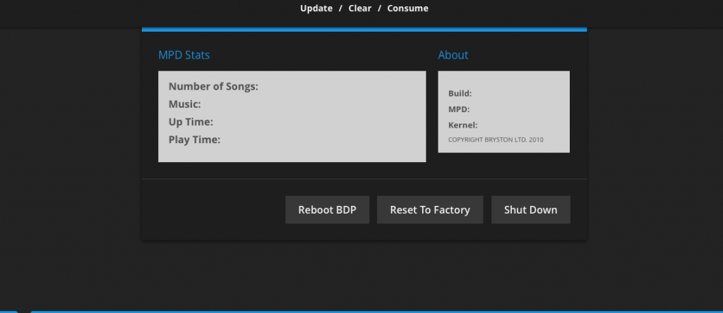

Ill have to rephrase my previous comment on being able to reboot through MM.
I thought i was, but yesterday i found out the reboot command in MM didn't really reboot the bdp. It was still in locked state, the display showing tracks from when i last played it more than a day before. MM had been faking reboots :scratch:  Physically rebooting it did of course (power off/power on) help, and i was able to talk to the bdp again.
This well explains why after rebooting the mentioned issues weren't solved... The BDP was still in locked state. As to how MM displays the rebooting sequence, while in fact it isn't, is beyond me, maybe some extra coding is necessary to make sure MM displays the true physical state of the BDP.

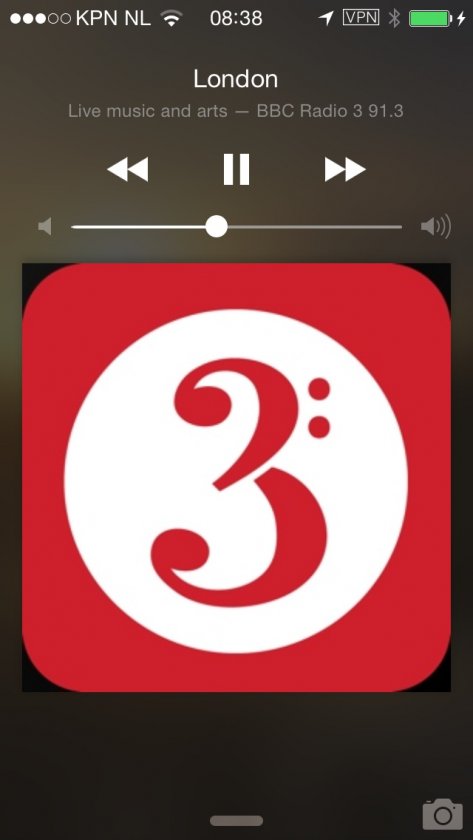

And the other thing, the lock screen: the screen i provided is a Tune In screen. others do it to, they are not a
Apple apps. Music apps that are running while the iphone powers down in lock screen. Alex and the likes use it to great effect. The command keys are available, without having to enter the Iphone again.
Mpod doesn't use this functionality yet, unfortunately. Don't know if a browser app like MM would be able to use this, but it would certainly be wonderful.
