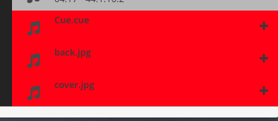

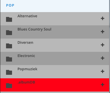

HI Chris,
Seems to work fine, thank you. Is there any reason the .albumDB is still red? Had other non-music-files entries (indicated with the music icon) too in red i didn't dare to click....
working with these gives another question: would it be possible to have an Update-new button at all? I usually upload albums several at a time, and browsing to these to find them in red and clicking them, is possible, but still a bit of a hassle, compared to just click update-new, and let MM find the red entries .
Marius
Selective updating was reintegrated a few revisions ago, inside the media player settings is an option to display files and folders not in the database.  When this option is checked, items not in the database appear at the bottom in red, clicking the item will add the file or
Folder to the database.
Cheers
Chris
