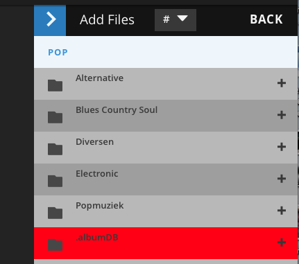

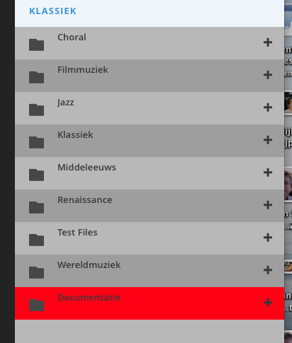

Re: Manic Moose (S2) - BDP's third major firmware release
« Reply #677 on: 17 Jul 2014, 12:35 pm »
Hey Chris,
Any reason all of a sudden these red highlighted entries show in de folder-structure in Mediaplayer?
Marius
btw: had to reboot the bdp several times to get rid of the highlighted Update and U on the front display. Is the new firmware taking longer to update new albums?
btw2: scrolling makes the interface 'flicker' terribly. I get the feeling it has to do with the software being auto-adapting to the windows-size, seem to recognise is from one of my own sites....
