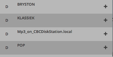

HI Chris,
you've done it! share is working now, and a folder on the share is selected. Great!
was a bit awkward to get it to work though, but suddenly it worked. Havent tested playing the share yet, but this is a very fine beginning indeed.
Would it be possible to optionally list the shares without the underscores, maybe even without the drive it is located on? Seems a bit to computerish now showing the network drive ea in the user interface. For me, id just need the MP3 'cabinet', and i don't mind where it is now.
O, and w/could you make the passwords **** preferably?
cheers,
Marius
Hi Marius,
I prefer to show the password in plan text for a few reasons;
the first is if something goes wrong and its because of a typo in the password field then the end user can still see what he's entered.
Secondly its only displayed for a few minutes while setting up the NAS, which should only need to be done once.  So unless your worried about someone looking over your shoulder might i recommend setting it up from your iPad in a corner of a room  :wink:
Chris
