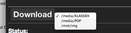

Issues here too: download starts, not showing in the progressmeter, and only showing very shortly in the install window
Cant install .
Chris, please re-enable downloads to the thumbdrive again.

My last post on this meant to ask you something else though. Before, in the download box i Manic Moose, you offered the option of dl'ing to an attached thumb drive. As of lately, only the usb harddrives and the system cf card appear. Cant you re-enable the thumb drives in that interface again? On your advice i have a dedicated thumb drive there, next to one with music files, but neither of them are visible in this interface right now.
Cheers!

Nice! Though a bit more complex than before, this makes it possible for us to dl the firmware to any place comfortable, and not interfere with the music files, or have issues with the root files in the system cf-card. wonderful.
Cheers!
Marius
Hi Marius,
Oh ok, yah i misunderstood you, something must be broken as it should list all drives.  Perhaps the problem is with spaces in the drives name, i'll do a little digging.
