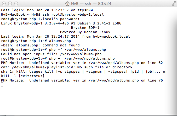

Marius
Re: Manic Moose (S2) - BDP's third major firmware release
« Reply #222 on: 19 Jan 2014, 04:18 pm »
sure i could, will, but while i could ssh into Root before, im no longer allowed since the remote hoste changes identification.
I even wrote to album.php, but am not allowed to save it, because of the same authorisation-problem. Maybe enable that first?How to proceed with that?
Then ill try and take one Drive away, ensuring the library isn't too large.
If things won't workout still, ill flip into service-mode...
So please, help me get into the terminal mode again, and let me write to Root, which i did before without an issue, creating the Playlists.
Marius

Hi Marius,
the simplest thing to do is remove your trusted hosts file and you computer will create a new empty one.
rm ~/.ssh/known_hosts
should do it.
Chris

Marius
« Reply #224 on: 20 Jan 2014, 12:32 pm »
Chris,
Please check this, there seems to be some error in the albums.php file, and in the folder-reference. Had to change the command to the right folder, but in albums.php a line  is incorrect too? the playlist.pid is available though, contrary to the error-message
Marius

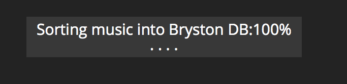

Marius
« Reply #230 on: 28 Jan 2014, 10:02 pm »
Hi Chris,
Check this: we made it ordering 100%! Generating Albums right now, fingers crossed ....
While the bdp is generating these, please let me ask, whether we can have these albums displayed in a selected order. I recall seeing them only alphabetically ordered, which means all my different music styles are mixed into a very unusable set of album views..
Would be great if we could order on Style, composer, artist, or just plain on folder structure, which would seem best, since most of us file albums on an ordered tree like this i guess.
Plex has this feature, and it works best i feel.
Cheers, for getting it this far...
Marius

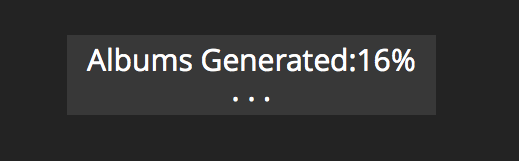

« Reply #232 on: 29 Jan 2014, 06:32 am »
Great!
Since tagging is a bit of an erroneous proces now and then, and album art would be mixed up wrong on that case, please do add the folder structure to be one of these options . At least one knows for sure the Organisation is right I that case, no matter what tagging issues...
btw, albums generated on 16% now. It hangs, or is extremely slow... can't tell really, cant reach the bdp, so it might be too busy generating albums. Or, just plain hangs.  :lol:
Marius
« Reply #233 on: 30 Jan 2014, 02:43 am »
Great!
Marius
Hi Marius,
Each time I had ran the script it seemed to hang while converting a picture file, I think I'm going to investigate aget stove methods programs tomorrow.
Cheers
Chris

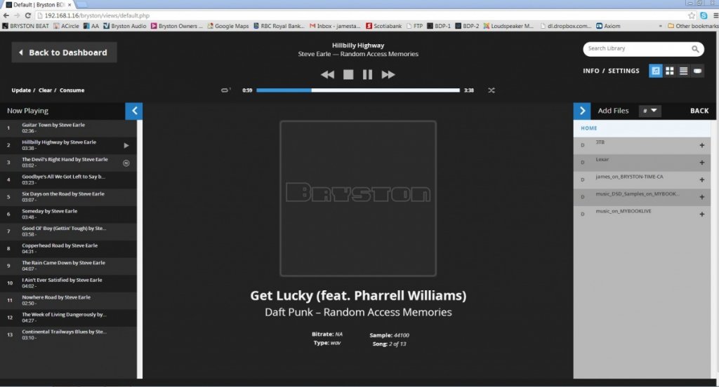

It is much smoother than before, my albums now play, the album data base seems to be working and the firmware update certainly didn't throw up any error this time.
The one negative so car is that Google Chrome now longer works - it wont select or play albums, the album DB does not show the covers in "album view"....
It certainly feels that its moving in the right direction - thanks to you and all the testers for all your efforts.
Rich.

Hi Rich
Chrome seems to work OK with me at work and at home.
Grit
  • Posts: 693
  • - Garrett
« Reply #238 on: 31 Jan 2014, 06:48 pm »
What versions of Chrome are you both using? Any plug-ins installed?
Put "chrome://chrome/" (no quotes) in the web address bar to see the version (and update, if necessary).
Mine shows :
Version 32.0.1700.102 m
Google Chrome is up to date.
Ritchief
  • Posts: 89
« Reply #239 on: 31 Jan 2014, 06:56 pm »
Hi Grit,
I am using the lastest version has you state below with no plug-ins, but I cannot add any albums to the playlist.
I have logged off my computer and back on again with no difference.
I should mention it works on Explorer.
Any ideas ?
