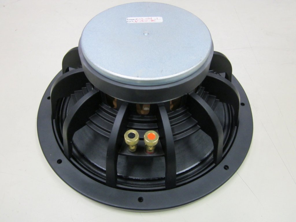

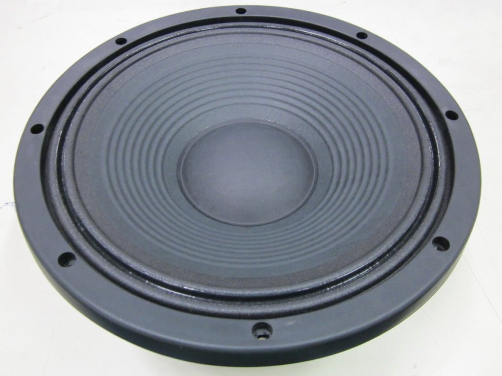

Many thanks JLM for the compliments and more coming with built in subs. Doing something a little different right now. I will say that it will look like a Super 3 XRS and only 1 inch added in the depth. The system will be sealed box and have a bass driver to boot. It's getting very interesting.
Also I have a picture of a pro style 12" and this is just a prototype. Still working on it and I maybe able to make it high Q for OB.
