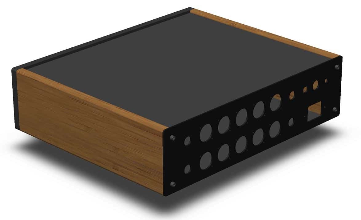

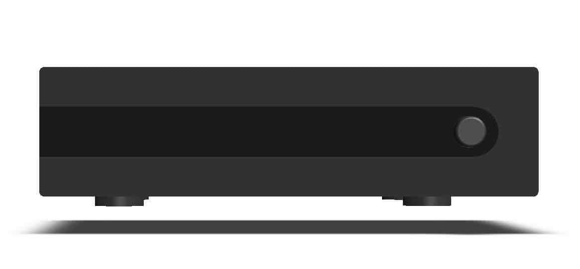

As of 7.1.14 we are announcing the upcoming release of our new line of finished LDRx & LDRxB Passive Preamp products. As things stand now, the official release date is July 31, 2014. Despite the epic delay is getting product ready, this is the real deal. It's really going to happen. Soon. No,  really!  :green:
When released, the LDRx will replace our existing LDR3 and LDR6 offerings and can be ordered with 3-6 inputs. The LDRxB is our first balanced passive preamp with a blend of 3 balanced plus 1 alternative unbalanced input, 2 balanced outputs plus also an unbalanced output. Both versions will be housed in our new attractive enclosure design and utilize our latest LDR3x.V2 preamp controller board featuring  auto-calibration.
As of today, we are accepting pre-orders. LDRx & LDRxB product posting with the details can be found on our website: http://www.tortugaaudio.com/product/ldrx-ldrxb-passive-preamps/

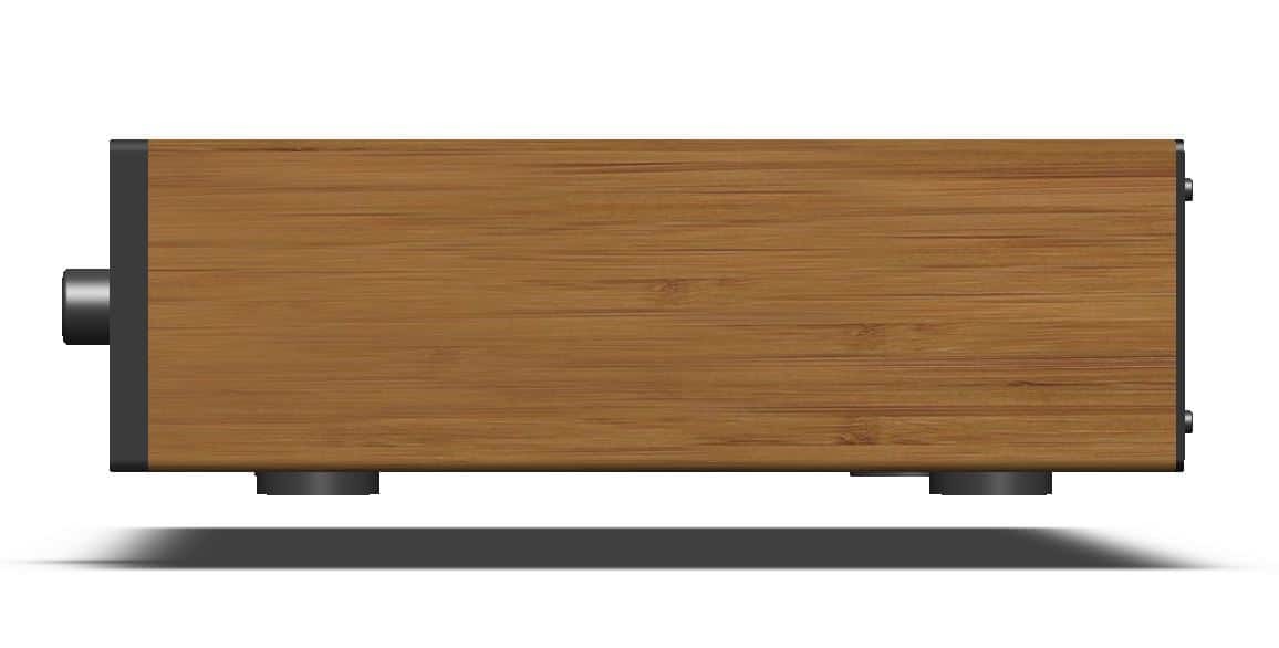

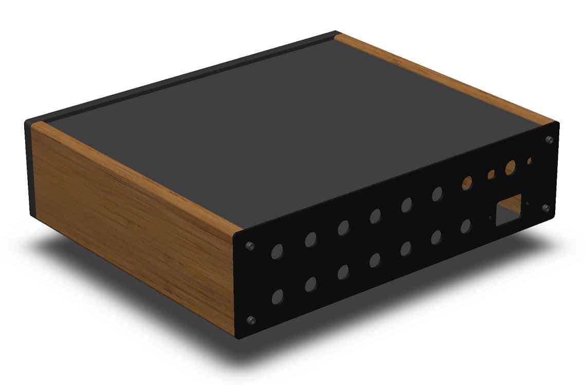

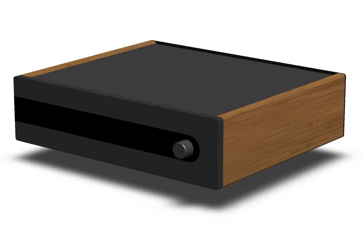

Here is our latest CAD renderings. Actual pics to follow when they're available.

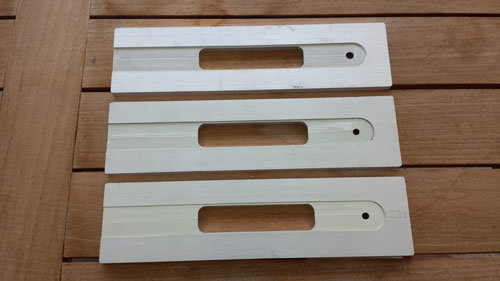

The pic below is a set of front panels fresh off the CNC mill before brushing/anodizing. Note the milled out center stripe is for the dark acrylic inlay which will cover up the "window".

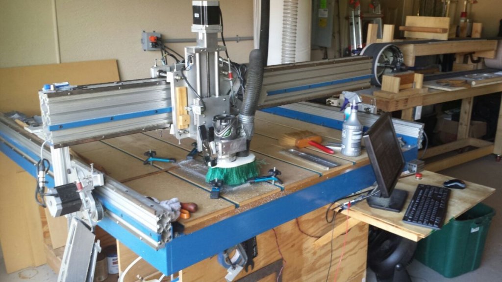

Here is a link to a youtube video showing one of these front panels being milled on our CNC machine. We removed the dust/vacuum cover so the cutting would be visible for the video which is why there are cuttings everywhere. http://youtu.be/-Q9WLLeFIuE

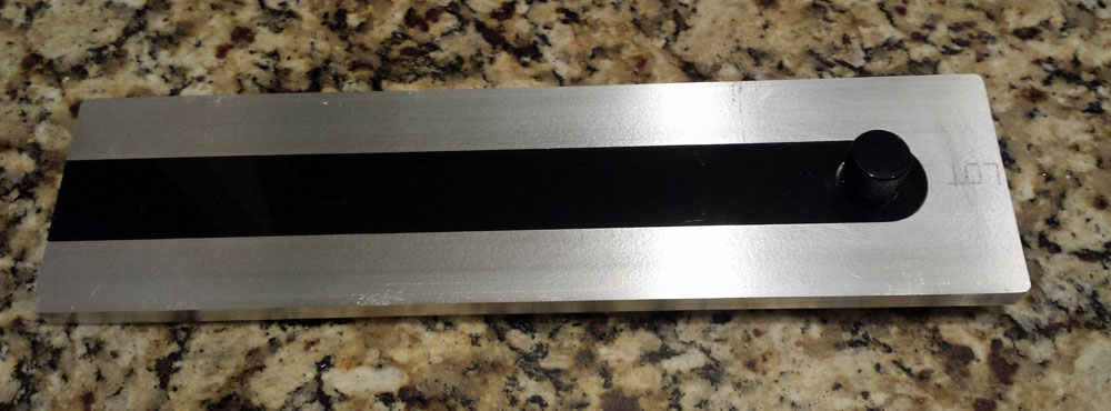

This isn't a very good photo but it shows the 3/8" thick x 3.25" high x 12.5" wide raw front panel with the dark acrylic inlay/lens plus the enameled knurled Telecaster knob after the initial fit-up around a week ago. The panel still hadn't been brushed or anodized. When it's anodized it will be black-knob on black-inset on black-panel. The dual blue displays will only be visible when they're on otherwise they'll disappear.  A very cool look!  :thumb:

« Reply #29 on: 7 Aug 2014, 11:40 am »
That will be sharp!
I was toying with the idea of building on your V board but I'm happy to buy a built unit seeing how your design looks and it coming to life.  Nice!  I think the blue display through that dark/smoked acrylic will be cool.
What will be the dimensions now that you have some faces fabricated and some lots built?  I think you have answered this previously but I thought I'd ask again now that you have some lots built.
Thanks for taking the time to share the photos!
Nominally 12.5" wide, 3.25" tall (plus feet so figure 4" overall), 10" deep (plus with knob and jacks figure 11.5" overall).

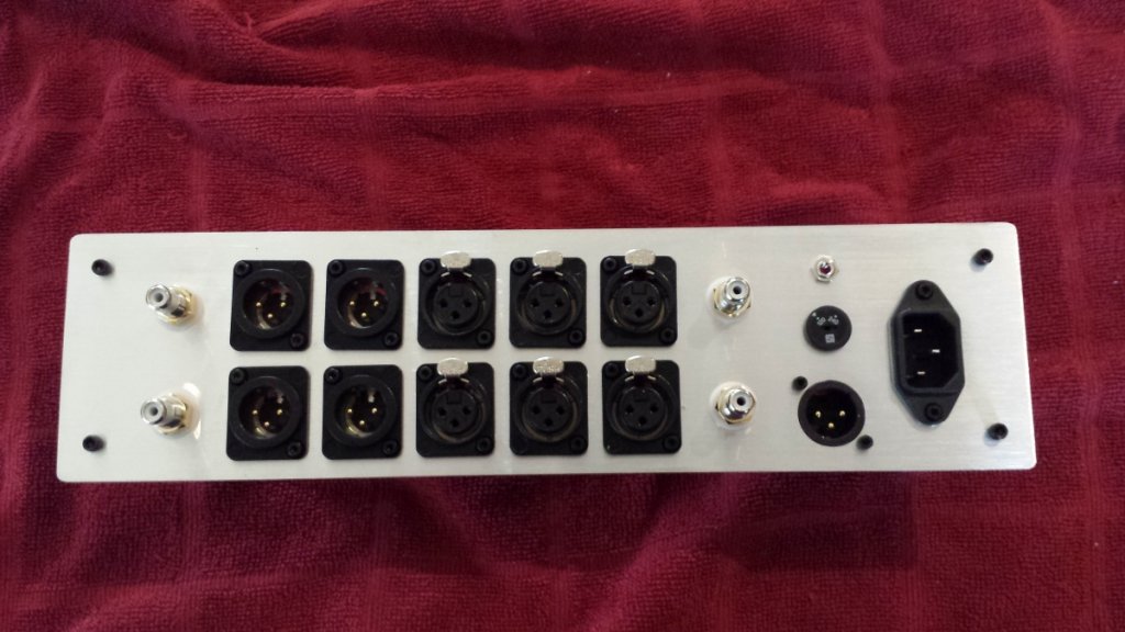

Here's a pic of the rear panel of the LDRxB Balanced Passive Preamp showing final fitup of parts. The XLR jacks are heavy duty cast Neutriks with gold connections. The RCA jacks are Cardas. As shown here the panel (3.25" by 12.5")  is raw brushed aluminum prior to being black anodized which happens later this week. The XLR socket in the lower right is standing in for a dual USB socket which uses the same XLR form factor and should arrive from our supplier in a few days. To the left of the power entry module is the 115/230AC selector switch. Above that is the 12V Trigger Out.
We are on track for release at the end of the month at which time we'll start building and shipping units beginning the first week of September starting with existing pre-orders. There is still time to place pre-orders for at 10% discount through Sunday  August 31st. http://www.tortugaaudio.com/product/ldrx-ldrxb-passive-preamps/
