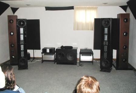

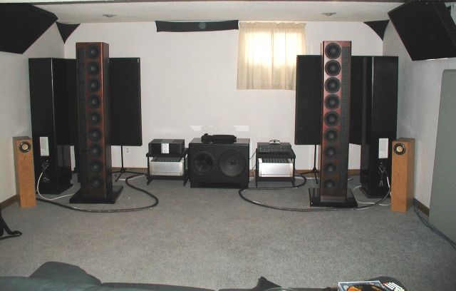

Here is a shot of The Horn Shoppe Horns hooked up with the KKSV-2 speaker cable. I thought the Horns were the most over achieving speaker we listened to yesterday. They sounded very good at low levels and they could PLAY LOUD!!!
It might have helped having them hooked up to the JC-1s with speaker cable that would sell for 10 times the cost of the speakers :o
You can see the Alphas next to the Horns and the RM-40s with their back to the proceedings
Now it is the 40's turn to play and the Alphas have turned their back to the audience

OK, more pictures.
Front row, left to right: Tyson's friend Steve, Tyson
Middle row, left to right: Sean (sunshinedwag), Brad (brab b), Gary (gme109), Pete (pete g)
Back row, l > r: Jerry (Turk), Wayne
Bottom to top: Monster balanced power supply (modded by BOLDER Cables), Hagerman Cornet phono stage, deHavilland UltraVerve preamp, Exemplar Audio modded Denon 2900 CD/SACD/DVD-A player, Eurolab TT with M0rch arm and Scheu modded Benz Glider.
Parasound JC-1's, Rotel for the sub, VMPS Larger Sub, Marchand XM-44 XO. Note the Marchand is only providing low pass for the sub. The main speakers were being run full range.
The Hornshoppe Horn. What am amazing little speaker. I really liked these little guys. The sound of voices and piano was excellent. The bass was much better than I would have expected and even integrated with the sub fairly well. As Wayne mentioned, they will play loud. Unfortunately I made them (and everyone in the room) suffer by putting in some Albert Collins and cranking it up. Reproducing his Telecaster at high volumes is something many speakers can't do well and it was painful with the little horns. But at more reasonable volumes these suckers were very nice. This picture shows the over kill... A $700/pair speaker connected to a $10K cable. :o
