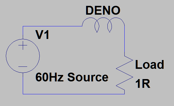

While I'm not trying to fuel the fire, I do have some actual data about the 16A/4mH Schurter DENO inductor in question. I ordered a few of them and lashed up a test jig last night and did a few simple measurements. I did this for my own edification but thought I'd share.
The jig is as simple as possible, a high current 15V transfomer fed from a Variac feeding a series circuit of the inductor and a 1R resistive load.
I then used the Variac to generate various source voltages and measured the voltage at the source and load. Since a 1R load was used, the voltage across the load equals the current and Kirchoff's law says all currents must be equal in a series circuit, calculating the Z the of the inductor is as easy as can be.
First I measured the inductor with an LCR meter.
DCR0.02 Ohm
L vs Freq
FrequencyL
100Hz6.78mH
120Hz6.76mH
1kHz6.68mH
10kHz6.37mH
Since the measured L was greater than the 4mH spec, the calculated reactance @ 60Hz for 6.78mH = 2.556
VSourceVLoadVDifferenceI (Amps)Inductor Z
0.10.0280.0720.0282.571
0.210.120.090.120.750
0.3360.2230.1130.2230.507
0.5010.4240.0770.4240.182
1.020.9450.0750.9450.079
2.0191.9030.1161.9030.061
3.012.870.142.870.049
4.023.850.173.850.044
5.024.810.214.810.044
6.015.750.265.750.045
76.720.286.720.042
87.770.237.770.030
109.630.379.630.038
The short version is, above about 30mA the core starts to saturate and it becomes a low impedance device. This in no way takes away from the dangers of placing an impedance into a safety ground circuit! I am simply presenting what I measured. If my methodology was wrong, please correct me. It was late and I'm by no means an expert, just a semi knowledgeable tinkerer.
mike
Excellent design, excellent implementation, excellent data.
Poor wrap-up.  I disagree with the descriptor "semi".. :thumb:
Thank you.
John

mgalusha, thanks for that small test. While I could get a lot of light-bulbs, I think I'm satisfied with that (again). Besides I was thinking more about breaker tripping scenarios, not inductance tests. Btw I'm fine with straight forward talk on safety, but you have to let people use information, not force it on them unless there are legal concerns because they are breaking code in public conditions; at which point you don't enforce it, someone else you contact does.
Note*: The DENO isn't made for being in the circuit mgalusha has it in, if anyone is reading this and curious. It basically doesn't work in that condition. It's meant for ground (earth).
*NEC only requires non-solder bonding, for electrical bonding (hard-mounted electrical wiring into a structure) which doesn't include a device you may add the DENO too. However, compression is a great idea in AC application considering the high current, and long term use. (I actually have my CMC/DMC's I use in power conditioner crimped and soldered, the DENO's are just crimped)
