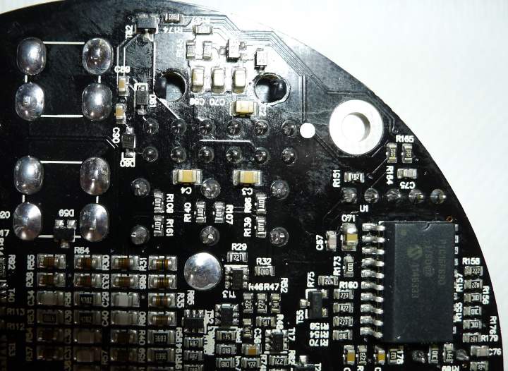

Then, spending a few minutes looking through the easily-findable web-photos along with the datasheet and manual for the NC1200, one sees that its output filter has positions for three sets of two caps... and in most pictures (including on Hypex's info), you see both positions filled. And if you zoom the pictures in Hypex's info, you see the caps are .33uf 100v, supporting the suggestions that they are polyprops. Only the pics in the 6Moons Industry Feature announcing the NCore amps shows one cap in each position. And if they are .68 as one might suppose, then I'd agree with Ric that in this instance, they were mylar as Wima does not list a .68uf polyprop.
This plus the comments above lead me to a few questions:
1. Why is there any question about the goodness of polyprop caps versus mylar? I thought this was all settled in the early '80s with the Jung/Marsh article on 'Picking Capacitors' in the now-defunct Audio magazine and tons of related articles since.
2. I get the importance of tight loops in digital circuits (tho I am not an EE). Why is Ric's stacking of two .33 polyprops significantly worse than using two side-by-side as in the published photos of the NC1200?
3. Has anyone considered or better-yet tried some of the SMD PPS capacitors available in place of the Wima's?  Panasonic lists a .22uf 100v PPS available at Mouser. I've read varying accounts of the 'goodness' of PPS versus polyprops and polystyrenes, but they sound to be in the same class. At  7.1mm L x 6.3mm W x 4.8mm H, they could be soldered together into three stacks of about the same footprint as the existing mylar Wimas, cobbled into the circuit with some add-on leads similar to what Ric uses to modify the Wimas, and provide about the same capacitance and loop area with a better dialectric. The only question I have is outer foil directionality... I believe these are stacked foil, not wound like the standard Wimas. Do stacked foil caps have an outer foil?
4. Barrows, my thoughts looking as the components around the output filter top and bottom are that the three .68uf caps are not in parallel to make a single 2uf cap, but that they are seperate legs of a more complex filter. Have you traced the circuit and confirmed that they are used as a single 2uf-value cap?
Greg in Mississippi
P.S. Reading the NC1200 manual and datasheet was very instructive. First, the little circuit boards sticking up that I assumed were add-on input circuits turn out to be the regulators. Second, it appears to come with an input circuit (buffer) built-in, but it can be easily bypassed with soldered-jumpers... that's likely how one adds a different front-end circuit.
Pity, they don't sell this one to us DIY'ers! It'd be a lot of fun!!!
And does anyone who read the super-long NCore threads here and on DIY Audio remember if there are comments about the NC400 having high-quality regulation built-in for the input stages? If the NC400 does not, this is likely another thing that helps explain the sonic differences reported between the NC400 and the NC1200
implementations.

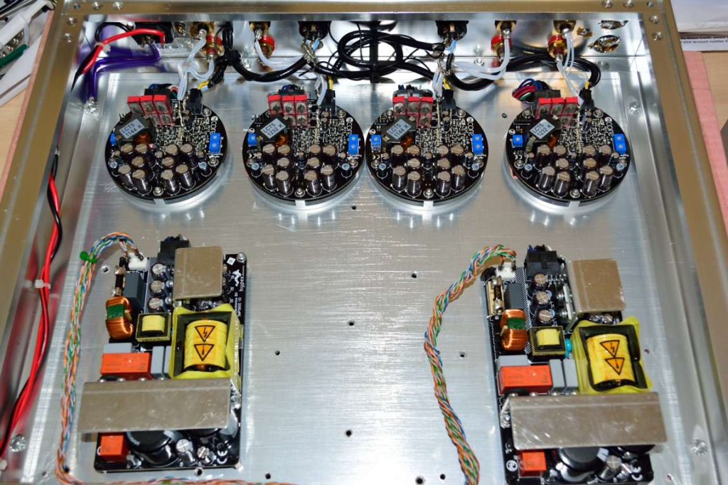

My current setup with the NC400
The four NC400 are located in a single aluminium container. Each pier of NC400’s is powered by a single SMPS600. This is bi-AMP arrangement to power a single speaker.
This is bit perfect setup for me to prove this mod stock polyester to polypropylene, test instrument the Ear (physical cap surface area after change twice the area though same PCB board placement of stock cap) emi I will listen out for it :thumb:
-Components-
PS Audio power plant
PS Audio MK11 DAC with Ethernet Bridge
Software – Player - Jriver - driver bit perfect PS Audio WaveStream out on windows 8 CPU 3770k and 16 gigs ram CPU shows <1% utilisation streaming 24\96 bit album
Amplifier 4 X  NC400 bi-wire pair power speaker
Cables - silver
Cables - balanced
Speaker- Theophany Rhapsody
Thanks  :thumb:

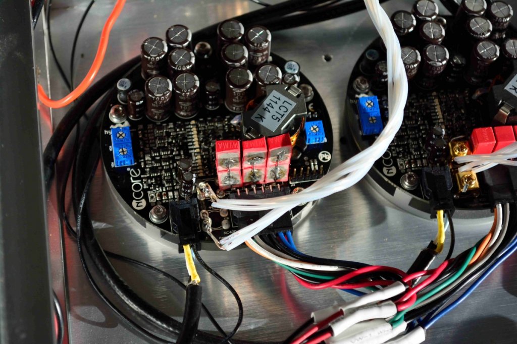

Two of the four NC400 have been modified swapping out the .68mf polyester cap for .33mf staked polypropylene. One of the six caps pulled had steel leads.
They have not fully burned in yet, only two hours operation, from first switch on it was plainly evident the mod was successful sounding better to my ears.
I have lived with the 4 NC400 for about a year and very familiar with the tone. I wont go into a lot of detail other than the sound is greatly improved and well worth the effort of the mod. Big thanks to Ric Schultz at tweakaudio for the modified WIMA Caps.
The sound improvement was one I can reference to going from the mk1 digital to analogue board to the mk2 digital to analogue board in my PS Audio DAC those having done this will know exactly what I mean. In essence the NC400 is now more detailed and a greater sense of that's how that instrument sounds.
I will update as the caps burn in
First hour - power up and after some listening it was apparent to me that the mod sounded better than stock -
24 - hours in the sound is more open, WOW love the sound of the guitar and violin, there is an improved sound to the bass and vocal is more articulate
48 - many hours of listening now and these are my last words. The Polyester caps don't do the sound justice for the NC400. The polypropylene caps have resulted in a more articulate musical performance, the ambience is easy to connect with and I find myself tapping to the rhythm of the music. I do find it incredible there is more music to hear with this caps swap-out. If I ever get a chance I will get the amp measured to see if the specs have changed. My concerns the caps would have attracted noise was not to be the case the. the highs are significantly more detailed, vocals more etched and lifelike the bass has good weight but sounds more defined.  :thumb:
Changing out the .68mf polyester caps for .33mf stacked polypropylene has a sound difference way more significant than changing cables in your system.
I have not finished the job, this was initially to check the mod was good. Well it passed without any doubt.  I plan to mod the remaining two, at that time I will rotate each NC400 180 degrees shorten the wiring significantly. Another idea I will take the power loom and put this to the outside beneath the case and pop it through the case at each point connecting to the NC400 and SMPS600 respectively. I will shield the cable on the outside beneath the case. I will partition off the PSU from the NC400's as well
You may see I removed the Speaker post and replaced those with Silver wire contacting all four point beneath the PCB
If you have an NC400 and have not done this mod there are sound on your music files you are not hearing. I am familiar with my music and I am hearing musical sound not previously heard.
You could say what a horrible job with the wiring and that it is, therefore it should be quite the antenna and radiator, hmm I'm not getting any audible noise but beautiful music.
I recommend the mod over the stock unit, however there is a little skill and patience. I wonder if the wiring tidy up will benefit the musical performance. The high frequency I like very much, cant wait for my other caps to arrive. Big thanks to the other forum member who shared his experience and knowledge - go Mississippi

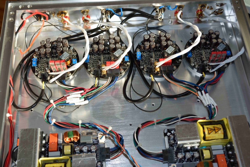

The last six pairs of caps have arrived they have been installed into the NC400. An initial listening session was completed to confirm the installation was successful in which it was.
I have not done all my wiring reconfigurations as mentioned in previous posts here, but the capacitors are Installed and the Speaker Posts Have Been Replaced for Direct Silver Wired wires.
The SQ of these amplifiers are significantly improved by these two modifications. In a nutshell the highs are significantly more extended the mid range is improved and the base has tighter control. I cannot detect any elements to the music heard which is not improved over the stock unit so I'm very positive about this modification that the sound produced by the NC400 is better than the stock unit.  If anyone has any interest, I will be happy to provide further feedback. Drop me a message and I will reply as soon as able.
I will post new pictures sometime in the near future. This will show four NC400 modified.

All done now here is the 4 NC400 with the modified caps and the connecting power loom outside the case. At a latter time I may put in a wall inside the case and still to fashion a cover beneath the case to contain the power connecter cable.
Oh yes, the SQ is way better than the stock unit, I'm confident to announce that fact here, there is no negatives heard the sound is better in all respect compared to the stock unit..
