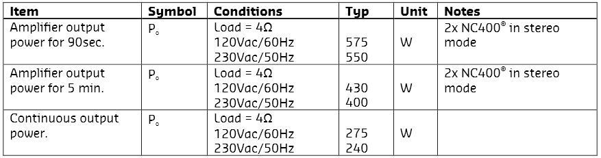

The SMPS600 Data Sheet does mention 230VAC/50Hz in the output power chart.

Cool, thanks!  I missed that.  Still, you'd think this should appear with mains supply specs.

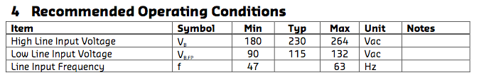

The plot thickens.  There isn't any 63Hz mains grid that I know of.
That's just the design range.  47 to 63 Hz.
duh! Sorry!   :duh:  I missed the minimum spec!  OK, just delete this whole thread maybe.  In my defense, it's more intuitive to place min next to maximum.  And this info is missing from the power supply box!
