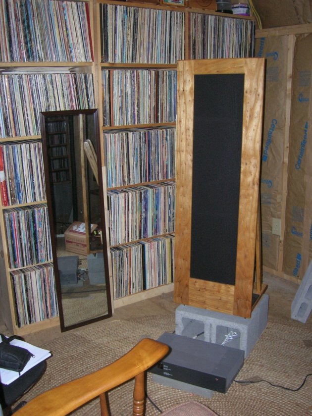

The latest (maybe last) version had me cutting one of the big 4 foot by 6 foot FRT panels in 2, making two 2 foot by 6 foot panels to use taming the front wall early reflections.  Then I realized that a simple way of dealing with the side wall reflections was to toe in the speakers so that the side wall reflection seen in a mirror is of the speaker edge on.  That way, since the edge is a null, there is no side wall reflection that makes it to the listening position too early.  After some more trial and error, here is the room layout which, in not just my humble opinion, sounds a whole lot better than any stereo has a right to sound in a 11 foot square space.
Here is a photo of the left MMG and the mirror view of the edge of the MMG from the listening position (LP):

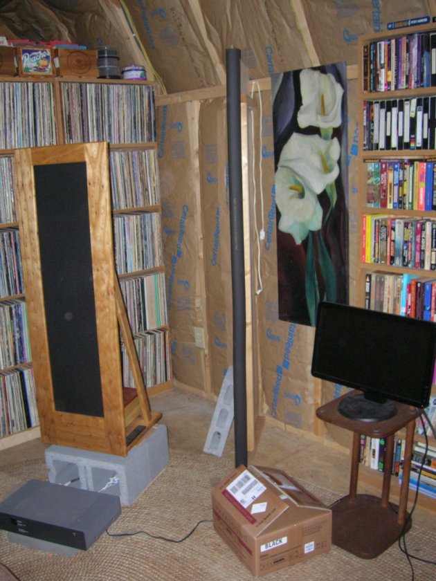

Here is a view of the left MMG and the mini-FRT.  Note the black pipe insulation tube I use on the edge of the FRT to handle any edge diffraction issues):

Compared to the prior iterations which made the shed feel like the interior of a Bose radio, this is easy to live with... and dirt cheap to try!  Just make sure that the toe-in places the null as shown in a mirror from the listening position, and that the FRT blocks and diverts the back wave so it takes at least 10 milliseconds (an extra 11 feet) of travel compared to the distance from the speaker to your ear to arrive.  Even though the floor plan makes it look like the rear wave reflections could get to the LP before then, I believe that th diagram is off due to scaling.  Using the mirror, I confirmed that the rear wave is aimed into the corner, where the reflections take many bounces before escaping, thereby lengthening the time.  There is bound to be more than one configuration which will greatly reduce the comb filtering effects in your room, which can affect the phantom center in a bad way.  Which is the whole point of using FRTs.
