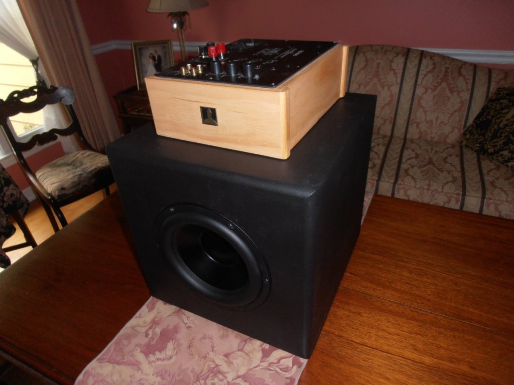

I'm using small 8 inch subs to augment the bass with my H-frames. Just completed the P.E. 8 inch Dayton with flat packs and really like what it adds. I have the Triska on the other side for the moment. I primed then painted the MDF Baluga matte black ( Behr Ultra sample jar ) using a small roller. Flat paint applied with a small roller shows less imperfections.
I drive the Dayton sub with one of the Yung SD300 plate amps which I freed up. One Yung driving the Alphas in 4 ohm parallel equals the same power as two driving them in 8 ohms but even at that 150 watts per side is really over kill for the efficient H-frame Alphas.

@Poultrygeist, I like your idea for a small bass helper. How do you compare the single 8" pictured below with the triska?

The 8 inch Reference Dayton has more authority than the Triska and with the 300 watt Yung will shake the walls, not that I ever would. The efficient Triska is happy with a less powerful amp.
Either work nicely with the H-frames.

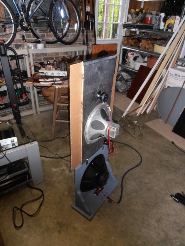

Some progress this evening. Got a few hours to work on the new baffles. Decided on the 3" u-frame after simulating in the edge. Should be able to run without any baffle roll-off compensations and mate well with the h-frame. Tomorrow I need to make 12 1" cleats so that the MAs have 1.5" of material to screw into (prob. overkill but oh well) and also mount the metal l-brackets to hold up the baffles. I will prob do a 12" x 1" cleat so that the metal l-brackets also have 1.5" of material to go in.
Then I get mount up the MAs and start breaking them in while I work on finishing the h-frames.
Bad picture in my garage. Full ranges are off-center by 2" in both x and y dimensions to minimize the dipole peak and dip.

Don't want to steal your thread but since you seemed interested, here's the Zenith wide banders in a cobbled together baffle. Butt ugly but sound is pretty good. The Zeniths came from an open backed tube phono cabinet and I see them on ebay for low prices.
