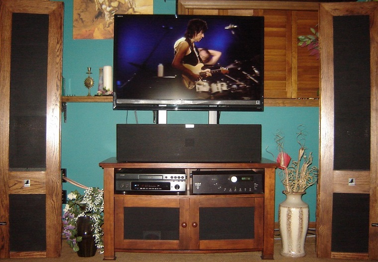

John of Magnestand has very strong opinions of his product...not surprising. From what I've read, his customers are very satisfied, love the sound and new look of their speakers. In the right room decor, they probably look better than stock Maggies. Not defending here, I haven't heard Magnestands myself. I could think of many other speakers that IMHO, are easily tackier in the "looks" department. My self-moddded MMGs probably qualify.... :lol:
Of course there's a lot of info out there for you to mod 1.6s yourself, even with passive or active bi-amp-ping. Haven't read of too many 1.7s modded yet, just of folks on the Audiogon forum changing out crossover components. Once someone figures out how to deal with the 2 and a half way aspect of the 1.7 design, I imagine the flood gates will open. I will say that I feel the comments PG makes on his site regarding the 1.7 are overly harsh, and if Magnepan were indeed greedy and cheap, then they, like so many others, would have shipped their production overseas.
I diyed the hardwood frame mod on my MMGs, not really for dampening, but structural improvements. Went from the stock 3/4" MDF frame thickness to a 1-1/2" poplar frame thickness (same thickness as stock MG12s). I found the Razor mod on the pole pieces more apparently helpful in the driver dampening department. BTW, PG, along with others including member Davey here, helped me with my design, I'm thankful to all. :thumb:

   That razor mod looks very affective. Makes one wonder why Magnepan does not use same or similar construction. Maybe when measured not as affective vs cost.
