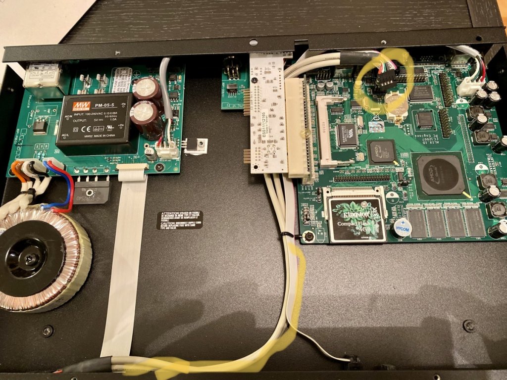

cprem
  • Posts: 5
Hi Guys,
I had the same problem with BDP-1 all of sudden one day I power up my unit wait almost and got error message on my display. I opened up cover on my BDP-1 first I re-seated the CF card powered up and no go, then I re-seated the flat grey 10 pin ribbon cable and once again powered up still showing error 9. I noticed the that grey 10 pin USB cable which connect to the two front USB ports was not seated right on the motherboard I re-seated the plug and bingo BDP-1 booted up fine and no error 9. Subsequent power ups the BDP-1 again came up with error 9. I disconnected the USB cable on the motherboard side and problem solved no more error 9 on subsequent power cycles.
I have emailed Chris to send me a replacement USB bus cable.

zoom25
  • Posts: 1000
Replacing the CR2032 cell battery fixed this very issue on my BDP-1.

zoom25
  • Posts: 1000
The past year I did have some trouble with Error 9 and initialization after power errors (03 or 05). Sometimes, the unit wouldn't boot with the USB  drives plugged in, but as soon as they were unplugged, it all started working fine after a few retries. This year it got to the point where multiple reboots after minutes and hours and days, with or without USB drives plugged in or ethernet cables plugged in or rebooting my DACs made zero difference. Error 09 each time. I got a Torx T8 and replaced the CR2032 battery which seems to have fixed the problem.
A note to those changing the cell battery. Pay attention to the +/- sides of both the battery cell along with how the +/- flapper pins are located on the holster where the battery is inserted. One pair of pin makes contact with the bottom side, while the other set of pin makes contact from the top.
