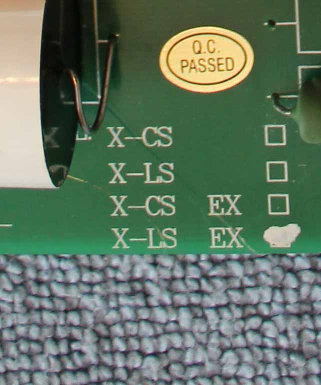

Are you using stock crossover boards on the you X-CS Encores? I am looking for outside dimensions for it, and the hole spacing, so I can pre-drill the mounting holes.

Re: My X-CS Encore Build
« Reply #26 on: 18 Oct 2014, 05:52 pm »
I THINK the CS uses the same board as the  X LS Encore
-jay
-jay
I don't know if the CS crossover was able to be squeezed onto the same physical size board as the LS but the actual crossovers for the LS and CS are different.
Mike
Oops, just saw your picture.  I didn't pay attention to that part of the board. I guess they are the same physical size.
Mike
« Reply #29 on: 18 Oct 2014, 06:22 pm »
Just thought it would be the same board  being that  it has the CS label on it   :scratch:

Danny Richie
« Reply #32 on: 19 Oct 2014, 09:10 pm »
Hey guys,
All of those crossovers are different but they did share the same circuit board.
