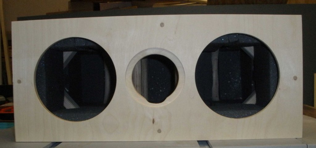

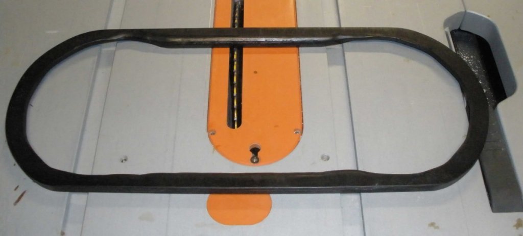

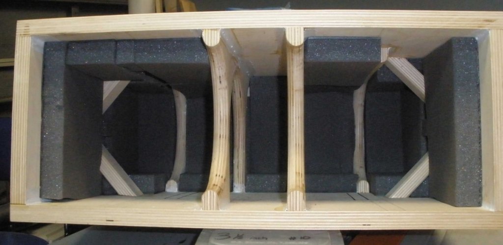

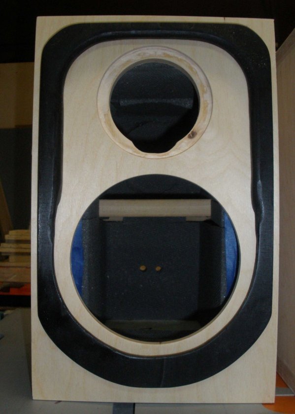

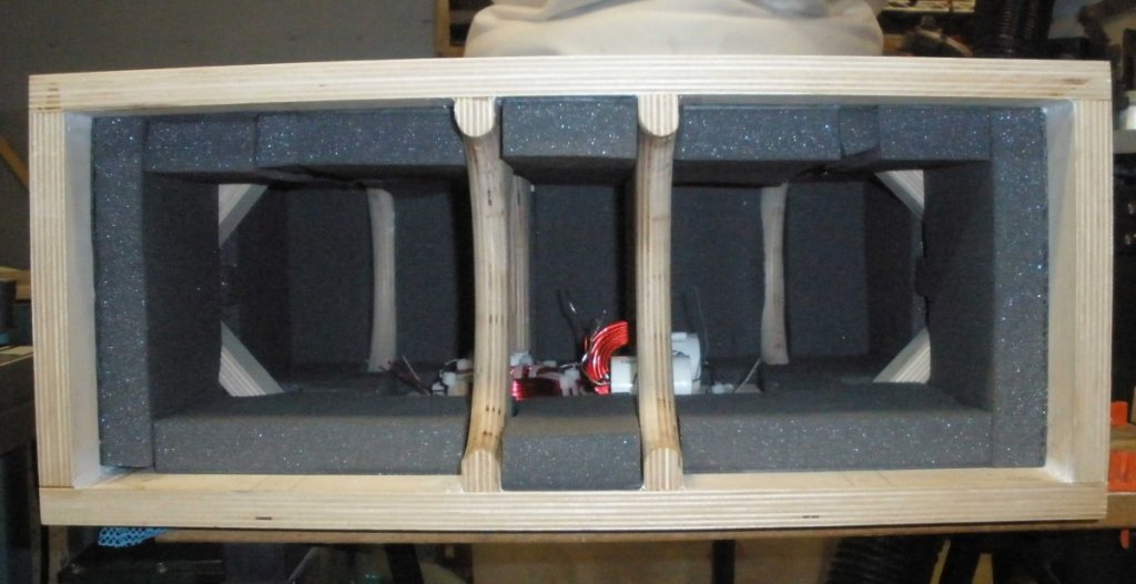

I've got most of the NoRez in the CS Encore. After squeezing it around the Brace A's in the LS's I tried something a little different. I marked where the back edge of the Brace A's would be then installed the NoRez from the back up to that line. Then I installed the Brace A's. The NoRez is not complete in the following picture. I need to finish the crossover and dry fit it before I install the rest of the NoRez.
Mike

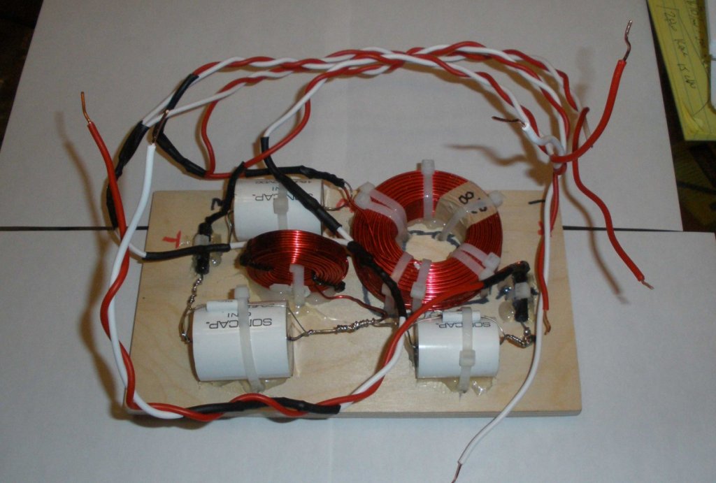

Moving right along on the X-CS Encore, here are some pics of the crossover:
and with the crossover dry fitted and the rest of the NoRez installed

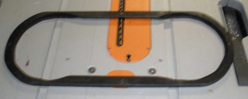

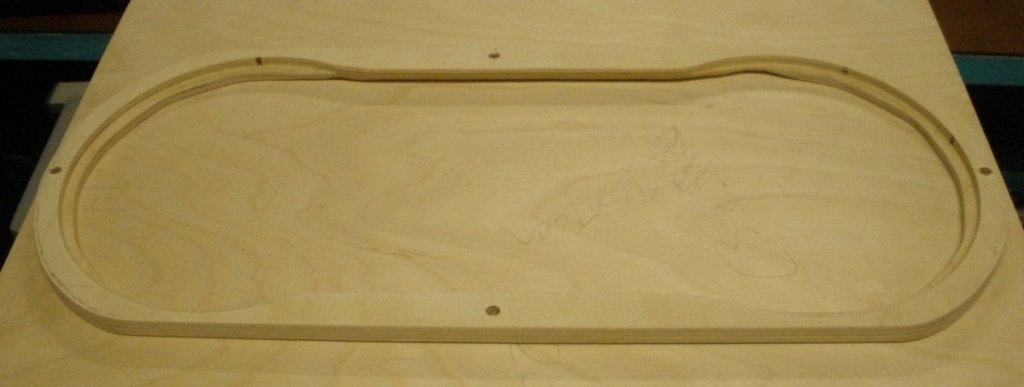

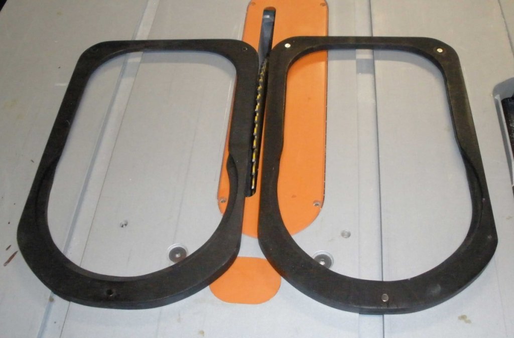

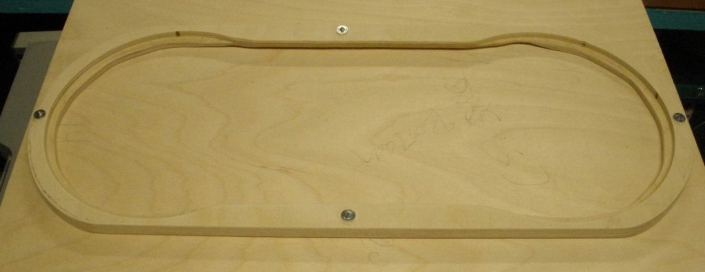

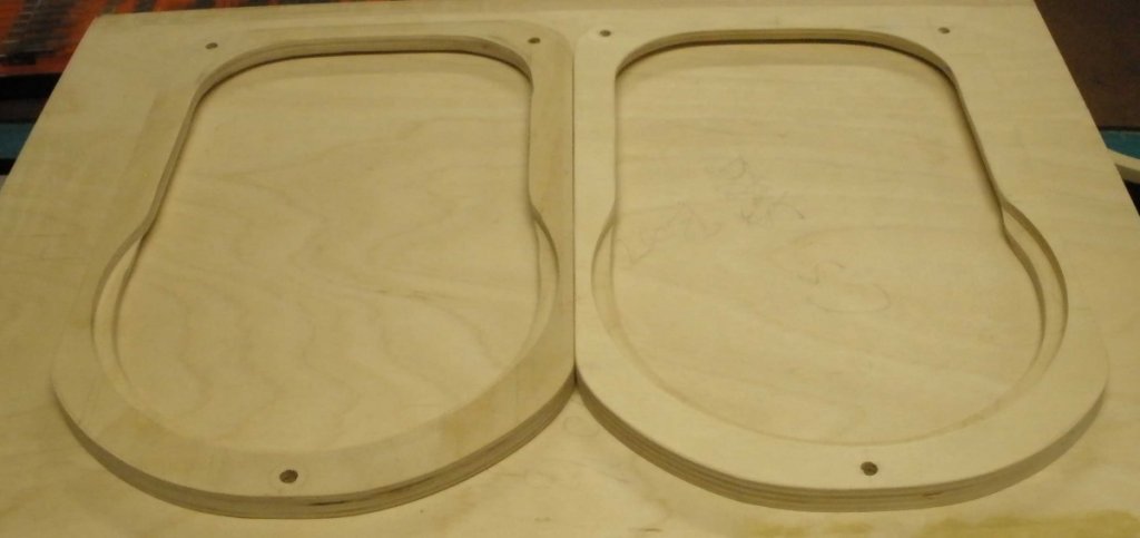

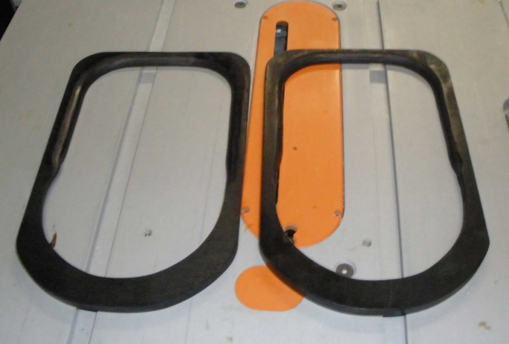

Here are some pics of the grill frame:
Here is the frame with holes drilled for the magnets
Here is the frame with dowel points in the holes to mark magnet locations on the front baffle
Here is the grill frame with the magnets glued in and after two coats of ebony stain

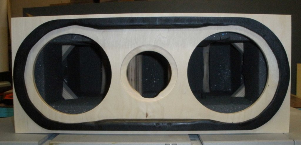

 Here is the front baffle with the magnets installed
and here it is with the grill frame on the baffle
More to come,
Mike

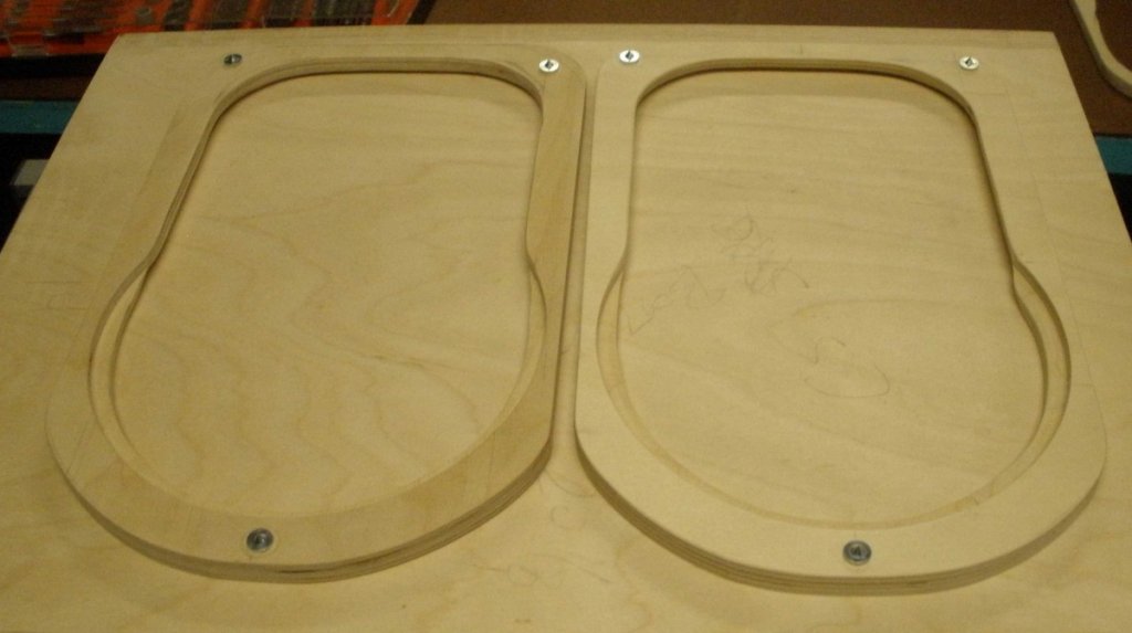

Here's the grill frames for the X-LS Encores: with magnet holes drilled,
With dowel points installed
Grill frames with two coats of ebony stain
and here is an X-LS Encore cabinet with the grill frames on

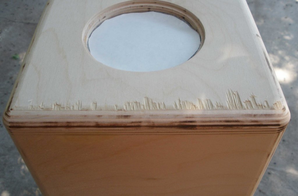

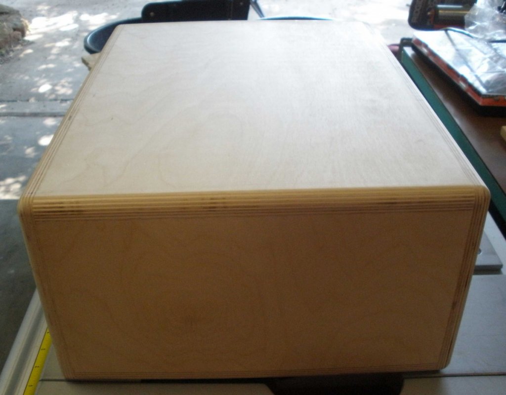

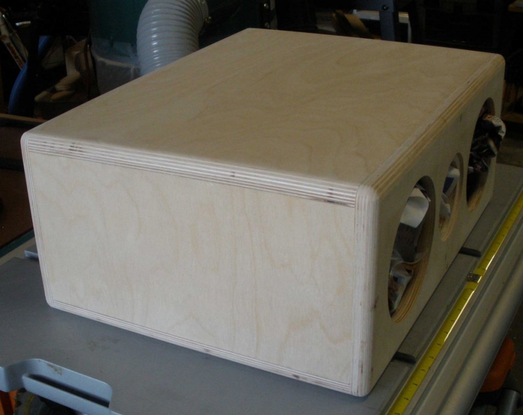

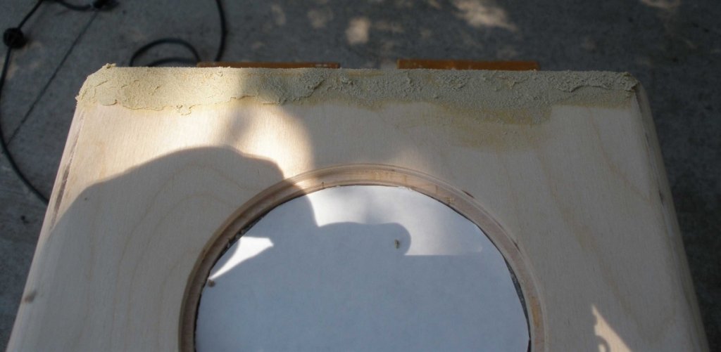

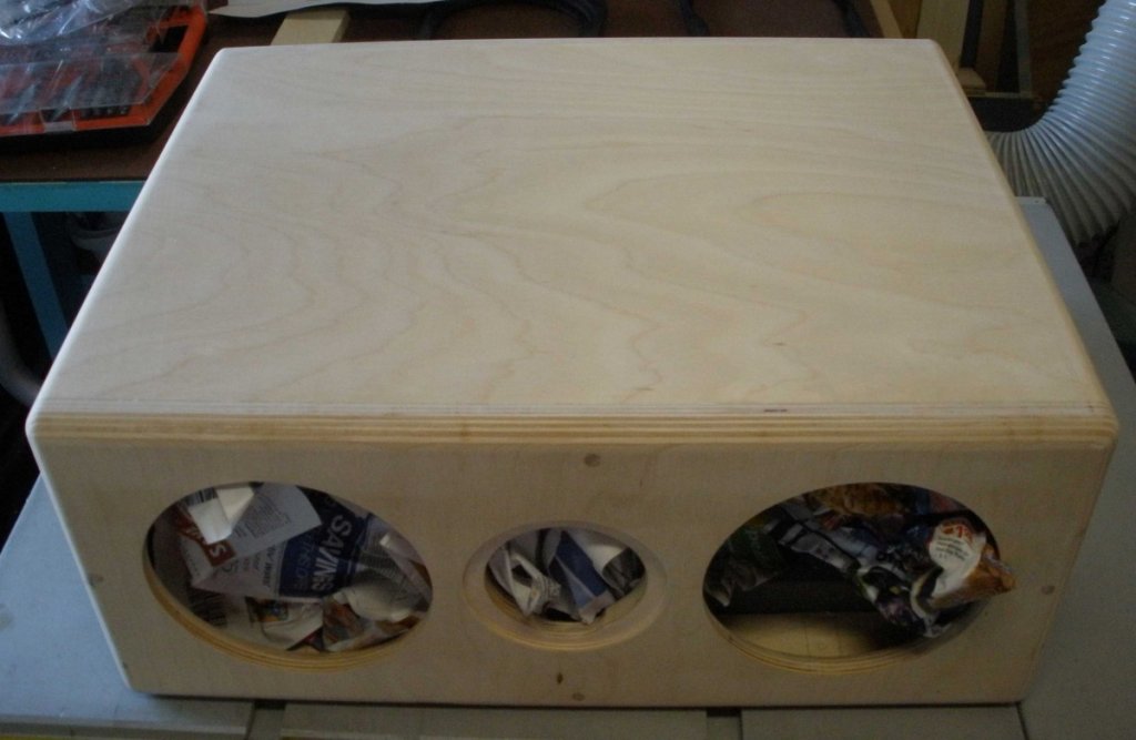

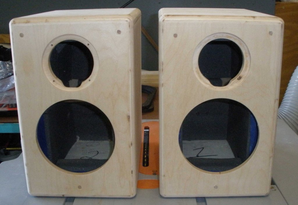

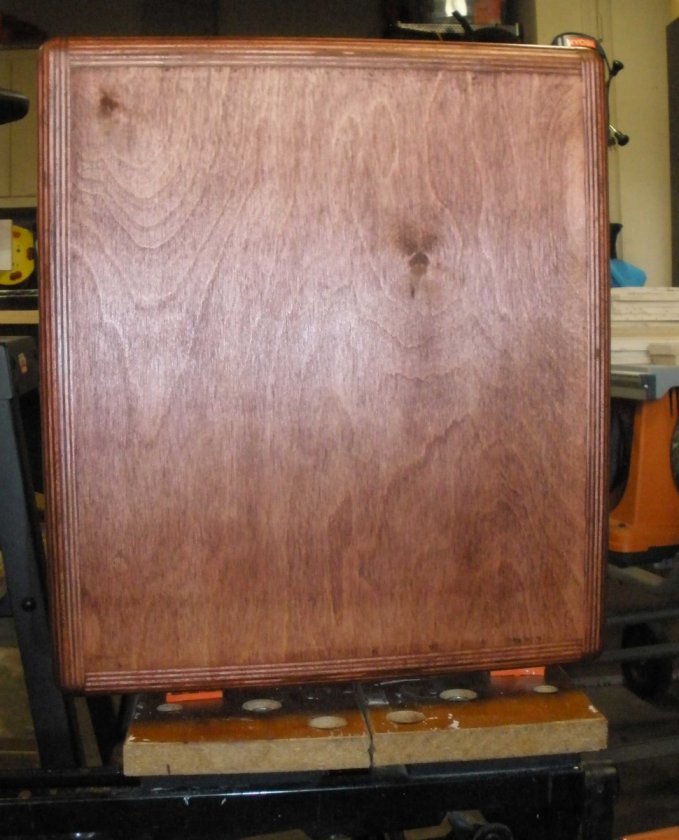

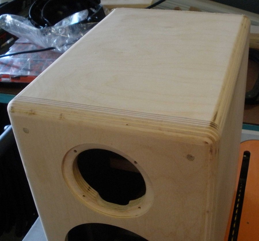

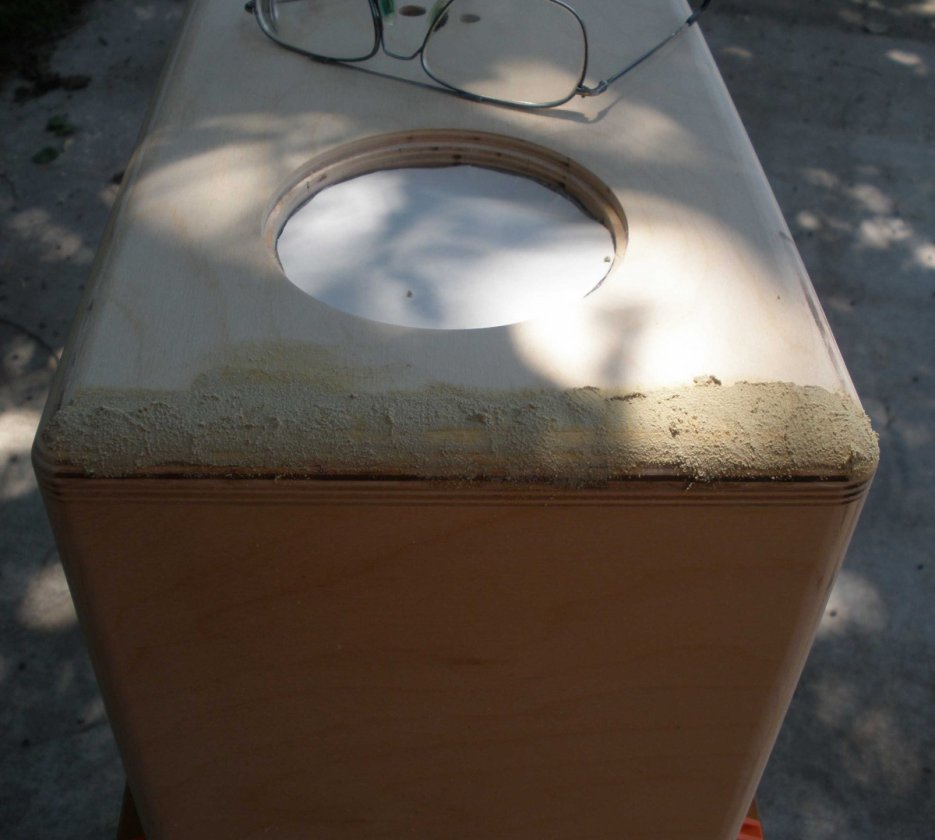

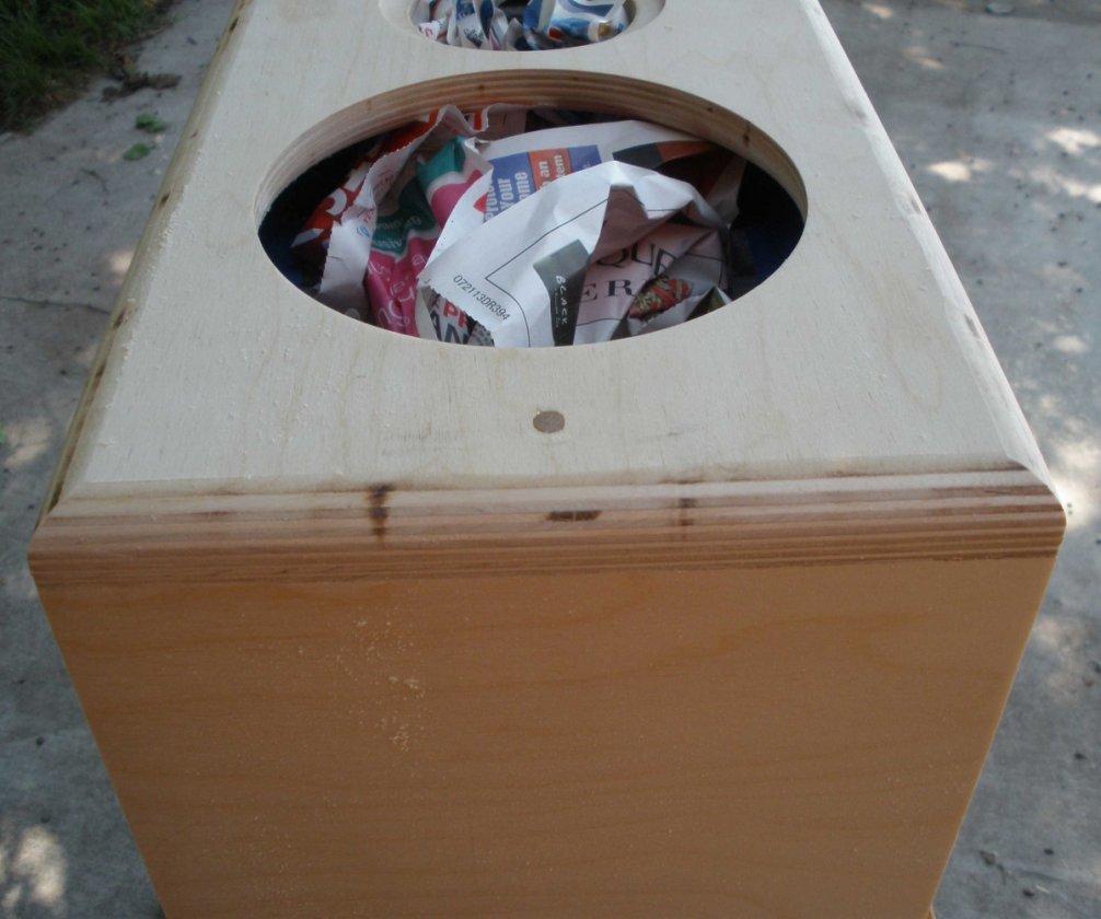

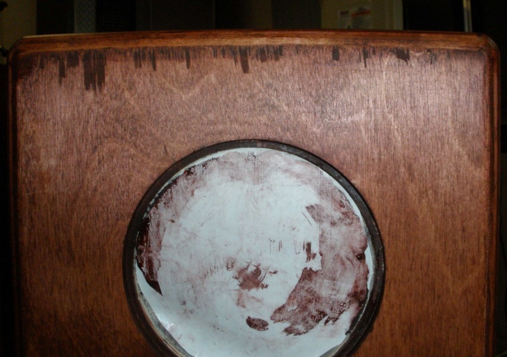

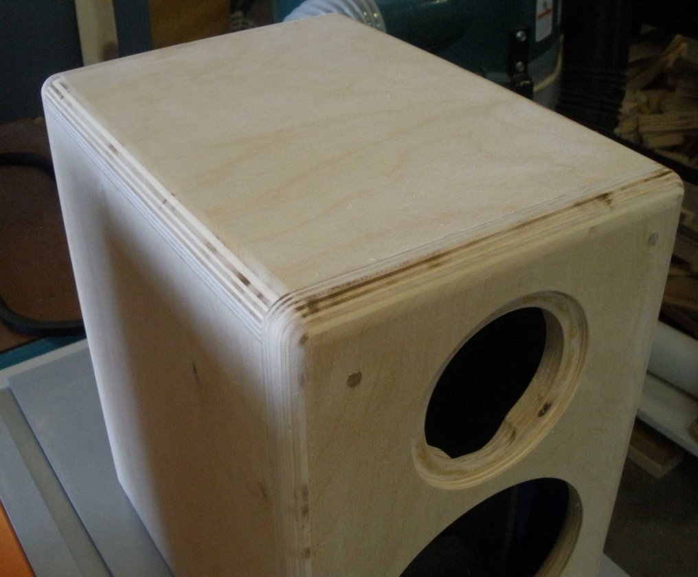

I have finished sanding and putting a 1/2" roundover on all the edges of the X-LS Encores and the X-CS Encore. I practiced doing the roundover on the MDF cabinet I built specifically for practicing new cuts. Using a Workmate to clamp the cabinet and a hand held router to cut the roundovers worked flawlessly. However, when I tried cutting the round overs on the Baltic Birch cabinets the bit tore out the veneer.
I wasn't about to build a new cabinet so I used wood filler to repair the tear out
To prevent additional tear out I tried back routing first. This solved the tear out problem but results in an uneven feed rate. Sometimes the bit skips and runs while other times it hangs up and burns the wood. Routing back over the edge in the proper direction cleans up a lot of this but even with a fair amount of sanding some burn marks remain. Therefore these cabinets are going to have some unintended distress marks on the edges.
And the X-CS Encore:
I have finished final sanding and am now ready to stain the cabinets.
Mike
mpauly
Re: X-LS Encore & X-CS Encore Build
« Reply #71 on: 2 Aug 2013, 06:33 pm »
Looks like youre already done and they came out pretty nice.  Hopefully that filler will take the stain you plan to use evenly and not stand out like a sore thumb.  Might make sense to do a test board with some gouges filled with the same filler to see how it looks with the stain/finish.
Qucik question, did you do the 1/2" roundover in one pass?  Sometimes doing it in two passes (the first one with the bit only half way down and the second pass at full depth) can help prevent splintering.

It is a sustainable filler but it does stand out like a sore thumb. Luckily it is on the back side of the cabinet.
Yes I did it in a single pass. I thought of multiple passes as an option after I was done. Another possible option would be to start with a 1/4" roundover then progress up to a 3/8" then the 1/2".  This would be better with multiple routers then I wouldn't have to keep switching the cabinets out. I currently have two routers, a smaller trim router which would be fine for the 1/4" roundover and a regular size router. But that leaves me short 1 router. I was wanting an excuse to get a new plunge router with the dust collector built into one of the columns  :wink:

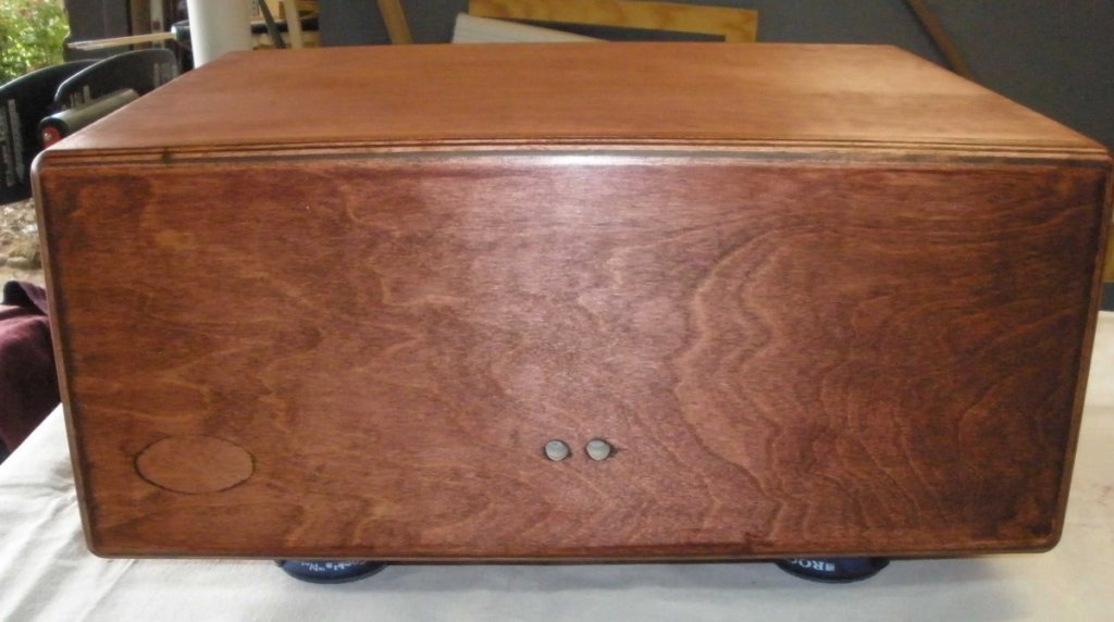

I have the stain on all three cabinets now.  It has not turned out as dark as I wanted. I'm thinking about adding a second coat of stain tomorrow after the first one has completely dried.

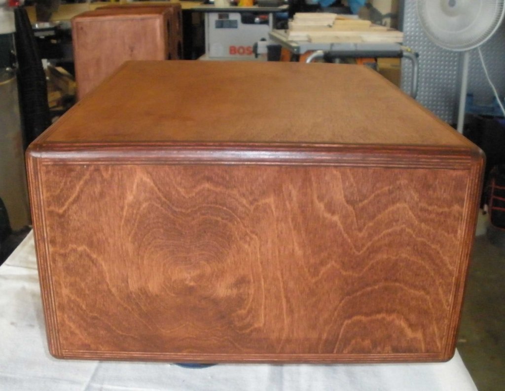

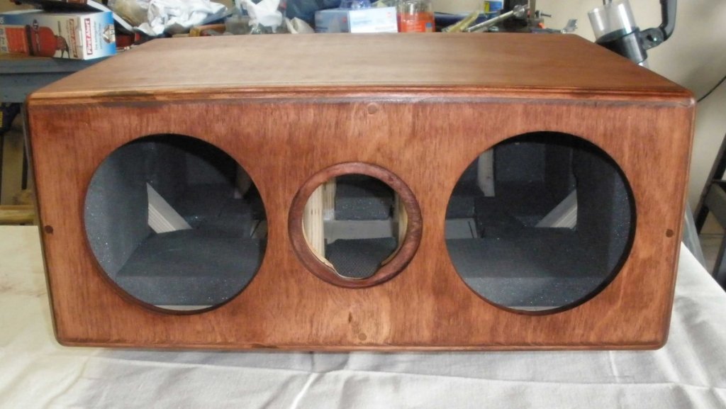

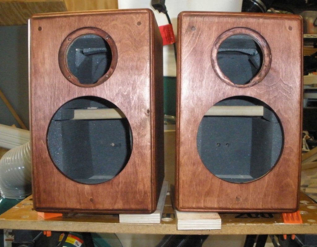

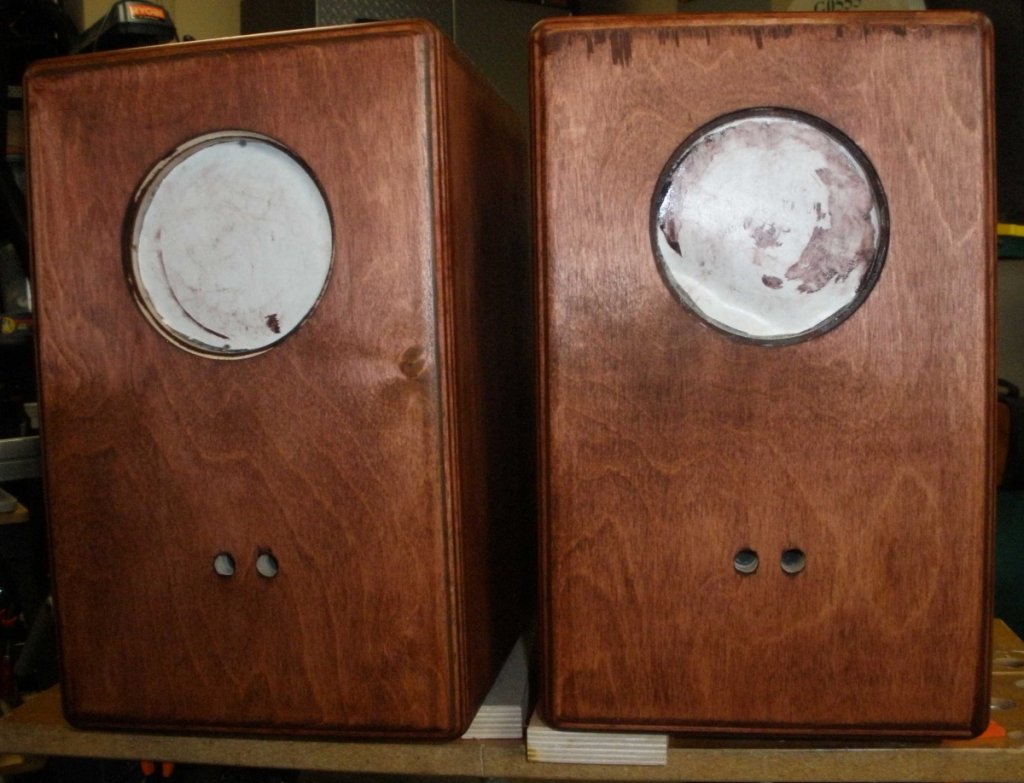

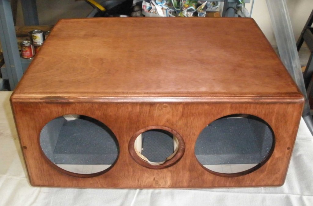

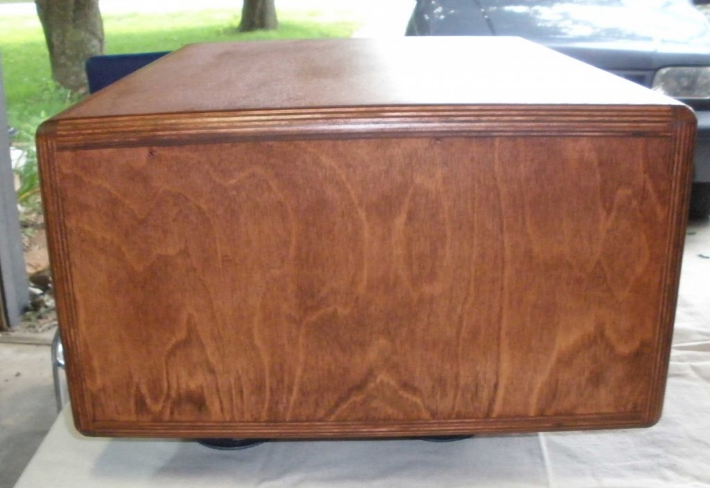

Here they are stained. first the CS Encore
And here the LS's are in the background
Now for the LS Encores, yes the repair shows but at least it is on the back
However the fronts and sides look better
I'm caught up for now
Mike

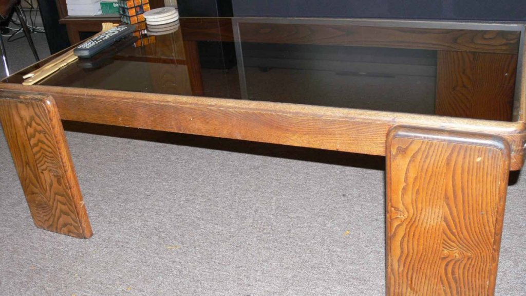

I can't say  if   using the  wet/dry  paper methoud will help at this point but I would say  it  is  worth the  attempt   as it will not hurt  .   If you  apply  2 or three coats to  raw hardwood ( I  DID sand    very smooth  before applying and did not use any pre-stain)      and then  "buff "  with ta soft cotton   rag after,  you will probably find  you  don't even  need a top coat,  it comes ouot very rich and you can actually get a  pretty  glossy finish depnding on how much you  "buff"..
I'll attach a pic of  the tables I did,  remeber though, these are  close to 30 years old now and haven't been  rubbed/buffed  in   many years
When you are applying   , really   sand that  stain in ,  till it starts to become noticably thicker  before  wiping  off the excess.  I think you  might be surprised   by the results
I still suggest trying it on  a  piece of scrap before proceeding just to make sure  you  like   the results
