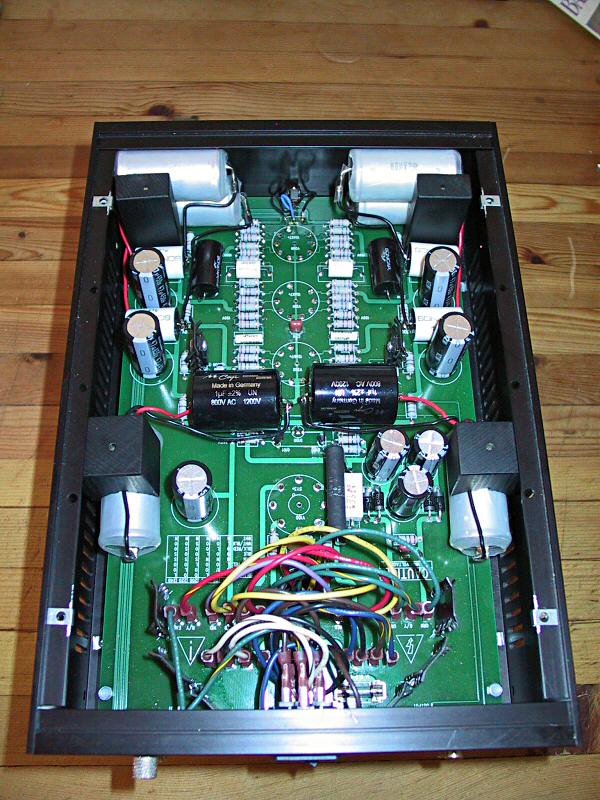

You can use a lower profile box but need to drill larger holes for the tube sockets.
The Cornet2 circuit board is mounted upside down so there is a limit how short the box can be, it depends on how much stuff you pack into it. The Mundorf caps need 1-1/2". If you include the FT-3 bypass caps like I did (highly recommended) then you need the standard size box (or a wider, longer one). Although it is hard to tell from the photos, the rectifier tube is only 1/4" shorter than the transformer so you wouldn't gain much by relocating it.
Wayne

So the tubes and transformer could all be inside of the box? I wonder if anyone has built one like that?
http://www.audiocircle.com/index.php?action=gallery;album=1848
I really didn't care about whether it would "slide in a rack" or not.  I wanted a very solid, enclosed, quiet build. The phono pre is dealing with minute signals.   I  also wanted ample room to modify.   The extra real estate has allowed me to replace some of the PS electrolytic caps with PIO's.  IMO, mechanical integrity, isolation and damping are as important as the components to build up the board.
It depends on how far you are going to go in modifying the layout of the power supply part. Lets just imagine what we can do:
1. Divide the box into two compartments: signal and power supply.
2. Move ALL power supply circuits (except LED driver circuit R104-R108, Q100-Q101, D100) from the PCB to the power supply compartment. It allows us to save the height relocating the rectifier tube also (and you have the option to mount it horizontally). In doing so we also move all power AC to the isolated compartment. All transformer wires should go directly to corresponding circuits (input IEC socket, rectifier tube, bridge...) not PCB.
3. The high voltage part (R100-102, C101, C103, V100) is very simple and can be easily made point-to-point with only moderate precautions like make ground wires short and star-connected. Of course you can also save the C103 on the PCB.
4. The heating voltage part is simple too, but I'd replace it with regulated one. There are a lot of PCB-based and point-to-point layouts. The only problem - 6.3V AC is not enough for common regulated PS, so you have 2 options: either use LDO regulators or add small-power 9V transformer and common regulators. The regulated power supply gives us more flexibility and stability and eliminates the need for selection the right value for the power resistor (R223).
