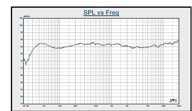

I watched the F. Toole lecture , too bad it only lasted an hour, he was just getting warmed up. : )
I also follow these other characters, in no particular order , S. Olive, E. Geddes, A. jones, P. Barton etc.
It was the "Home Theater Geeks 263" interview with Andrew Jones that prompted my tweeter query.
Andrew found a problem in his prototype tweeter and corrected it his latest production ELAC speakers.
He noticed his prototype had a 3db dip in the measured response at 15KHz.
Very similar to the latest NRC measurements of your  Mini A's.
http://www.soundstagenetwork.com/index.php?option=com_content&view=article&id=1406:nrc-measurements-bryston-mini-a-loudspeakers&catid=77:loudspeaker-measurements&Itemid=153
Andrews fix was to remove all irregularities around the dome ... Shawn

Hi Shawn
Yes I was aware of that but as I have said before you are not listening to that measurement as it is one point in space with a microphone. You are listening to the Sound Power and that small deviation is irrelevant. Thats not to say you do not try to improve things.  We have been using a new tweeter now for a while in the T Series and it does reduce some of the effects that were measured in the older tweeter
james
