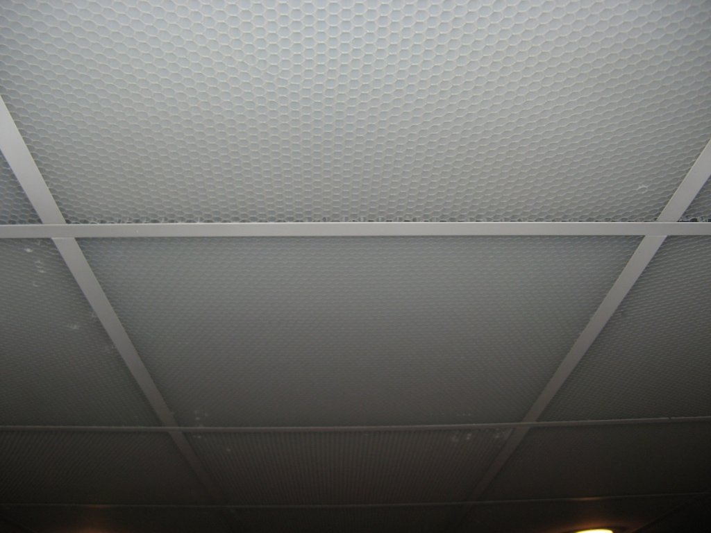

Re: Basement ceiling muddying bass performance?
« Reply #22 on: 27 Jul 2013, 07:31 pm »
See my reply to the post by "Jackman" in mid may, on basically the same subject.
Attached is a picture of my custom honeycomb ceiling.
Dave.
