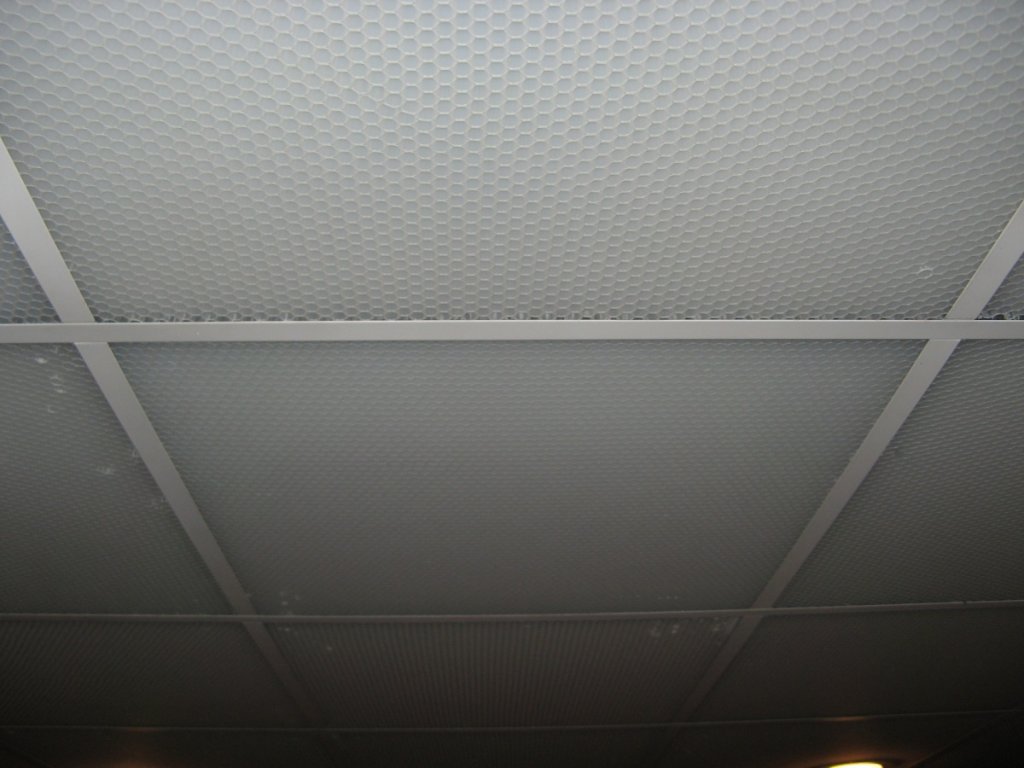

Re: Ceiling tiles...doh!
« Reply #8 on: 27 Jul 2013, 07:04 pm »
I went thru this also.
The standard pressed paper ceiling tiles would move/vibrate, and I believe muddied the bass.
I changed all the tiles to the light weight fiberglass versions.  No help.
Next I changed to hand made drywall tiles.  But even these very heavy tiles move.
Finally, working in a composites industry, I special ordered panels of Polypropylene honeycomb, from a company called Plascore.
They made the panels to my spec's. after which I cut them into 2x2's, using them as ceiling tiles.
These panels have no surface, you can look straight thru the panel.
But they are 1.25" thick, so on even a minor angle they look solid.
Advantages I found:
I got one additional foot of ceiling height, which opened up the sound and the bass.
Eliminated panel movement, and flex.
I believe this helped with bass response, making it a bit tighter.
Eliminated ceiling reflections entirely. This helped with clarity.
Cost for 14x23 room.  $500.
Picture attached.
