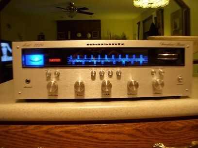

May I recommend the Marantz 2220....they are wonderful and can drive a bus:
http://www.ebay.com/itm/VINTAGE-MARANTZ-2220-RECEIVER-WITH-LED-UPGRADE-SERVICED-BEAUTY-/261212601343?pt=Vintage_Electronics_R2&hash=item3cd17bfbff
