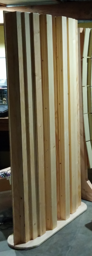

Hi Jim,
I just saw your post (haven't come here very often in the past year), sorry for the late update.  I've done several similar wood diffusers since then, including floor standers and a rather unique focusing diffuser arrangement (sounds like a contradiction, but isn't -- that one is the subject of an article soon to appear in Linear Audio magazine next year).
Bill
There is more about these at http://www.diyaudio.com/forums/everything-else/269366-making-easy-diy-depot-sound-diffuser-panels-step-step.html
jimtranr
Nice work, Bill. And appreciate the detailed description and explanation in the link.
Jim
Rob Babcock
  • Posts: 9327
That looks great, Bill! :thumb:
bwaslo
  • Posts: 60
    • Liberty Instruments
Thanks!
And happy 2016, everyone.
For anyone near a big hardware/lumber store in USA, that diffuser is almost silly easy to make, nearly all the wood pieces can be bought cheap and already in their needed dimensions, and need only a nail gun (or even hammer and nails) to put together.  Biggest issue is whether you or your Significant Other can tolerate something that large in the room.
gab
  • Posts: 627
Thanks Bill! I was familiar with Tim Perry's work at Arqen Sonic. But these look amazingly simple and easy to construct. On my list... Happy New Year to you
gab
rand
  • Posts: 7
Thanks!
it might have a better WAF if it is covered with cloth - ask her what color and texture she prefers...
