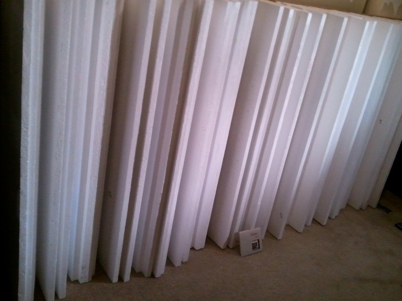

medium jim
Re: first diy diffuser build. QRD type for Magnepan system.
« Reply #114 on: 17 May 2013, 04:22 am »
60db is a mere whisper, less than normal conversation.
Jim
Rclark
« Reply #115 on: 17 May 2013, 05:06 am »
Yeah I know I've mentioned how my system works well at low volumes before but now it's all even clearer. It sounds far louder than it is with these in place, especially the bass now, apparently, not measured.
Almost done. Been taking my time with these last two. The inverse panel is slightly more difficult with more very low walls meeting very tall ones.
Rclark
« Reply #116 on: 17 May 2013, 11:37 am »
Oh boy am I tired. Stayed up late finishing these.
My room isn't quite ready for prime time and I need a better camera for that, but here's a shot of the full diffuser. As you can tell, it's monstrous.
That's John Coltrane's "Giant Steps" for size reference, CD. Well, about to put on something relaxing and pass out.
Next up for these will be trimming the tops and sides, sanding, filling any cracks with some sort of hardening putty I guess, primer and paint. Once all that's done and I have a better camera I'll take a proper photo of my room.
They are 3.5 feet behind my speakers by the way, and nearly extend completely wall to wall.

Rclark
« Reply #119 on: 18 May 2013, 06:22 am »
Here's a better perspective of the raw, unfinished build, next to my right speaker. Am loathe to take room pics though until the room is finished and I have a better camera. This one simply does not capture the color and details in my speakers. and it's fuzzy.
