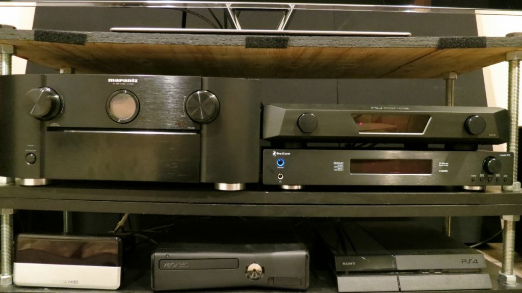

Thanks for all the feedback, I decided to try one in my system.  Will see how it does vs an Outlaw 975 and Marantz AV7005.
« Last Edit: 16 Mar 2014, 10:25 am by Gaara »
Gaara
Re: AVP-18
« Reply #75 on: 18 Mar 2014, 12:52 pm »
Well I got a chance to listen a good amount to all three this weekend, and the Marantz and Outlaw will soon be looking for a new home.  The Nuforce bested the other two for sound quality and has all the features I need.  Will give a little more detail tonight or tomorrow.
