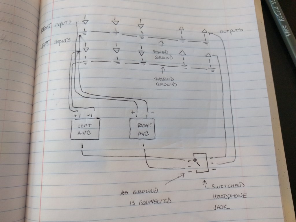

Can you post a schematic of how you have it wired up? Your description almost sounds like your ground connection is broken.

Here's the best way I could draw the schematic:

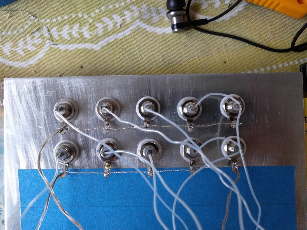

I only have the first input wired to the avc's because I could not get the inputs to wire up to the Grayhill rotary switch I have installed.
The outputs from the avc's are wired to a switched headphone jack before going to the outputs. Like I wrote earlier, when the headphones are not inserted and I run the avc to the tube amp everything works fine.

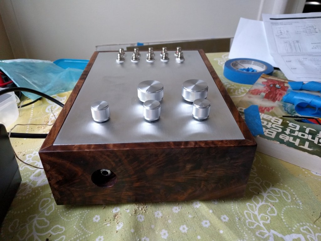

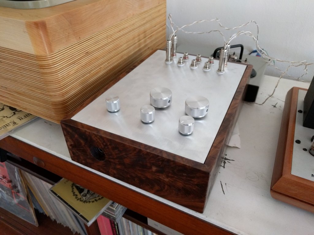

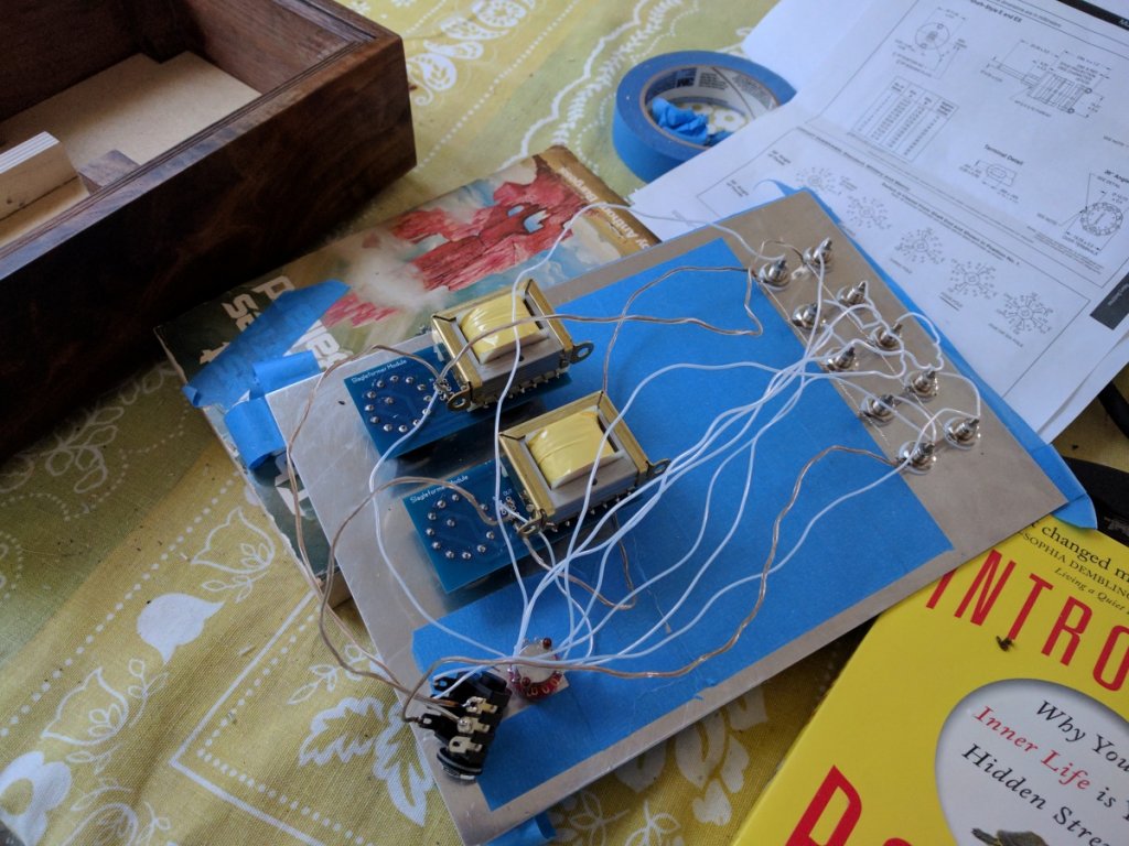

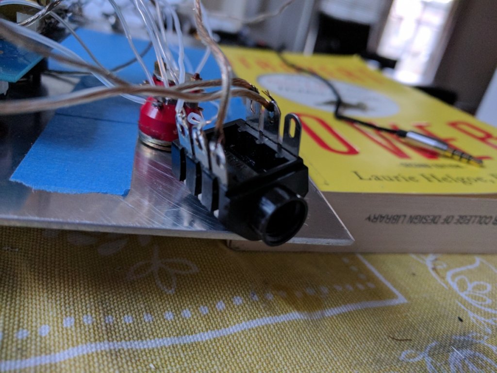

Here are some photos of the case I made and some internal shots:

Um... you need ground on your headphone jack. Otherwise you're effectively bridging the L/R channels through the sleeve of the headphone TRS plug and what you're hearing is echo because your main signals have effectively cancelled out (which is also why turning up only one channel sounds louder, because then you're only listening to one side-ish and they aren't cancelling out as much)

Where is the best place to ground the headphone jack? Do I ground from both avc modules to the one ground on the jack?
I wired up ground connections from the avc's to the headphone jack, from the headphone jack to the outputs and that has corrected the problem. MAJOR HATS OFF TO YOU ARMAEGIS!!!!!
