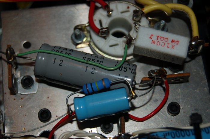

It appears that the big grey cap under the rectum fryer tube took it on the chin:

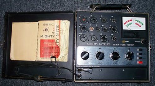

and I bought a Sencore TC154 tester which is somewhere between the seller's house and mine.
Kara at deHavilland was very helpful with an over the phone diagnosis and is sending me two caps and AVNerdguy is the fellow who steered me towards the Sencore line up.   Thanks also to doug s. for steering me to Gixen for the snipe service!

Indeed I did; a new cap (plus a spare) showed up today and it's never sounded so good.
As always, Kara was a tremendous help.  She said it's designed so that cap goes and saves the preamp from disaster in case your tube tries to fry your rectum.
