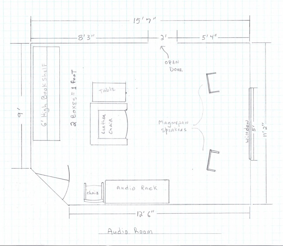

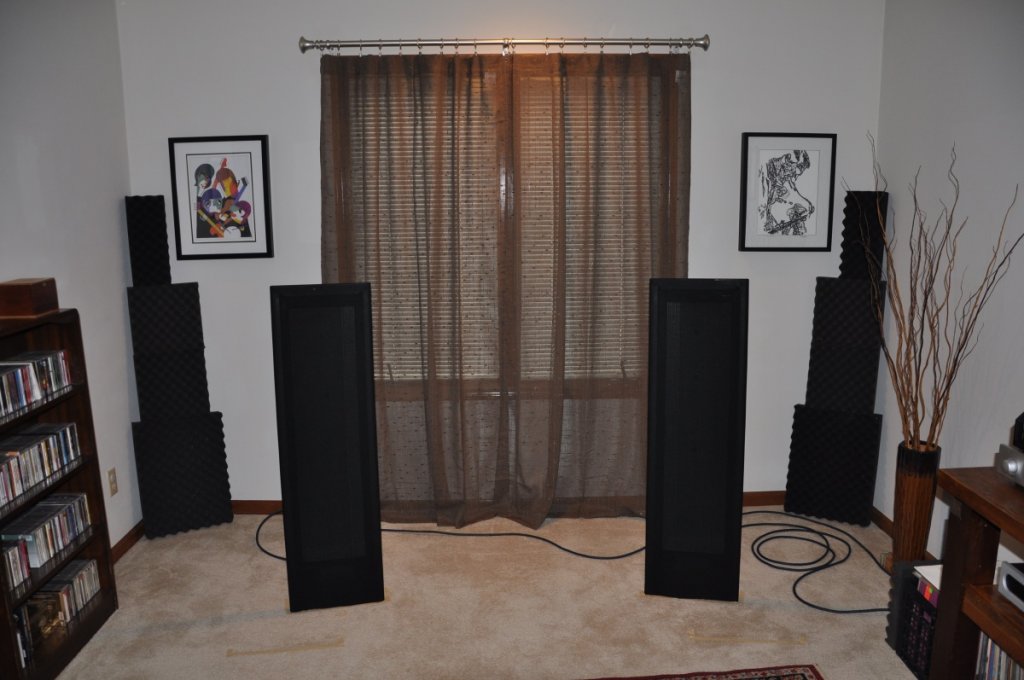

Hi John, welcome to the forum. I have the MMG's for a while now in a 11x15 room with D-Class amps and a tube preamp. I do listen relatively nearfield with no sub and I think it sounds wonderful.
I do think the they will work in your room and I would try them first without a sub, in your smallish room, you may not need one. Below is a scale drawing of my room and a picture of how the MMG's are set up. I hope this helps. Jerry
Nice set up and very close to how I envision my set up.

Love the warm tones in that room. Your MMG's look happy there.
brooklyn
Re: Small Room - Want Maggies
« Reply #12 on: 22 Mar 2013, 04:55 am »
Thank you very much, it took some time to get this system and room to
what it is, I am very happy with the sound I get from it.
Leaving the front wall behind the speakers a little sparse seems to help the sound
stage and has more of a live sound which I never thought I would say about any
2 channel audio system.
