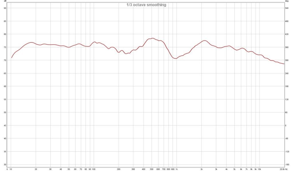

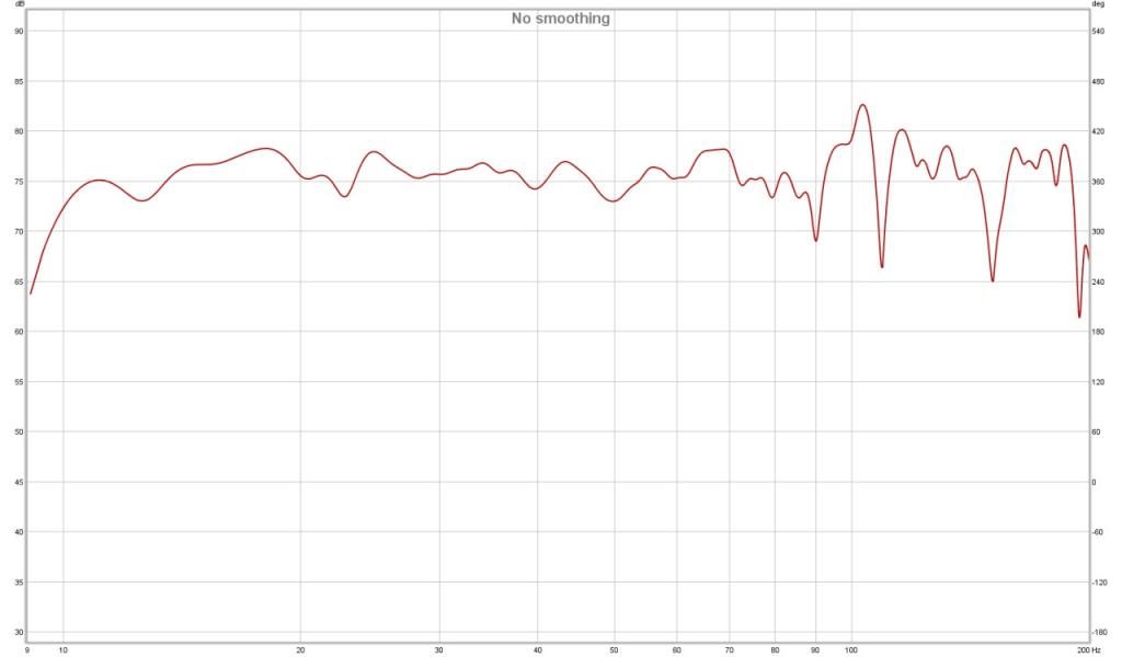

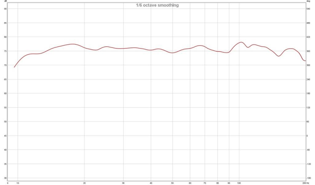

OK, I applied a 6db cut at 63Hz to my main speakers (via my AVR in manual EQ mode).  As I expected, this solved the problem.  Here are my latest measurements, all taken with my mains crossed to the sub at 80Hz, just as before (Nuance, I didn't take the measures you were looking for since things appear better now):
No smoothing applied (+/- 3db from 10Hz through 80Hz):
Same measure with 1/6 smoothing applied:
And here is the full range measure with 1/3 smoothing applied:

15-200Hz looks fantastic now - congrats!  I would leave it alone and move your focus to the area between 300 and 5000Hz.  Although, I still think something is wrong if even moving the crossover to 100Hz didn't do anything.  It still seems as if the crossover simply isn't working, but if it looks and sounds good...
I know you probably don't want to use EQ on the speakers above the Schroeder Frequency, and I am not a proponent of it, but if moving the speakers around a bit doesn't fix 300Hz-5KHz, you may want to give it a shot and see if it sounds better (it should).
