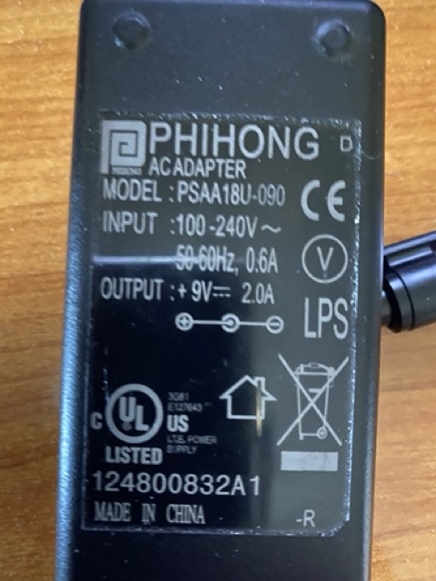

I actually suspect the power supply.  When I plug it in the power light does not stay continuously illuminated, flickers.  Started by intermittently disappearing from MM interface.  Now it never even registers with MM.  I have looked online for a power supply but dont see any with matching connector for BOT. All my request has been is: can I buy another?
I slum over on audiogon in the digital group and have always recommended Bryston streamers to people.  I dont recommend Bryston  anymore.
« Last Edit: 20 Jul 2022, 04:21 pm by jobiwon »

BOT-1 uses an external power supply.   My BDP is the Pi.
Here is the BOT-1 Power Supply.
https://www.audiocircle.com/image.php?id=241427
I see. The label says it’s 9V/2A and the plug appears to be a pin-type. I think it shouldn’t be difficult to find a replacement because that is one seriously cheap power adaptor. Quite shocking any manufacturer with high-end pretence would use something like that. Just to be sure, can you please post a pic of the plug itself? Have you tested the adaptor with something else?

The BOT 1 says 12v input

A D-SUB connector to power an otherwise ordinary computer ROM drive.
But there’s one thing I don’t quite understand – the schematic on the actual power supply clearly shows a circular plug with two poles with a plus on the inner pin and a minus on the outer ring… Did Bryston buy the power supply from a Chinese supplier and just changed the plug to a D-SUB in-house?
