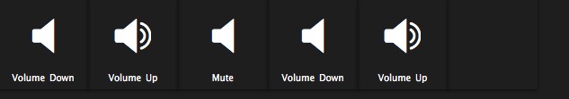

http://192.168.0.101/rm/
this it? no play commands? only volume. if its this simple and effective, why not integrate in the MM interface, would be really wonderful.
Volume control in Manic Moose is still relatively new, it'll come eventually, but lots going on

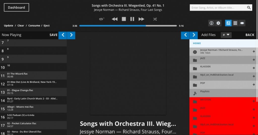

Re: BRYSTON BOT-1 (Bryston Optical Transport)
« Reply #406 on: 4 May 2016, 07:52 am »
USB hub is powered on/off when the system is powered, hope that will suffice.
well, apparently it was not..... had a power button for itself, automatically going off when powered off. Since it has to be powered on manually, and i had it hidden buried deep into the back of my setup, that wasn't so comfortable.
Changed it for the Kensington K33980EU 7 port USB hub, and it seems to work even better. Drives are immediately (read quicker) recognized. The other hub displayed all drives fine, but i experienced some strange non-playing behavior. Could add tracks to the playlist, but not all were played.
This Kensington hub seems to do better, all drives are read and played immediately, playlists from across 4 drives and cd-player are played without issues for now :thumb:
Could there be such a difference?
Only thing again: no cover art, which displayed fine yesterday:
Marius
unincognito
  • Posts: 2067
    • bryston.com

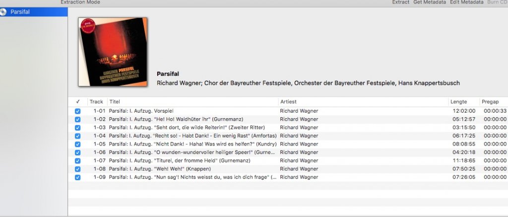

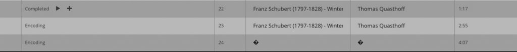

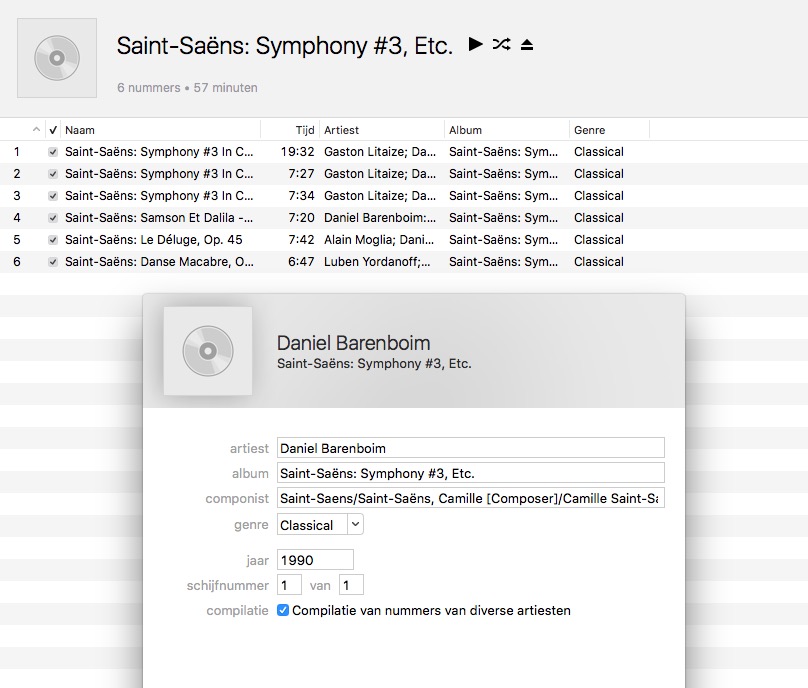

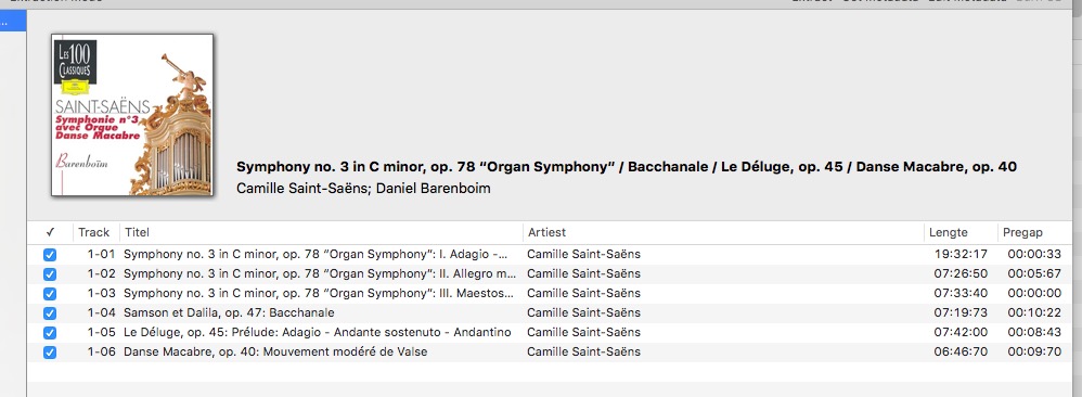

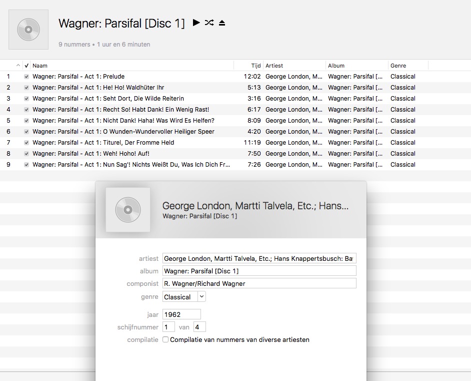

Marius
« Reply #413 on: 10 May 2016, 09:50 am »
HI,

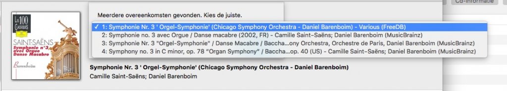

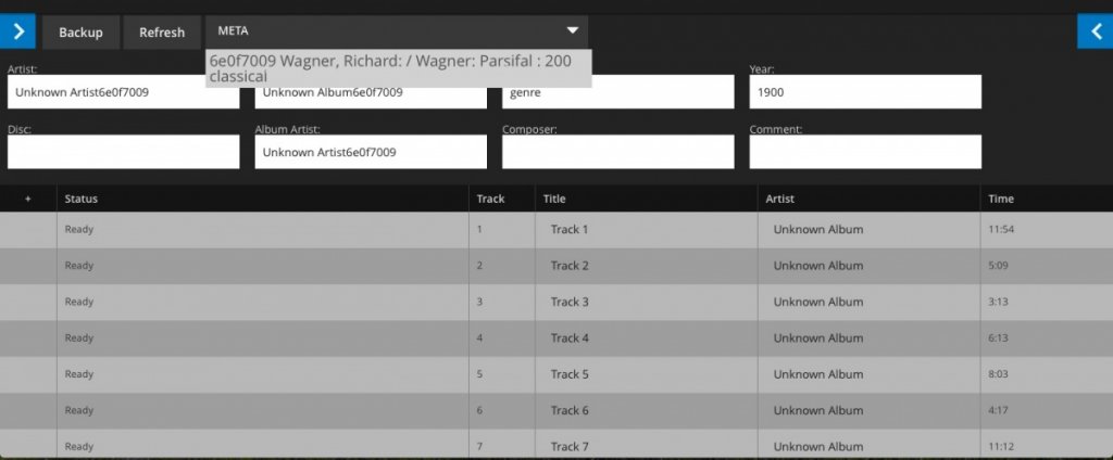

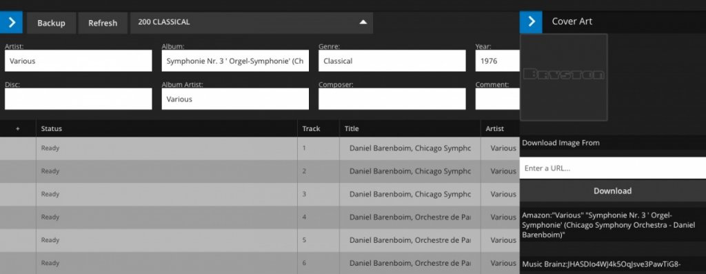

Since it is relatively quiet in this thread, i wondered if anyone actually backing up their cd's with the BOT1? Im having mixed success , especially in the classical departement (as feared though, it is notoriously under represented in the various db'ses)
MM result 1: While recognizing the cd, no tags are filled-out, nor is an imagefile found
MM result 2: Disc recognized, tags are filled out but incorrect, no image file found
iTunes result 1: disc recognized, tags filled out better, no image file
iTunes result 2:  disc recognized, tags filled out correct, no image file
XLD result 1: disc recognized, tags filled out correct, (correct!) Image file
XLD result 2:  disc recognized, tags filled out correct, (correct, again ) Image file
XLD seems to
get the Meta data better from the servers it searches, and also present the user with a bit more options, that make it easy to select the correct or at least best Tags.
Chris,
Could you comment on maybe settings i need to change, or could you change MM internal operations to find better data?
Marius

Marius
« Reply #415 on: 10 May 2016, 11:35 am »
thanks James,
I respect the BDP1 to be less capable than the BDP2. Also the 'regular' issues with classical libraries.
That's why i compared these 2 cd's on the 3 platforms. Difference between them is quite obvious.
Would expect the finding, collecting and using the correct tags to be a plain thing though, not dependent on heavier specs?
Hope Chris can shed his light. Must be possible to better the current MM results. XLD uses FreeDB, Amazon and MusicBrainz.
Marius
