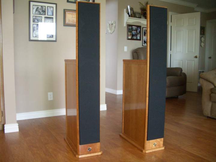

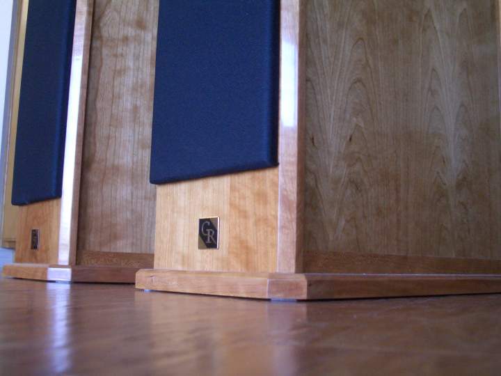

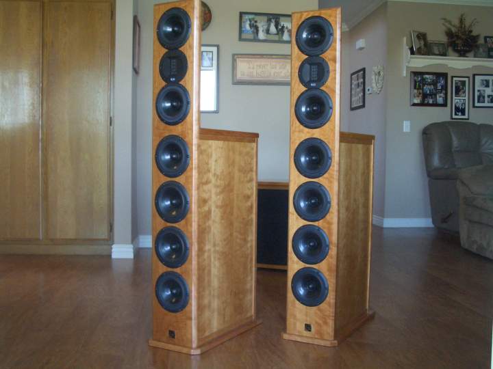

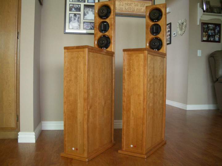

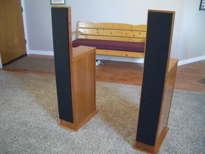

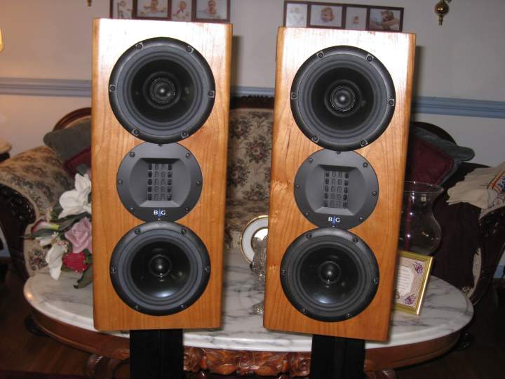

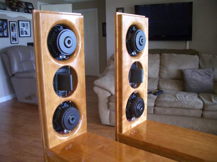

Ok I'm in, Cherry OB7"s

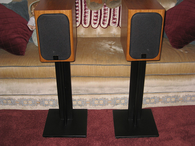

Re: GR stuff WE (Group) have built-The Picture Edition
« Reply #23 on: 15 Mar 2013, 04:05 am »

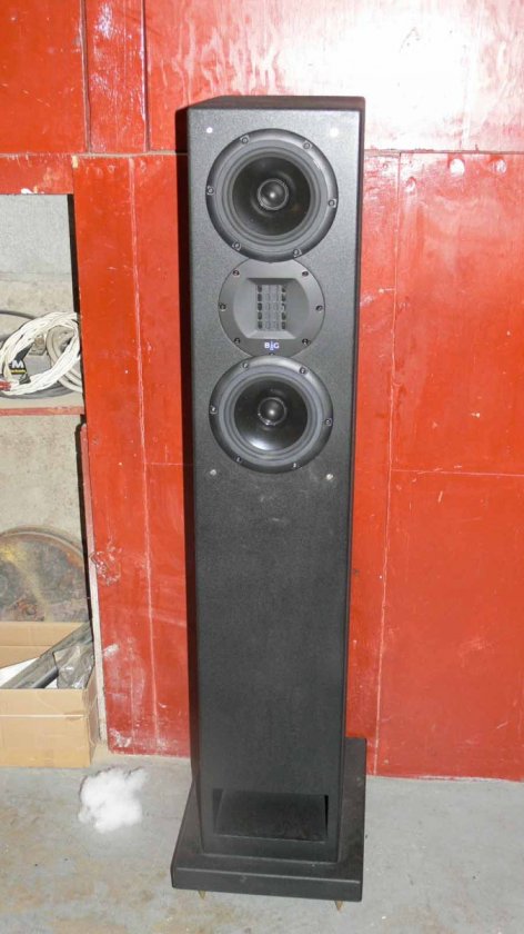

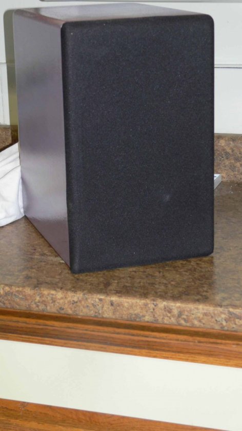

Front vented  N3's

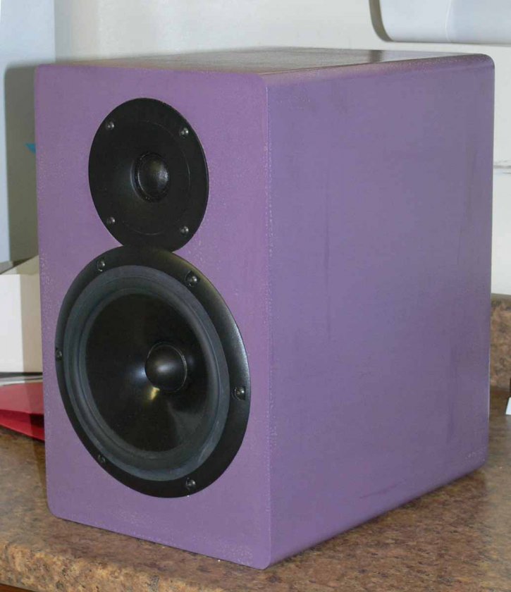

X LS Encores with large flange tweeter in purple  to match my neice's room

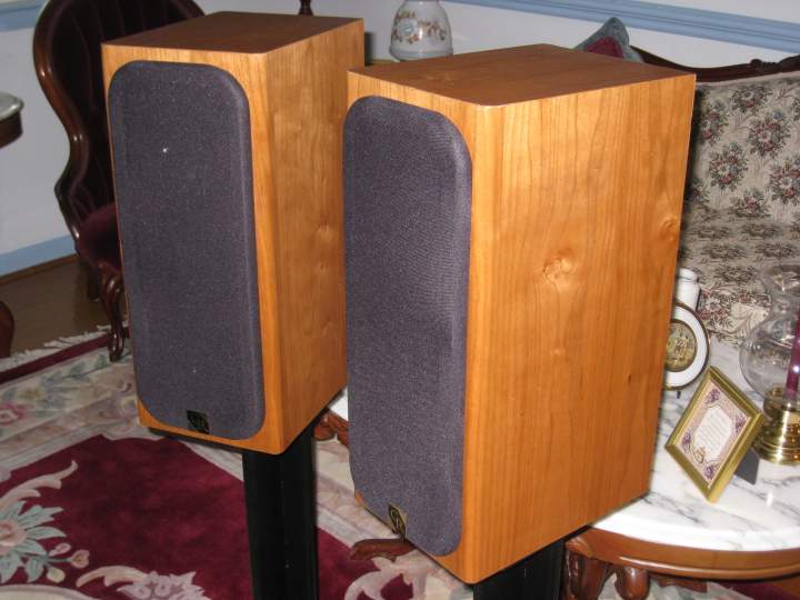

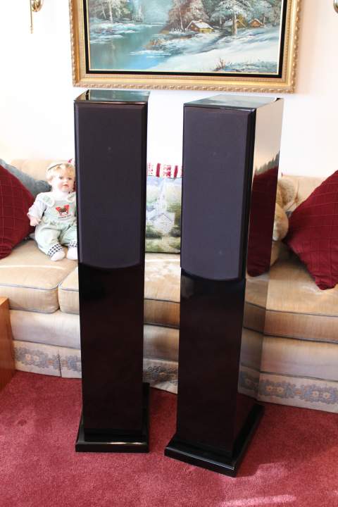

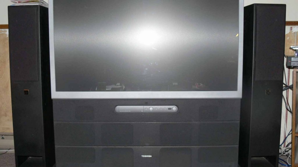

  Attached are some of the GR Research speakers I have built:
N2X
N3S
N3 TL's
AV-3 TL's
AV-1's

NeilT, your cherry OB7's are beautiful!!!  What kind of finish did you use to get that high gloss?

Neil,
 Is that solid Cheery? WOW! Cheery is one of the most beautiful woods especially when left natural. Not sure if you tinted it slightly, but it's really spectacular! The craftsmanship, wood choice, and finish are all first class!!

Thanks Guys, I used General Finishes, Arm-R-Seal, sanding between each of the several coats, 5 or 6. I then wet sanded 1000, 1500, and 2000 grit, and polished with 3m's swirl remover and a coat of wax. Very labor intensive, but very happy with the end results.
Larry,  all solid Cherry except for sides and back, I used 1/4 mdf core ply. No tint or stain, Cherry just takes on a richer, darker hue as it ages. It is my favorite wood to work with right now, just finished up a bathroom vanity that actually came out nicer than the speakers.
Thanks again for the compliments

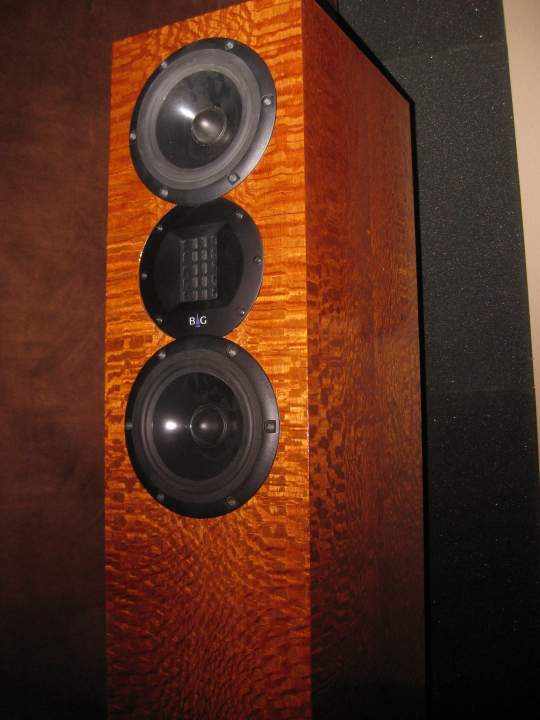

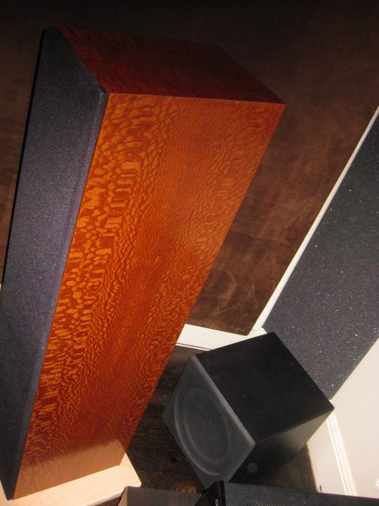

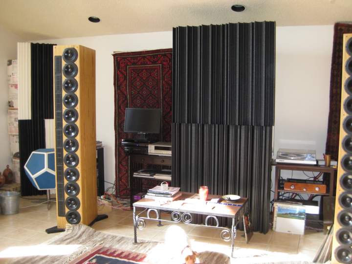

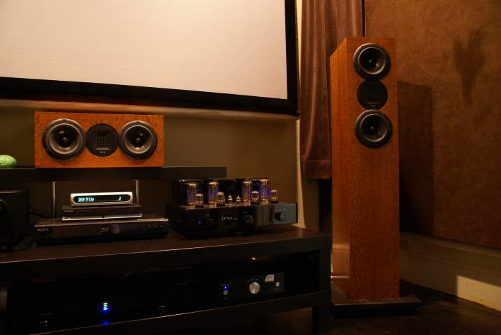

Here are mine

 Did you spray or brush the Arm-R-Seal? Also, what wax do you use?

I used Foam brushes, any car wax should work ok. I had some Meguires Carnauba laying around.

Really like the veneer.  I have never heard the N3 in tower version.  I am going to have to make some cabs one day just to hear them...

Thanks. It is Lacewood. I got it from the Formwood sale section which has great deals from time to time. The towers have really strong bass, its surprising.

the line arrays look great

The General Finishes Seal-A-Seal and Arm-R-Seal is good stuff.  Easy to apply with a lint-free disposable shop towel pad.  One coat SAC & up to 3-4 coats ARS easy-peasy and it looks great.
Larry..If you use wax on top be careful with auto products as they often contain silicone oil (polysiloxanes). Once you get silicones on a finish it's r-e-a-l-l-y hard to repair or refinish the piece as silicones will prevent new finish coats wetting the surface.  Removing silicones is also very difficult.  If you want to wax use something like Johnsons Paste Wax.  It's carnuba and polyethylene waxes, no silicones.  If you need to remove it wipe a piece down with mineral spirits, prepare the surface & recoat.
FWIW.."Lemon Pledge" smells nice, but it's made with siloxanes..bad news on good wood or wood finishes.
