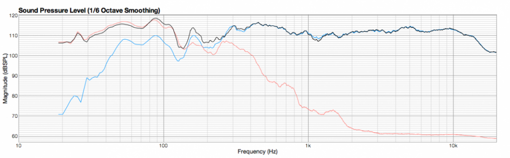

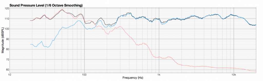

Then I want you to pull them further out into the room by about 6" at a time and take measurements each time. Then let's see if the dipped area in the 200Hz range and a little lower comes back up. I think it is a wall reflection cancellation.
WOW!
6" might as well be a mile. Needless to say, Danny was dead on. The curves are much better. And image is focused. I will post images later -- right now I am too busy listening to records.

The repositioning really helped. After listening for a couple hours last night I tweaked the volume up 3-4 notches from what is attached above. They are still not perfect, but certainly better than before and pretty decent for my room. There is still an obvious issue between 100Hz-300Hz. i am hoping a room treatment or two will help that.
Any tips on what will help bring up that dip is appreciated... home-made tube traps, maybe?
Each channel had a peak of different intensity at 50Hz and 80Hz. So I used the PEQ to reduce the 50Hz on the right side and reduce the 80Hz on the left side. Not sure if that is 'correct' but it certainly smoothed out the low end and gave a fullness that I had not yet experienced in this room.
