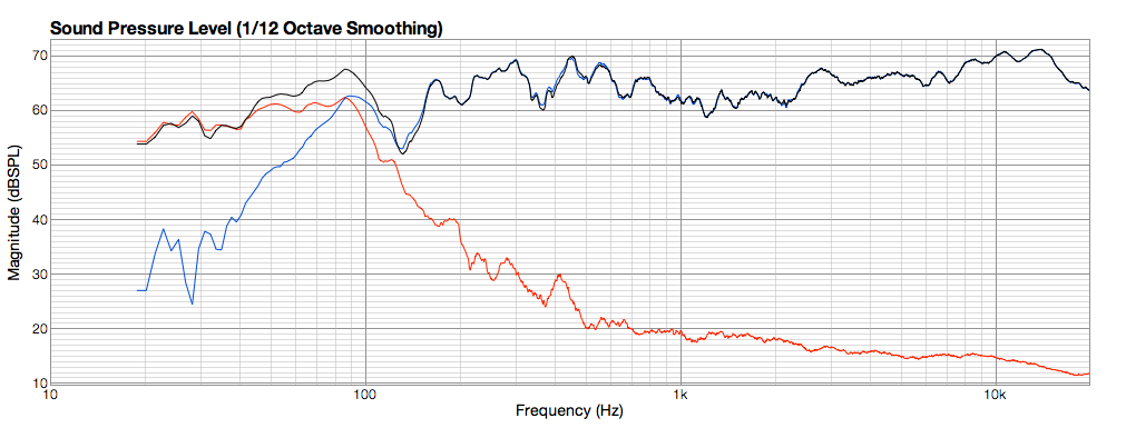

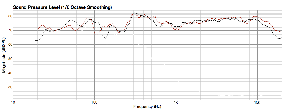

Today I got motivated and got out the gear to do some measurements. I placed my testing mic at 1m back and just below the centre of the P-Audio driver to do a series of frequency sweeps. (I am very inexperienced with this, so any tips are appreciated). After a lot of back and forth, here is the best I could get with adjustments to the Servo amps:
RED: Servo - BLUE: P-Audio - BLACK: combined
Servo Settings:

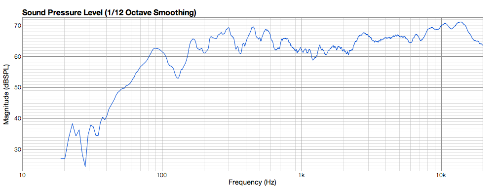

BLUE: P-Audio
There seems to be either a large peak at 90Hz or a dip at 140Hz on the P-Audio.
Either way, integrating the Servo has been very difficult. I have so far settled on a low CrossOver point (50Hz). Any higher and the Servos combine with the 90Hz peak and go through the roof.
I can really use a little help smoothing this out. And getting more out of the sharp roll off at 45Hz. Thanks again.

Have you try and move the speaker a little around,,and then measure again ?
try to measure where you normally sit and listening ..
it looks like that you have high output from 1khz down to 200hz---i think it can make voices to sound thin in top ,and mumble a bit in the low
the dip around 140hz comes maybe from the back off the speaker,,,blend with the front..but this will change if you move the speaker around-

You do know that to tweak these you have to measure each speaker independently. If you measure them both at the same time then one will cancel out the other or cause a peak in the response and you wind up chasing something that isn't really there. Show us one speaker at a time.

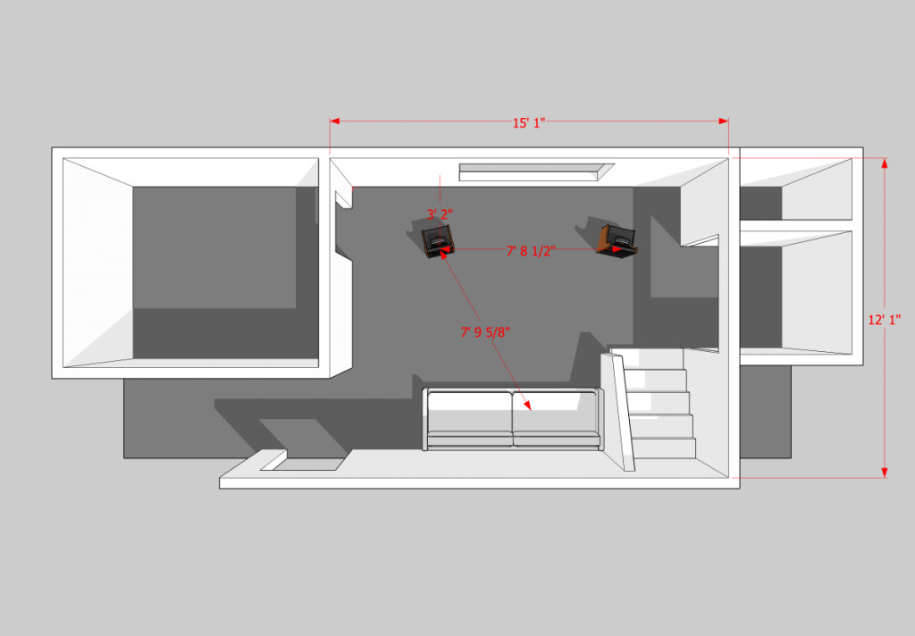

Thanks guys. I will get some room drawings re test the set up at listening position, one side at a time.

Here is some basic room info. As you can see i'm not able to move the speakers too much. I do slide the sofa out 6"-12" from time to time.

Is that a window on the wall behind the speakers? Is there anything covering it? (drapes, blinds) Some diffraction in there would be nice.
SteveRB
Re: Setting Up My V1s
« Reply #9 on: 4 Mar 2013, 02:16 am »
It's a window with thick blinds. We cl just moved in and curtains are in the future. Also, the small room to the left has a door and can be closed for tests and listening.
There is also a low credenza under the window, where the amps and record player sit.
Drawing details are still advancing...

That bump you have at 45 Hz is a function of your room size, mine has the same thing.  You can tame that some with the EQ section of the servo amps.  I think it will help if you can put some absorption on the wall behind you and that stair well wall to your right.

I'm mosly concerned about the bump at 90Hz. I'm thinking I can EQ that out while stretching the crossover up to cover the dip at 105Hz.

Get some individual left speaker and right speaker measurements and post the upper and lower section responses individually just like you did above. From there we can start tweaking.
SteveRB

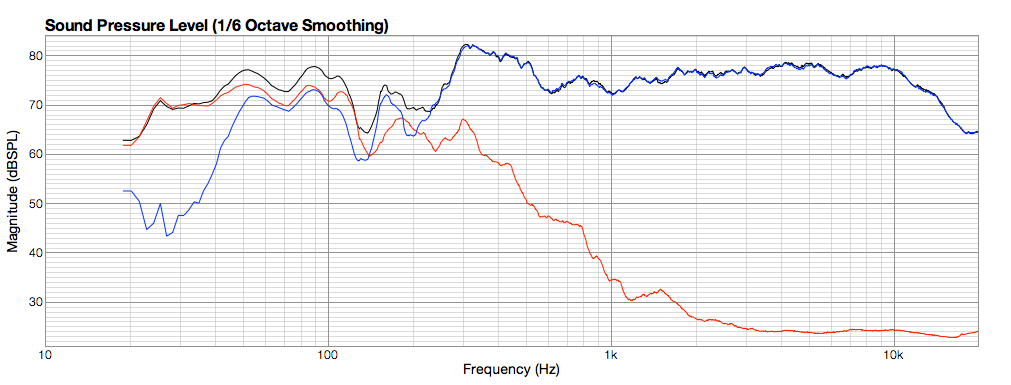

« Reply #15 on: 5 Mar 2013, 06:29 pm »
LEFT CHANNEL:

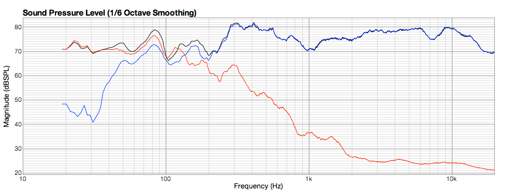

« Reply #16 on: 5 Mar 2013, 06:30 pm »
RIGHT CHANNEL:

Danny Richie

And how far are they from the wall that is behind them?
SteveRB
« Reply #19 on: 5 Mar 2013, 08:10 pm »
3'2" to the front baffle.
