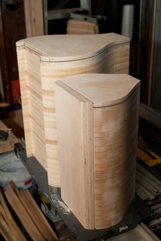

First came the Cirrus, and for over a year I kept looking at the pieces left over from the CNC thinking there has to be something I can make of those.  So when a customer came along wanting something built to the same level as a Cirrus but with a smaller footprint, I re-drew the Cirrus CAD file to have a cabinet in a cabinet.  Those pieces from inside the Cirrus cutouts looked to be just the answer, and a quick 3D render showed that when stacked 14" high, they would yield .3 cu/ft ... which was perfect for a sealed monitor using the 6" AudioTechnology woofer.
In this image, you can see how the smaller Sundog shape would fit inside a Cirrus.
Like the Cirrus, the Sundog has a stacked ply construction, constrained layer top, and a deep roundover on the front edges.  Instead of the baffle being a separate piece mounted to the cabinet, the Sundog has a permanently attached 1" thick Baltic Ply baffle.  Drivers are also very Cirrus-esque, a custom AudioTechnology 15H woofer and the RAAL 70-20XR.

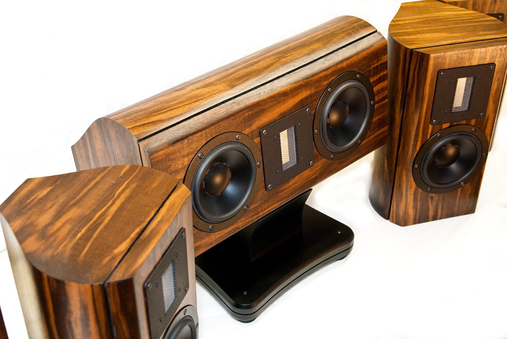

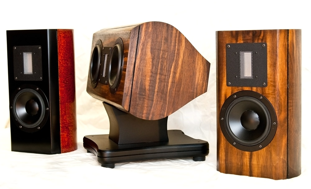

When we designed the Joule cabinet, which is a Cirrus upscaled 25%, we also Sundog shapes integrated into the interior.  These larger Sundog pieces when stacked would give us a hair over .4 cu/ft, perfect for a ported version.  Also these larger pieces would make for ideal volume when using a pair of woofers sealed in an 18" cabinet, which is what we use for the Center Channel.
Here's a couple pictures showing Sundog mains in the smaller sealed cabinets, and the Center Channel in the larger diameter cutouts.
We're very happy with the results!  We managed to make a wonderful sounding small monitor that is versatile enough for any setup.  These can even work on just about any built in bookshelf due to their shallow depth, and the sealed option.  When moved out from the walls they throw a huge, room filling and layered soundstage.  And they go a long way to giving you the same level of refinement and resolution as the Cirrus.  Pair them with a capable sub or subs, and you'll have a world class result that performs far above it's pricepoint.

Oh, and btw, the red Sapele pair with the black painted baffle is available for immediate sale.  And we have 3 pair of Sundog cabinets assembled and ready to veneer for your custom build.  No long delivery times!
