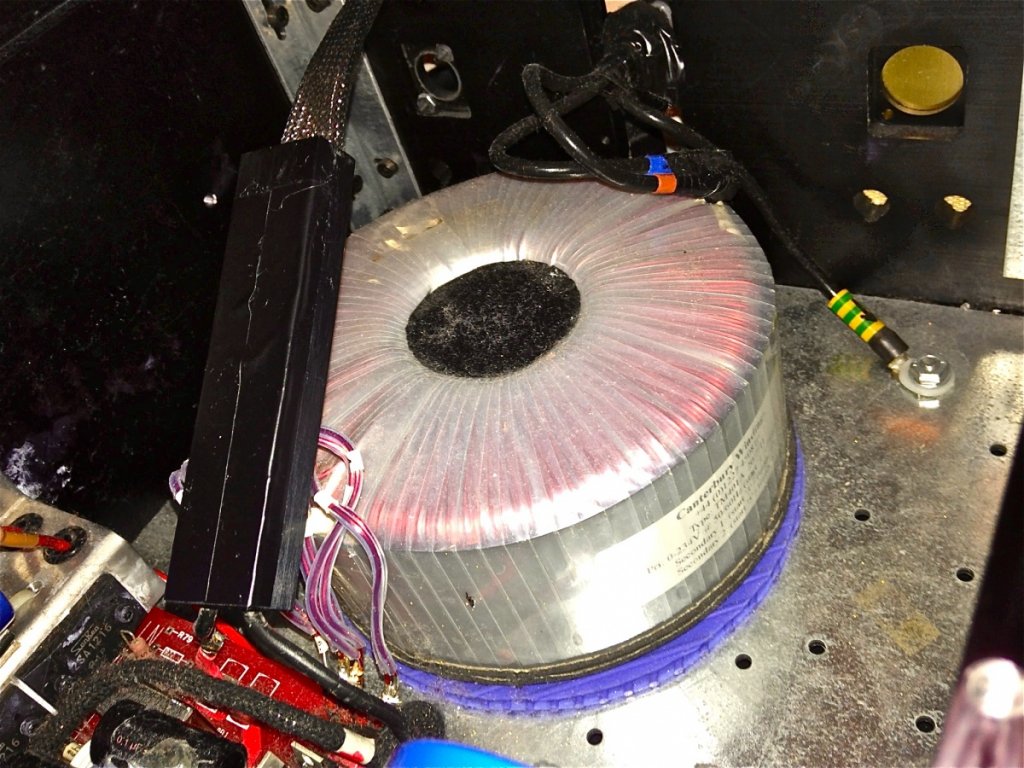

The Torroidal transformer wound 'entirely' with approx 100 Meters of WWW.ANTICABLES.COM speaker wire...

100% pure cotton sleeving on the Mundorf Capacitor jumper wires. They are actually black shoelaces.

If I may ask, who wound the custom toroid and chokes?
Ron
OSIB16
  • Posts: 390
Re: FRANKENSTRATOS - My Finished Amplifiers
« Reply #37 on: 31 Jan 2013, 10:29 pm »
Canterbury Windings here in the UK made/wound the transformers for me (exact replica of a Plitron), I just handed them a 350 METER spool of Anti-Cable speaker wire and they did the rest. The UPOCC copper inductors were wound especially for me by Mike at Odyssey Audio, these were a bit of a nightmare for me because I had to strip the PVC sleeving off a 5 meter length of it, then replace it with a thin sleeve of polyolefin heatshrink wrap.

Wolfman
  • Posts: 103
« Reply #38 on: 1 Feb 2013, 01:21 am »
OSIB16-Very nice looking amps,there's a ton of interesting things inside of those. I wasn't sure if Klaus/Odyssey would consider them to still be "in the family" so to speak,but if Mike did your Tranny winding I assume they are.
Even the basic Stratos amp contains a ton of hand labor,there's no shortcuts inside of them,and these have at least another ton of hand labor on top with almost every inch of space filled. I hope they're as reliable as "normal" Odysseys,I'd hate to be the one that had to unravel/service them........  :o
I find it very interesting as well that you seemed to stay relatively close to the basic design(as least as far as a non-techie like me can see),did you mention the power ratings/gain? I would've thought with power hungry Planers,you might've upped the trannies size,but apparently not,hmmm....
Since you like Class A,did you up the bias and do they run much warmer than the lukewarm Stratos?
Finally,I like how he mounted the trannies,what's the Purple material directly underneath them?
I would really like to hear them some day,but probably never will,good luck with them and enjoy!  :thumb:

« Reply #39 on: 1 Feb 2013, 07:09 am »
Thanks, I believe the new SINGLE custom transformer is 800 to 900VA rated so it's the equivalent of the 2 'combined' Plitron transformers (one stacked on top of the other) that Klaus provides in the EXTREME edition of this amp. The material underneath are two layers of flameproof SILICONE pads which also act as a kind of vibration cushion due to their slightly rubbery quality. Using an even larger torroidal transformer will just slow down the TIMING and RHYTHM of the music. The downside to stacking '2' transformers- one on top of each other is that you get an interference between the 2 magnetic cores. My amps run significantly hotter than the originals, that's what the mesh covers are for. Also I need to get them rebiased.
