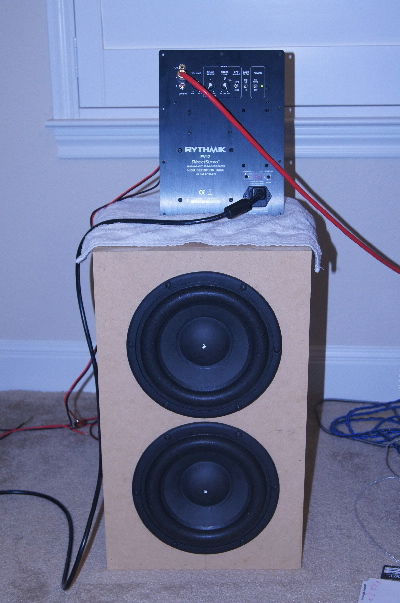

Here is a photo of what I have for my prototype. It is 12" wide, 20" high, and 14" deep. The white dots on the dust cover are my markers, not something you will see from production units. With two 8" driver, its output is very comparable (albeit a bit less) to a typical DS1200 or SW12-04 driver.

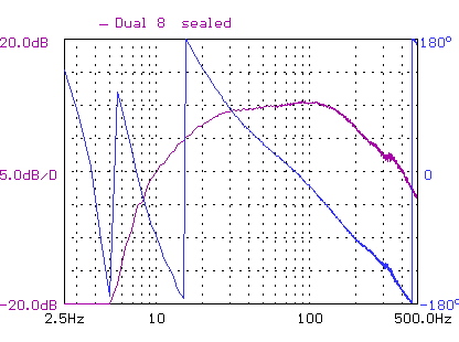

This is the close-mic frequency response of prototype. The final production will be a bit different. This should give you some idea of the frequency response.  Note that this is close-mic, if one consider baffle loss in real application, the upper will be slightly emphasized and that makes the upper end extension a bit higher than this plot.  Objective of these 8" subs to simplify crossover design. I have seen some advocating MBM. In my view, MBM just adds crossover complexity. If we can have enough number of these smaller driver, at the same time, provide sufficient low end extension, it should be a better alternative.

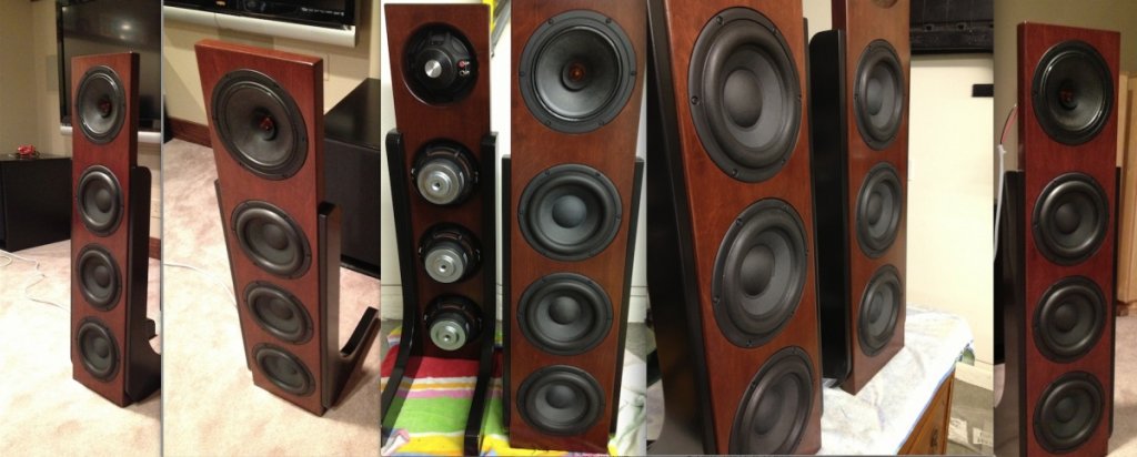

Here are the images of the 8" in an OB application.  Danny and Brian did a nice job on these.  I had to use the 370 amp at the time, the others were not in yet.
That looks like a 1.4 cu. ft. box for 2 x 8" drivers. I thought Danny said the 8" driver only needed 0.35 cu/ ft per driver?
The Vas of the driver is 25liters. So larger enclosure can see more output at 10hz (about 3/4" peak to peak excursion).  If you don't need output at 10hz, you can settle with smaller enclosure size. Our extension filter switch now has 3 settings: 1) Low/music, 2) Low/HT, and 3) high. At low/music, it is a simple 2nd order extension filter at around 18hz with Bessel alignment which mimics a typical sealed sub roll-off.  For Low/HT, a 3rd order rumble filter is added.  For High extension, we use a 3rd order filter at 28hz.  If the customers use a smaller enclosure, we will recommend either 2) or 3) setting.
Just to be clear, our design objective is try to extend the low end as much as possible so the customers can hear what a "fuller spectrum reproduction" can bring us.  If we want to do that, we need to also be able to produce SPL at a reason level, and hence the enclosure size consideration.  I am very happy with the proto-type. I play "Peom of Chinese Drums". I can almost feel the vibration of the drum skin. It sounds very open/transparent/effortless. When you put the driver into a enclosure too small, it will begin to sound compressed. For these 8", I really haven't tried when that will happen. As more clients/customers try them out, we will get a better picture of the best trade-off.
Just to be clear - you mean 2 x HX580 (4 total amplifiers) with each amp driving a 4 ohm 8" speaker? and how much cu ft per driver?
Thanks
Hope the above explains the trade-off of using large vs smaller enclosure volume. This weekend, I will put in a wood block into the enclosure to reduce the volume and see how it affects the low end output. My experience is at 20% variation is not going to cause the world to collaps, so 0.7*0.8=0.56 is probably also ok. Anything smaller should wait till our further investigation.
