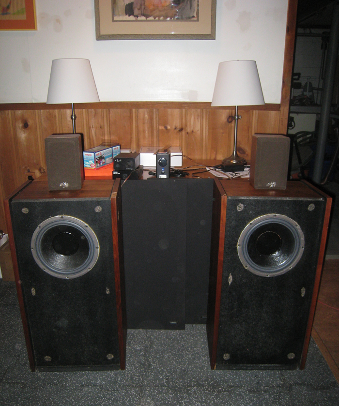

My little Virtue One is working again! I had a few hours of delight yesterday after I finished refoaming some giant Satterberg woofers, and hooked up those with some modded Minimus 7s, my little Virtue One, and a tiny iPod. I had thought the amp was dead to the world but it turns out had only blown a fuse. This ungainly collection of audio objects just sounded insanely good. I have a 16 year-old son who actually asked me to turn it down-- and I was playing music he liked. I don't usually listen loud but I couldn't help it yesterday.

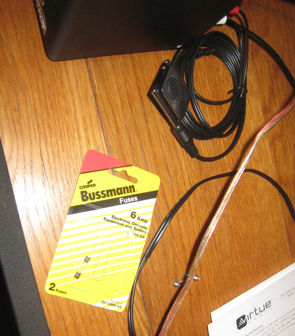

Anyway with the dozens of projects that were more pressing it took me until recently to investigate further. I was afraid I'd fried the switch and would need to ship it out for repair. I didn't want to spend a lot of money on a fun but not really necessary second amp. I read pages 12 and 13 of the oldest topics here and settled on trying the fuse first.
Which worked, but leaves me some questions. Here is the closest I could find to the "right" fuse at Home Depot:
One: From an early post by Michael Mardis it seems the best to use for a battery-powered One is a 5A, slow-blow type; somebody asked about 7A which he said would work but give little less protection. I have a 6A fast blow type fuse (closest thing Home Depot had). Obviously, it works, though I'm using the standard supply. Before I dig up the battery supply, am I good to go with the 6A fuse? Or should I instead go to Ratshack and get a 5A "slow blow" fuse? If it makes little difference I'd rather stick with what I did, just to make life easier.
Two: I missed the boat on the shrink-wrapped free soft starts, but as I kept reading early posts it seems they didn't always work as intended. Then there were suggestions on adding a cap, but those were for the first-shipped One.2 amp internal soft-starts. Before I hook up the batts, what is the current state of thinking on all this? Get an external soft-start from Jason, if they still exist? Not sure what that'd cost, but I have bought some nicely made cables from him in the past. Or, am I good with either a 6A fast-blow fuse, or a 5A slow-blow fuse I might be able to track down?

That external soft-start didn't work and the one we put inside the ONE.2, had a capacitor that was too small -- I thought.  In fact, the unmodified soft-start was fine to protect the switch (we didn't lose one).
Please do not hook up a battery to an original ONE.  Those units are now out of warranty, we have none in stock and no economical way to fix them.
I try to take care of all customer issues personally but it would be a real PIA if ONEs started blowing up around the world.

the 6amp fuse is fine.

The battery supply blew a fuse on the One. So no worries, I'm done with that. (I still use a battery supply with the Sensation but that amp is designed to use one and has never had problems with it.)
My impression from the threads was the battery supply was more risky than the 30V/ 130W switching supply. Something about an inrush of current on turn-on, which the first Virtues were not designed to handle.

Yup, the original ONE had no soft-start.  In truth, we were shooting for a lower price point and only after Roger insisted on my hearing it with the 30/130w did it become apparent that we really needed one!  Those were the days!  What a mess!!!
The ONE.2 soft-start was too fast but apparently slow enough so that even if you didn't upgrade the cap the switch never failed.  You won't get fuses blowing nearly as much with the ONE.2.
