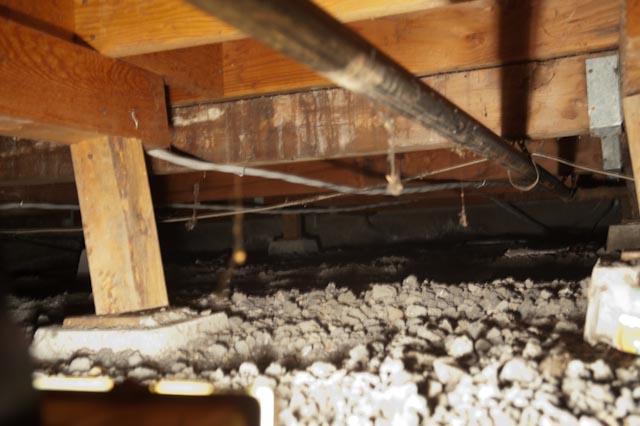

I had my V's spiked to the floor. But after all the moving around I've done to these speakers I broke and bent a few. My audio buddy purchased some  of those Herbies gliders. Now whether you believe they couple or decouple, (decouple is what I believe they are supposed to do) they have altered the sound of the speakers. They simply sound smoother but don't seem to sacrifice high frequency energy.
My floor floats. There are no piers under the living room. None. There are hardly any piers under the entire house  :o and the few that are there are tilted. It's criminal how they rebuilt this house  :evil:
It's an audio upgrade I tell ya, waiting to happen. And since I live on the San Andreas fault - I BETTER HURRY!

Wow Michael, that is SCARY! You're in California too (I'm in the Southern quarter), where the standards in the carpentry trade have dropped drastically in the past few decades. Call Holmes on Homes!
